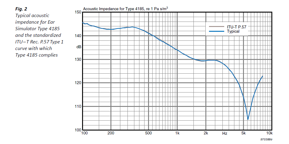

might there be a practical way to roughly estimate a headphone's potential LF as an average of infinite and finite conditions?
Hi Fred,
I would be surprised if there is, but as this is way outside my area of "expertise", I don't really know 🙂.
The attached chart shows the acoustical impedance of the human ear under sealed conditions, as used in the Brüel & Kjær Ear Simulator for Telephonometry Type 4185. This gives a completely different result to that obtained assuming an infinite cylinder for the ear canal.
Kind regards,
David
