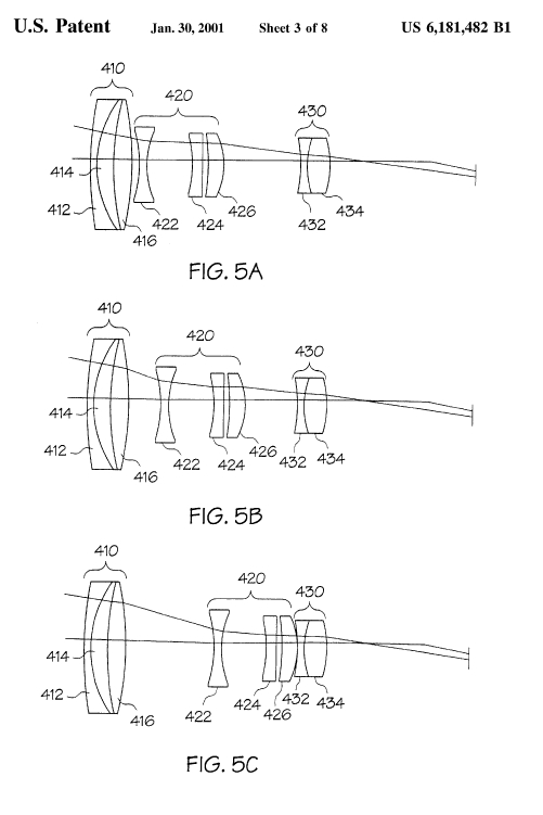

Your idea is actually a patent, you can go to US patent website to get the detail design. The patent number is 6,181,482, the date of the patent is Jan 30 2001. I have not seen any product for home theater equipment. Maybe they use this variable ratio anamorphic lens in professional and commercial products.
one of the drawing is attached

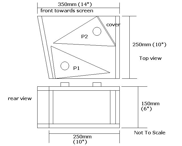

The key difference I made to mine was to create a horizontal expansion lens, not vertical compression lens. This is simply a case of laying the prisms of their sides. see attached diagram.
My prisms are made from 6mm Perspex. I made 2 jigs out of 16mm MDF and took them to a plastics engineering shop. He simply heated the Perspex with a strip heater at the bends to keep the main body flat. Each prism is made of just five parts, top and bottom, the main body (one piece) and the expansion chamber and threaded bung. He glued it all together for me using a special product that fuses the plastic together and they don't leak because he tapped a hole in the top of each expansion chamber for the plastic bung to screw into. It is made of some form of poly.
Now as stated here, "the bigger the better" and this is true, especially with short throw devices like my native 16:9 Sony HS-3.
My prisms are huge, and in the case, the lens is as big as the projector itself.
As I said, I read the other pages and did seek out glycerin. At present I am still using water, and it doesn't appear to be adding anything that might suggest color change due to having the same type of fluid in both with the same index.
There are some key points to aligning the prisms though.
What I have found is that the two prisms actually interact, where P1 is will expand the left side, will also compress the right (to a lesser degree) and the same goes for P2.
If the prisms are not positioned exactly right a couple of thing happens -
1. image not stretched enough
2. too much stretch. This also causes a patch of reflection in the centre that creates a visible spectrum, so the key is to stretch, but to the point where the spectrum is not visible.
3. horizontal panning if the lens may be needed to ensure symmetrical stretch.
4. tilt factor. This has a variety of effects including image clip, and a blue line (reflection from the prisms themselves?) and must be adjusted for.
5. The lens might also need to be slid from side to side. When the light passes to close to a bend, color abrasion will occur.
This attachment is of my lens in plan.
