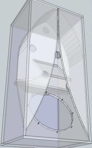

here's my long-distance friend's work so far on a little test coupler for FE206E (front mount) and W8-1772 (rear mount) - its about the size of that old coupler that starts this thread - there's a partial shelf which will allow building up a front deflection shelf and a rear lowpass choke
Karlson-expert Carl Neuser suggested examining the following apertures besides radial arc and there's quite a difference in overall aperture area 83.6 square inches vs 131.9 square inches.
Gap Slope p q Area Length Wmax
0.25 1.5 3 12 83.6 18.5 12
x w
0.00 0.50
1.00 0.50
2.00 0.52
3.00 0.55
4.00 0.62
5.00 0.74
6.00 0.92
7.00 1.16
8.00 1.49
9.00 1.91
10.00 2.43
11.00 3.07
12.00 3.84
13.00 4.74
14.00 5.78
15.00 6.97
16.00 8.29
17.00 9.73
18.00 11.24
18.50 12.00

May be going the wrong way, making short circuit path even shorter.
Driver gapped on baffle would be the worst possible case.
Hopefully your experiment should give the evidence. One solution may
be a rear shelf that extends fully to brace the back, gaps relocated
toward the sides instead. Same Hemholtz tuning per each chamber I
would hope, but leakaround for lowest frequencies takes longer detour.

Fig 6 is half baked. JEK had almost the right idea, but failed to realize
how Fig6 focus's to a horizontal stripe. Koupler exit slot is vertical...
Horizontal high order modes do collide and reinforce toward the center,
so the idea isn't completely wack, but you ain't getting away from dips
and peaks in the response if horizontal mode is between parallel walls.
Fig 666 (Crosley, cucoo clock, or dome shape?) address these concerns.
No parallel walls across the 2 widest modes, and focus to vertical stripe.
And then there is additional question of how Koupler should optimally
interact with front shelvage? And how the right front shelvage might
further detour the evil acoustic short circuit...

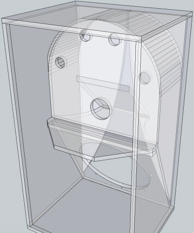

I have been toying with a modified / utterly misunderstood Karlson arrangement. Probably modified right out of that category, but what the heck.
Two Tang Band 8 inch woofers, Xmax of 12 mm, sensitivity of 84 db and full specs below in an attachment, mounted into a 90 degree chamber, tilted 45 degrees with a large Karlson slot to load them with. A fairly deep, 24 inch, open backed box, with an unknown and to be discovered amount of chopped cotton house wall batting hung at appropriate intervals. This follows John K's notion of a cardioid radiation pattern with the slight twist of another Karlson slot at the back. My initial reason for using these profiles was to provide a wider impedance load into the room, in an attempt to quell resonance nodes.
This lash up to be driven by class D amps and sharply rolled off above 100 Hz. A Berringer DCX 2496 with Jan Didden's board will be the crossover, so I will have a large playground in DSP to alter the FR and phase in.
The mid bass is an Eminence Delta 8, with a 200 watt power limit and 96 db efficiency, for 80 to 300 Hz and then a nude Lowther above this.
My question is simple, can anyone give me a thumb style notion, other than in my eye please, of where I will have to work on to get this to provide reasonable bass to 30Hz and max spl in the 103 db realm? Not asking for a detailed analysis, just off the cuff responses, going with a "first thought, best thought" attitude.
A pic below will give an idea of how far I have gotten. And any help, and negative comments, will be appreciated.

Equidistant path up both sides of this front shelf.
Non-equidistant path up the middle is blocked.
Crude phase plug, but any improvement over the
regular shelf is still an improvement...
After that, its about getting echoes out the slot
in as few passes as possible. I'm playing to avoid
resonant modes that might favor one frequency
over another, or don't have quick n' obvious exit
strategy.

OK, if you really want to get that low with any authority using woofers with specs like that, IMO and IME your best bet is to put them in ML-TL type enclosures. Totally doable. Lose the Karlson bass scheme entirely. I don't see any benefit in this application.
For the upper bass / mids, I spose you might try a dipole Karlson type arrangement. See below. I originally thought of doing this as a variant of the H baffle dipole sub, in hopes of getting some 'free' excursion limitation. (to be verified... 😉 ) It would require a large driver to do this effectively, as do ordinary H baffles. But it may have some subjective benefits in you desired BW.

Details on Dave Young’s KLFE 1815
The 23" square baffle is inset 1" from the front and sits in a
20 degree angled slot cut by tilting a 3/4" wide dado blade on a table or radial arm saw. The sides have 1/4" deep routed slots to accept the baffle and top panel. The top panel is at 145 degrees
to the baffle and contains the port. The length is determined by
measuring the distance left over after the baffle is fitted and the top dado cut. The top slot is cut using a tilted dado blade.
The length will be between 11 and 12". Both the speaker hole and port are centered on their panels. I used a 6" ducted port on one pair and square holes on the rest. The coupler panels fit
into a 1/4" deep by 3/8" wide dado cut into the sides and top.
They are also braced to the baffle. The first batch had a
45 degree kick plate at the rear for casters and input jacks.
This way the back could be removed without having wires in the
way and it was possible to back the cabinet against a wall
without damaging the cables or connectors. The exterior is
36" high x 24" wide x 23 15/16" deep. The slot was calculated
from Poppe's formula with a modification by the guy who cut a
sheet metal template for me. I never tried a radial coupler on
the KLFE-1815. With the exponential opening, the slot is narrower
at the top. The gap at the top of the slot is 1/2".
Here are the Template dimentions.
0"-11 5/8" 12 3/8"-11" 24 3/8"-8 5/16"
1 3/8"-11 5/8" 13 3/8"-10 13/16" 25 3/8"-7 7/8"
2 3/8"-11 9/16" 14 3/8"-10 11/16" 26 3/8"-7 3/8"
3 3/8"-11 9/16" 15 3/8"-10 9/16" 27 3/8"-6 7/8"
4 3/8"-11 1/2" 16 3/8"-10 3/8" 28 3/8"-6 1/4"
5 3/8"-11 7/16" 17 3/8"-10 1/4" 29 3/8"-5 5/8"
6 3/8"-11 3/8" 18 3/8"-10" 30 3/8"-4 7/8"
7 3/8"-11 5/16" 19 3/8"-9 13/16" 31 3/8"-4 1/16"
8 3/8"-11 1/4" 20 3/8"-9 9/16" {32 3/8"-3" }
9 3/8"-11 3/16" 21 3/8"-9 5/16" {33 3/8"-2 1/8"}
10 3/8"-11 1/8" 22 3/8"-9" {34 3/8"-1" }
11 3/8"-11 1/16" 23 3/8"-8 11/16" {34 7/8"-3/8" }
{from here curve}
{was cut to fit}
Dave
The Peavey 1504-4 produced 16.5% 2nd Harmonic Distortion at
40 hz,100 watts in the FH-1 and 5% in the Karlson Low Frequency
Enclosure 18"15" (KLFE-1815). With a 65 hz tone, the FH-1 was
5.5% 2nd and 16% 3rd. The KLFE-1815 produced 5.5% 2nd and
1.7% 3rd. The FH-1 is flat to 130 hz with a 12db/oct. rolloff.
The KLFE was at the same output level from 70-80 hz with 40 hz
being 8 db higher. Above 80 hz, the FH-1 was the winner. The
KLFE's first dip is at 230 hz.
I have never tried a 1505 in a Karlson.
