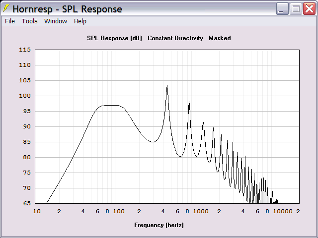

how large does a Karlson need to be to get semblance of a bass drum?

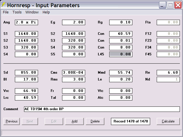

GM, that's a Karlson modeled in HornResp??
Or?
Yes and no, as I noted, it's a 4th order band-pass alignment (BP = type 1 in LspCad), i.e. it encompasses only the basic front and rear coupling chambers of a K-15 or a basic Klam alignment that I use as a guideline to decide if the driver's specs are suitable for a K-15 and/or Klam loading concept.
GM
Karlson is probably a distributed circuit problem, not
easily broken down to manageable number of lumped elements.
OK, it's my understanding that AkAbak can model all but the odd shaped vent as a series of expanding/contracting shaped ducts; so if you're right, a K-15 can be ~accurately simmed except with a vent of the same area/thickness, so load a known driver's specs that Freddy has a measured response of to see how close it is. If the sim is fundamentally different between its two half space (2pi) F6 points, then the slot is affecting the front chamber's loading more than I'm currently giving it credit for.
GM

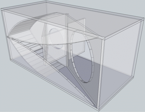

two vents will be examined - one being the horizontal slot vent which hopefully is tuned high enough to allow tuning lower, then that vent will be plugged and the driver gapped from the baffle to form the other vent under investigation.
May be going the wrong way, making short circuit path even shorter.
Driver gapped on baffle would be the worst possible case.
Hopefully your experiment should give the evidence. One solution may
be a rear shelf that extends fully to brace the back, gaps relocated
toward the sides instead. Same Hemholtz tuning per each chamber I
would hope, but leakaround for lowest frequencies takes longer detour.
that possibility certainly exists - that vent position seems to work/sound alright in JEK's "Karlsonette" (1st commercial Karlson 12 enclosure of fall 1954) fwiw Carl likes the basket gapped from the baffle vent method sound. One thing I would think would be helpful on making new couplers would be a cheap test-mule with radial arc wings, then a hinged baffle which would lock down at any needed angle with two wing nuts - that along with movable upper baffle might facilitate finding angles which avoid a large first dip using RTA sweeps or pink-noise while watching a monitor.
I'm not fully convinced to the value of Fig6 reflector versus its difficulty and time to make - it needs some builds and testing/comparisons. One 32" tall coupler I had made good graphs with a fully perpendicular board.
maybe its good to keep the K15 port position and arrangement alive while exploring smaller couplers - just leave off the front shelf for starters as too much front shelf may set up another chamber. Your rear lowpass shelf and side gaps should be examined and compared with music tracks.
Fig 6 is half baked. JEK had almost the right idea, but failed to realize
how Fig6 focus's to a horizontal stripe. Koupler exit slot is vertical...
Horizontal high order modes do collide and reinforce toward the center,
so the idea isn't completely wack, but you ain't getting away from dips
and peaks in the response if horizontal mode is between parallel walls.
Fig 666 (Crosley, cucoo clock, or dome shape?) address these concerns.
No parallel walls across the 2 widest modes, and focus to vertical stripe.
And then there is additional question of how Koupler should optimally
interact with front shelvage? And how the right front shelvage might
further detour the evil acoustic short circuit...

Equidistant path up both sides of this front shelf.
Non-equidistant path up the middle is blocked.
Crude phase plug, but any improvement over the
regular shelf is still an improvement...
After that, its about getting echoes out the slot
in as few passes as possible. I'm playing to avoid
resonant modes that might favor one frequency
over another, or don't have quick n' obvious exit
strategy.
