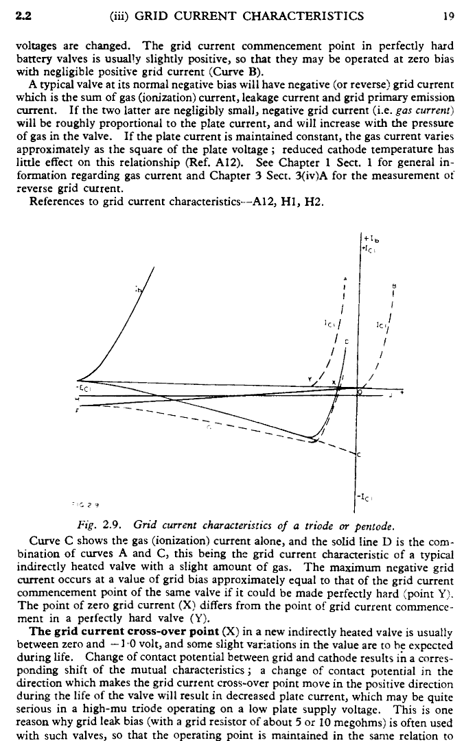

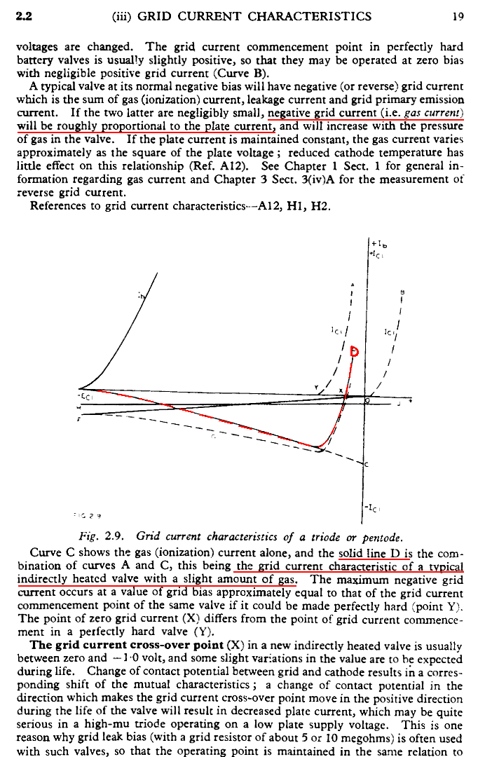

Amplifying all the above:
Grid current is normally much smaller than any other current in an amplifier. Therefore we can use a "large" resistor, which does not load-down most sources, and still have the grid voltage "zero" for practical purpose.
Grid current is rarely given in data. And I disagree we can casually measure it and get a full picture. It varies a LOT with operating point. It varies between different tubes, batches, brands, and vintages. It will normally be "high" when you take it out of the box and decline over a few days of hot operation. Most meters will leak as much as a grid.
But for a small triode at small plate current, pencil '50 nA'. Put that in 1Meg, we have 50mV or 0.050V. What is the grid-cathode voltage needed for normal operation? Often 1V or 2V. A 0.050V uncertainty on a 1-2V bias is not important.
See Radiotron Designer's Handbook, 4th Edition, section 2.2 (snip attached).
Also notice that the plate resistor has a major effect on operating bias. If the tube tends to suck more, plate voltage drops, it sucks less. Same if you have a cathode resistor.
OK, go up from 1Meg. 10Meg seems to give 0.5V of grid voltage. This is a useful bias and operating point for *small* signals. It gives nearly maximum gain. It is fairly stable because if plate-cathode current increases, grid-bump current increases, grid goes more negative, plate-cathode current decreases. All fairly sensitive to grid treatment and gas content, so the operarting point is not well-defined, but with proper choice of RP is is real sure to work for small signals. And it maximizes input impedance. (However the dynamic impedance may be half of the obvious 10Meg due to grid current acting as a parallel resistance.) And it avoids using a cathode bypass cap which was a real trouble-spot in older electrolytics.
All the above is for small triodes at small currents. And note that typical circuits with hundreds of volts and hundred-K plate resistors can't "burn up" even if the grid goes way positive. If the tube hogs current, large RP drops plate voltage, maximum current is easily figured and rarely dangerous.
When you have a BIG HOT tube, especially with a transformer (low DCR), it is possible for grid current to *reverse*. It may, at switch-on, go negative and the tube biases "near dead". But a large signal may reverse the grid current and drive the grid +positive+. Tube current soars. There's no large plate resistor to set any real limit. Power tubes with missing or too-large Rg *can* burn up pretty quick.
Most tubes have a "maximum grid resistance". This is conservative. It covers a bad day in the tube factory and a near-limit operating point. 98+% of well-made tubes can go much higher. We sometimes cheat the limit. On 12AX7 in reasonable circuit, no harm can happen, it just won't sit at the op-point we plotted; but it may sit near-enough there for all the tubes we put in the socket. A transformer loaded 6L6 sure can cook itself, and fix-bias class A is about the worst case. These amps "must" hew to the 100k max. However many Fenders get-away with 220k, because they are biased "cool AB", and a shift of grid voltage merely moves the op-point to a less-cool AB. (And also because for years Fender was getting very-good tubes by the crate.)
