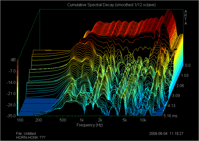

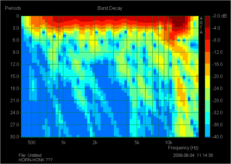

How is "Horn Honk" Measured ? - ( or what metric do you guys use to distinguish "honk" from merely poor Frequency Response )
"Horn honk" is a subjective phenomena which disappears as various causes of diffraction in the horn/waveguide and at its throat and mouth are eliminated.
Phenomena caused by diffraction are versions of the original driving signal (or parts of it) which arrive at the receiver delayed with respect to the original.
Geddes's study shows our sensitivity to the phenomena increases with increasing SPL. That's how "horn honk" is measured: psychoacoustically.

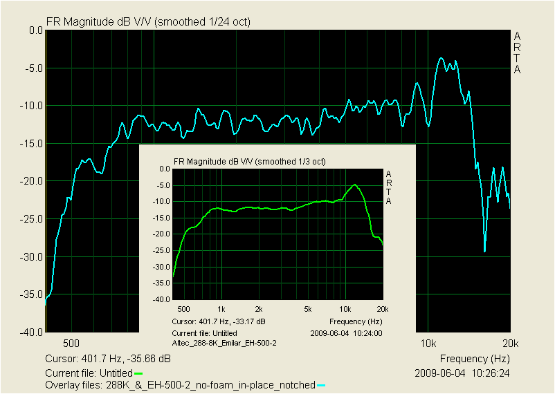

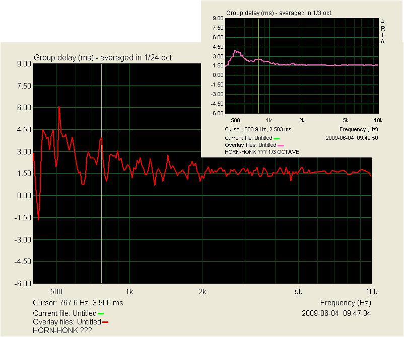

- Here's the FR for the above pic ( which showed only group-delay ) .
- This on-axis response allows for a pretty decent sounding combo / though the "Q" of this 90 degree radial is wrong for my place ( too many early reflections / even with all the room treatment that I have in place ) .
>< cheers 🙂
>< cheers 🙂
EarlK said:- Does anyone see any HONK displayed within the following Group Delay trace ?
@ 750 Hz, maybe?
