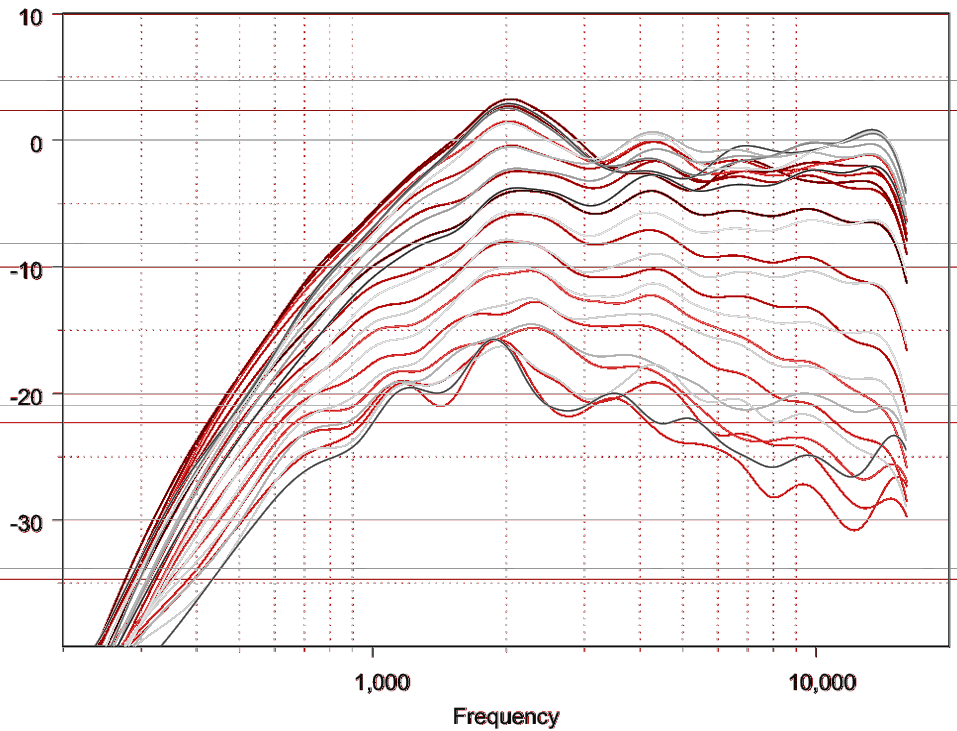

ZilchLab said:What the foam does, in a gross sense, at least, is visible by clicking between Pages 33 and 34
I took the w Foam curves and made them red. I set the background of the no Foam to transparent so that when i laid the No Foam over the Foam, and differences caused by the foam would peak out from underneath as reddish bits.
Some bits will be a bit fuzzy, the 2 charts were not the same size so i had to fix that.
dave
I am missing something?
"I don't think I see the difference, except the high end attenuation. And more hi attenuation off axis."
I see the same thing you do.
"The concept here is that the foam will attenuate the HOM more than the fundamental mode because the HOM travel a longer distance."
Not that I see. It's attenuating all right, but I don't suspect we are to conclude that HOMs are contributing that much to the VHF response.
"The foam plug will also attenuate the mouth reflections, thus reducing a major cause of linear distortion."
I'm not seeing that, either, to any significant degree....

Probably not. More likely, you are seeing exactly what Geddes expects you to see.
HOMs are a higher frequency phenomenon, so more attenuation at high end should be expected. No?
Think of it this way, in the first inch or so, the higher frequency HOMs will diffract. This means some of the wave will reflect not just on an angle of incidence like we might see a bullet ricochet off a wall, but will sort of spray backwards and across the waveguide as well as forward in the guide. The higher the frequency, the more likely these diffraction products will reflect several times across the the narrowest part of the waveguide The chances these products will continue along the guide on axis are mighty slim, I should think. And they will radiate from the mouth delayed with respect to the on-axis waves (whichever axis is under examination).
So attenuation by foam of non-zero axis high frequencies should be greater.
But since the os waveguide has a falling off axis power response anyway, I think its rather difficult to judge exactly what's going on.
I think the difference between impulse responses with and without foam is far more likely to show a diminishment of time based distortion.

FrankWW said:I got no significant SPL losses on either by applying 30ppi.
Geddes shows 3 - 5 dB attenuation in the VHF; I'm calling that significant.
You're suggesting that the Geddes waveguide has 3 - 5 dB of HOMs?
FrankWW said:But since the os waveguide has a falling off axis power response anyway, I think its rather difficult to judge exactly what's going on.
He corrected for the power response, 6 dB/octave.
Are we looking at the same curves?

ZilchLab said:
Are we seeing HOM removal, or merely the foam behaving as a lowpass...?
To get more of an idea of what the foam is doing, we should probably be testing it with a horn that's known to honk. We all know that sound and some horns are worse than others. It doesn't really matter (to me) if that's HOM or mouth diffraction or whatever if (big if) the foam can improve it. Usually horns that sound like that have a ragged impedance curve and, if the foam is doing some good, we should be able to see the impedance curve smooth out independent of the frequency response. If it did, that would indicate there's more going on than just a lowpass filter. So who has a honky horn and some foam to give it a try?
Y'all see my problem here, now.
I ask for evidence of HOMs, and I am sent to the Geddes ALMA presentation.
What I see is we stick in a foam plug, and it does something, and what it does might easily elicit, "AHHH, it sounds different, perhaps better, even."
I see what everyone else sees, apparently, and it is not evidence of HOMs without overlaying it with a bunch of assumptions.
It should be reasonably easy to document what the foam does outside of this context. JBL used it for L100 (and other) grilles 40 years ago.
No, I am NOT going to stuff a 511A with open cell reticulated foam, but an H91 might be a candidate for de-honking.... 😀
