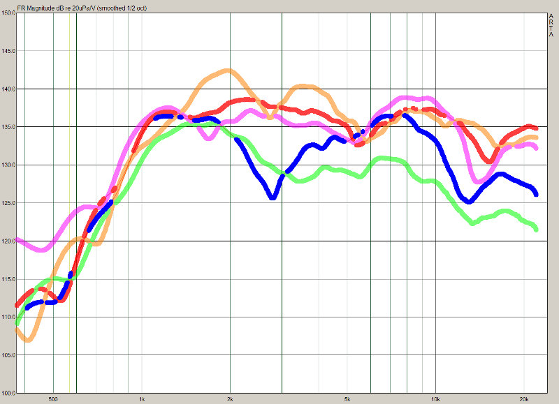

Here are polar measurements, with a BMS 4540ND compression driver. These are a bit rough, but that's because this is going in my car
So these measurements are actually performed in the car, with the waveguides sitting on my dash! Even with a gated measurement, it's impossible to avoid serious reflections.
So it's challenging to get good results, due to all the reflective surfaces. There's an obvious reflection at 3khz and 6khz. Since the two reflections are mirror images, it likely indicates that there's a resonance off something thats 1.125" long. Maybe the throat itself? A little bondo should fix this.
Anyhow, each curve is taken at approximately 12 degree increments. Starting with the on-axis curve, it goes orange, red, purple, blue, green.
To be honest, the OS waveguides that I built had better looking polar plots. But again, this is going in my car, and I'm prioritizing size over perfect response. I'll build a foam plug and add some bondo to smooth things out, then post new measurements.
