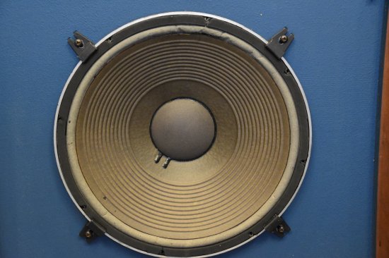

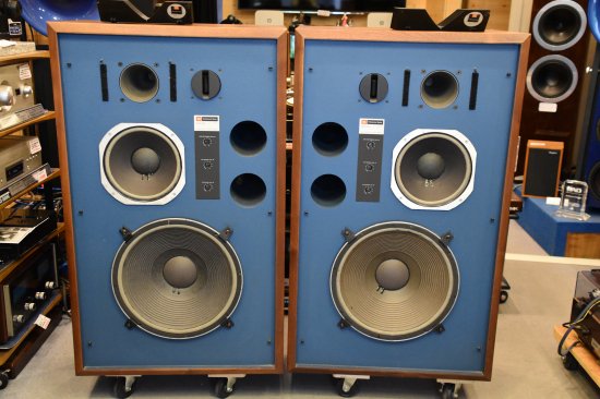

Looks like JBL agreed with you . Sometimes, anyway.
Drivers like the big bezel Markaudio should really be rebated, the newer ones, it is unnecessary, but it does look prettier.
As said, dispersion matters. While related to size it is also related to come shape and more. The better the higher frequency dispersion the more rebates become useful (sonically).
The shape of the transition from bezel front to baffle, and the height of the step you would rebate in, relates to the wavelengths of frequencies that will be affected.
