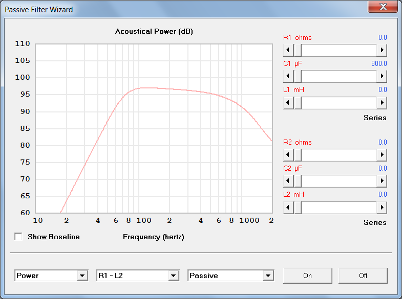

You can build that into a 25-35L box and use a series capacitor - approx 800uF for that kind of a woofer.
The attachment shows the power response for a HP-12W driver in a 35 litre enclosure, with a series 800uF capacitor.

David McBean, what is that program you are using to simulate the capacitors effects?
I have been using WinIsd and VituixCad for modeling.
I'd like to play around simulating different cabinet sizes and capacitors to find a good compromise on what will look good as well as sound good.
