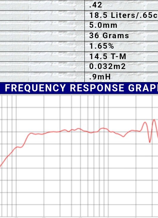

The thing is I ended up with the 8inch idea (a pair in parallel) cause I was trying to do smallest. I really want to do this driver by B&C...a 10 inch but need to do Iin pairs to raise the efficiency.Rob 🙂
https://www.usspeaker.com/B&C-10CLA64-1.htm
Looking to do a 80/60 horn
the driver is CP755nd by beyma.

I am trying to stay small...but slowly realizing I may have to use two units. I also do not want to use a 1inch CDThe is a 2-way speaker ?
A single 8" woofer crossed to a horn tweeter ?
