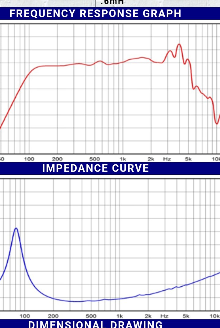

How high would you cross and where low pass?
OK but what horn/waveguide? Are you going for a DI match at crossover? That seems low for a typical 90 degree waveguide with say a 15" woofer. You have any measurements on the CD horn combo to see how well it supports an 800Hz crossover point.
Rob OK but what horn/waveguide? Are you going for a DI match at crossover? That seems low for a typical 90 degree waveguide with say a 15" woofer. You have any measurements on the CD horn combo to see how well it supports an 800Hz crossover point.
The thing is I ended up with the 8inch idea (a pair in parallel) cause I was trying to do smallest. I really want to do this driver by B&C...a 10 inch but need to do Iin pairs to raise the efficiency.
https://www.usspeaker.com/B&C-10CLA64-1.htm
Looking to do a 80/60 horn
the driver is CP755nd by beyma.
