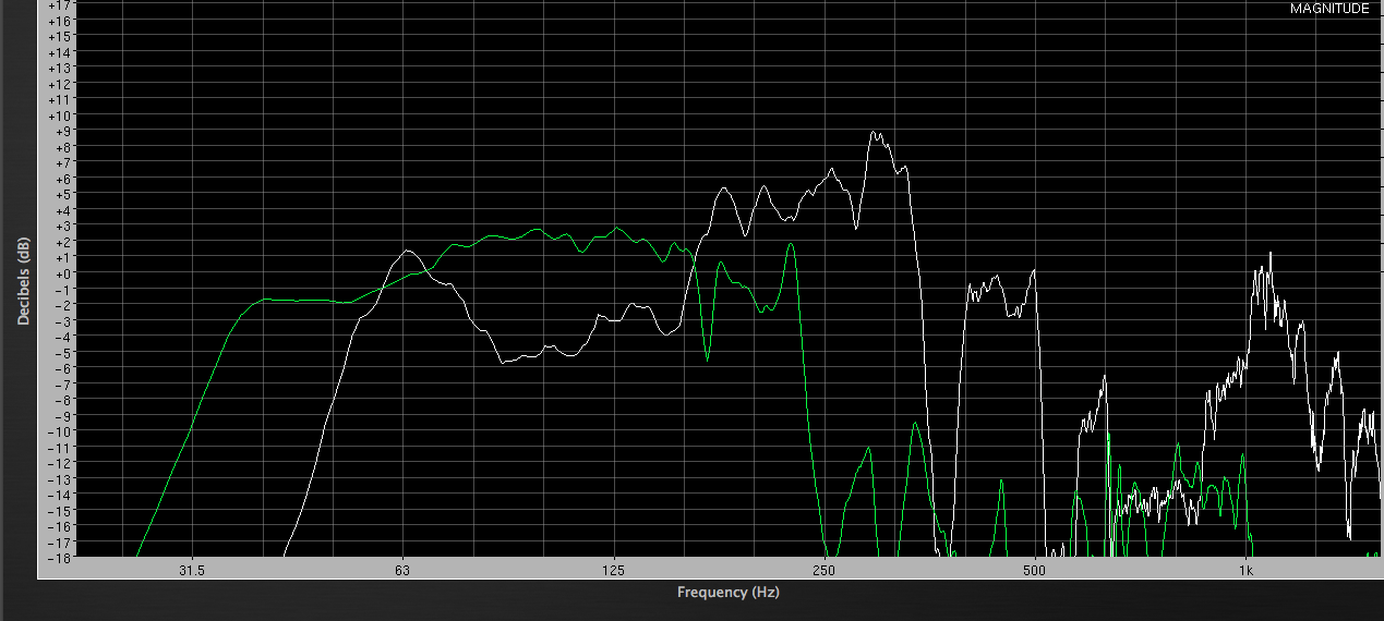

Quick poll, how high are people getting away with crossing tapped horn subs... I'm running MTH30 with recommended PD driver,from 40 to 130hz with 24db LR filter on amp, reckon we can run tapped horns higher..to 180?? with eq or not a good move? Cheers, Al (for live work in this case)

The upper range depends on the individual TH design, but a bit over two octaves from Fb (box tuning, excursion minima) to the usable top end before response gets too peaky is typical.
The MTH30 with a Fb around 50 Hz response appears to start to "go bad" about 160Hz.
The response of the two TH below give some idea of what you might expect, the white trace, an 18" TH design, has an Fb is around 38 Hz, smooth to 160 Hz, usable (more or less..) to 230 Hz. The green trace a 10" TH design, Fb is around 60 Hz, usable response to around 315 Hz.
Art

Hi Art,
Ah-ha, thank you for your reply and information. Ive been pondering selling my current tops and going for a design based on WAE audio's interesting colum of faitalpro 4s or was it 5s? He thought they should be crossed over at 180 so I reckon I might get away with it. This is for small pub gigs and I didnt fancy having to make a reflex to replace the MTH30, if I cpuld coax it just high enough. Fingers crossed! Its for live gigs. Cheers, Al
3*Fb could be a decent guide. So a 35 Hz TH may be good to just over 100 Hz. More technically, you need to look at its phase response. While its FR above 3*Fb might suggest it could be done perhaps with a bit of EQ and a sharp filter, its phase response might result in some issues through x-over region.
