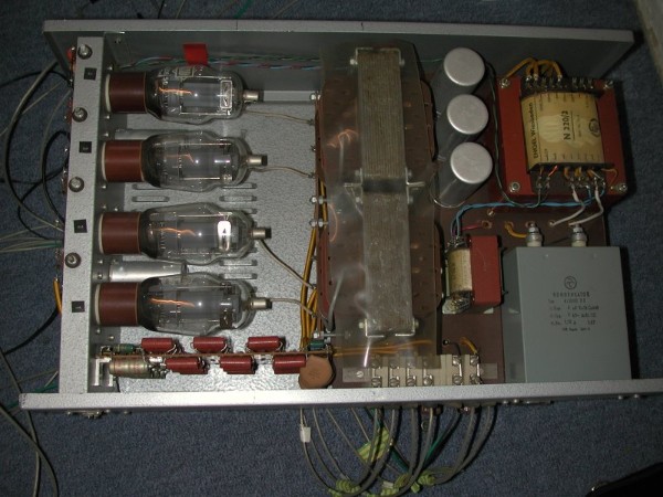

Hi djn,
in Heidelberg/Germany there is a man, who had a small production line of ESL's
He is still selling a brochure for a DIY direct-drive high voltage tube-amp:
>EURO 13.-: CONSTRUCTION-MANUAL. Containing more than 20 pages with the diagram and parts
>list and very important constructional details for the tube-amplifier and
>associated circuits. Special emphasis is laid on the efforts to be taken for
>security of the user, without which the amplifier should NOT be used.
>It´s plate-voltage is 1.800 Volts !
>ATTENTION! This manual at present is only available in german language
If you are interested I can send you his address.

Hi Frank,
Unfortunately I can't understand German. Do you happen to know what kind of tubes they are?
Wachara C.
Thsoe look like 807s, but I don't know for sure.
811A, more likely...

Well, the end result depends very much on the driving amplifier, the audio-tranny and the panel itself. As we all know, ESLs are no easy load and many amplifiers experience audible problems driving a panel properly.
The quality of the transformer is probabely the most important parameter regarding distortions. Just one decade ago, it was quite common to find low to lowest quality transformers with insufficient bandwidth and high distortion values. Reasons were cost and lowered drive demands for the amps.
No doubt that a reasonably constructed HV-amp could perform better than that.
But companies started using better transformers that allow for much higher bandwidth and greatly reduced distortion values.
With my panel-tranny-combination such low THD-values could be measured even at highest SPL-levels, that any HV-amp would have difficulties reaching similar SPL-values in first place let alone perform on such low distortion level.
Going directdrive dos not necessarily mean an improvement, neither measurement- nor acoustically wise. Getting rid of one problem-point (the transformer) introduces new problems which are not easier but rather more difficult to solve. Uhh ooh just one last remark....the HV-amps typically need output coupling caps! Aren´t coupling caps regarded as bad as trannies? *lol*

I don´t know the schematics of the innox, but what one can conclude from the infos on the website it will probabely work with a Schmitt or a SRPP-like structure in the output circuit. The idle current is quite low, so it is a class AB-design which needs to rely on serious feedback. I assume it is a redesign of the Strickland-amp.
The innox is an HV-amp somehow in between. On one hand its anode voltage is too low to drive medium- to large-sized wire stator panels, on the other hand its current capability will be too low to drive non segmented medium- to large-sized metal sheet stator panels to the full (have a look at the bandwidth screen shots). Its rather an amp for smaller panels with lower voltage and current demands. The output tubes (something like PL519) used are specced for lower continous anode voltages. As a result tube life will be shortened (Innox talks of ~500hours?). Hopefully the µController will provide for all necessary safety functions.
