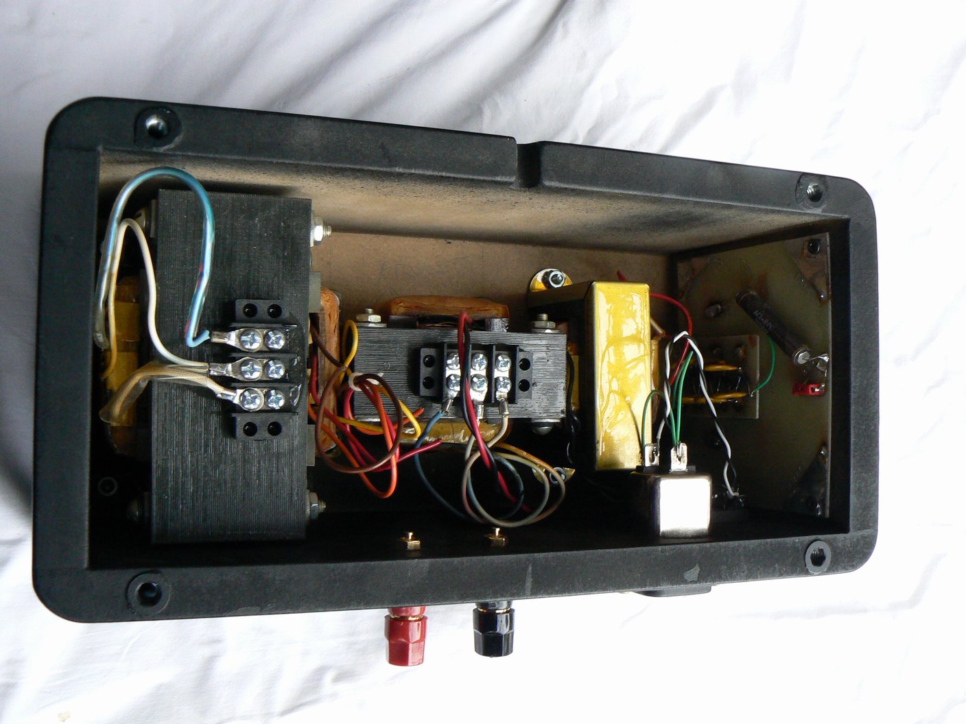

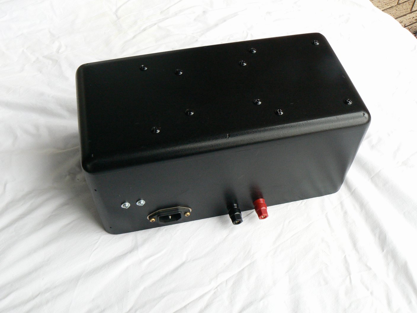

Here is an MDF case for a set of Acoustat interfaces. This is about as small as you would to make it. You can see that the transformers are all at right angles to each other to minimize magnetic coupling. The wooden case provides a cleaner more relaxed and open sound when compared to the metal case. Note the line filter feeding AC to the HT supply. This is a very good idea to help keep noise low.

MDF case for Acoustat interfaces

Here are the pics of Moray James wooden interface boxes.
His words from Post#30
"You can see that the transformers are all at right angles to each other to minimize magnetic coupling. The wooden case provides a cleaner more relaxed and open sound when compared to the metal case. Note the line filter feeding AC to the HT supply. This is a very good idea to help keep noise low. "

Those look very tiddy and very well constructed. I am going up to see the speakers today. I will take many pics and post them up. If I like the bass setting at the flat position, should I find a transformer that is wound to just that ratio or is that just splitting hairs cost wise?
I see no reason to not wind your own.
