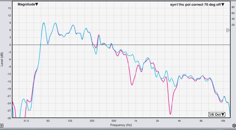

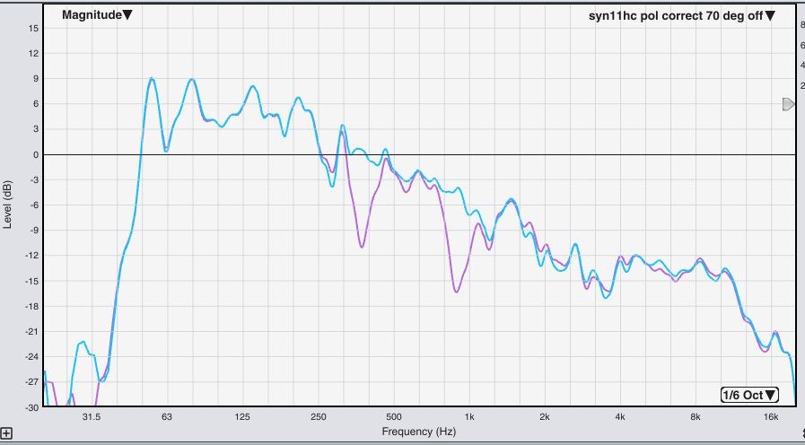

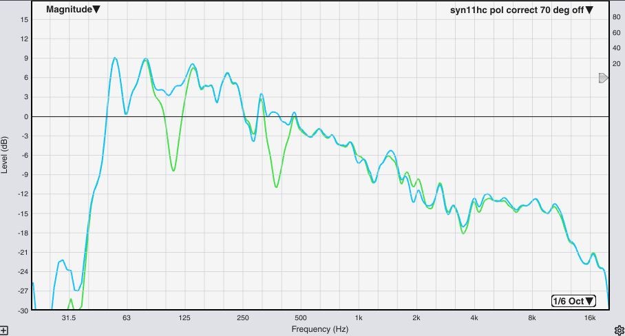

And yep, still holds up past 35 degrees. Not as easy to see of course., with more response variations further off-axis.
Here's about 70 degree on-axis.
Line of sight to the CD ceases at 37.5 degrees on the 75 deg conical horn.
And at 70 degrees off, there is no direct line of sight from mic to any of the drivers/ports sections., not even the sub section's port.
Completely around the corner, so to speak.
A combined graph like before got a little hard to follow, given more off axis jaggies, so i split out the polarity inversion graphs.
Light blue in all three graphs, is all sections with normal positive polarity.
First graph, red is HF inverted.
Second, purple, is mid.
Third, green, is low.
null test 70 deg off hf rev.JPGnull test 70 deg off mid rev.JPGnull test 70 deg off low rev.JPG

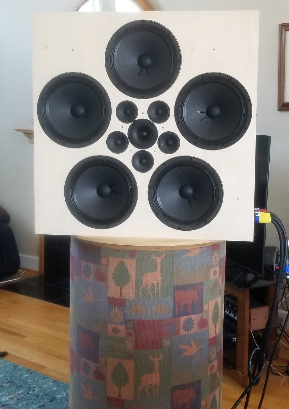

That's what I've built...other than one flat baffle ring-array attempt.....that was a total turd, and my only failure to date haha. Probably should have simmed it for sure!!! .penta flush R.jpg

...other than one flat baffle ring-array attempt.....that was a total turd, and my only failure to date haha. Probably should have simmed it for sure!!! . penta flush R.jpg
What my eyes see there is a (kind of) 180 Degree synergy/MEH horn... that may or may not have obeyed the 1/4 wave spacing "suggestion" 😉
I like it, thanks for sharing. Have you still got it ? maybe a coax instead of the 6 central drivers ?
Yep, your eyes see the same things mine do 🙂

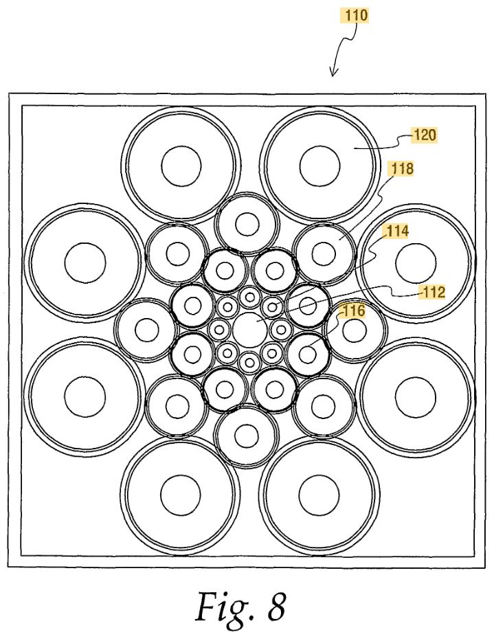

I got the idea from some of the "fractal array" builds, and and the image below from one of Tom D's unity/synergy patents.
The dome tweeter/midrange was an SB Acoustics SB26STWGC-4, that i hoped to use down to 650Hz.
Then came the rings of 3" & 10" Faitals.
1/4WL was fairly decent, element to element around each 3" and 10" rings...but of course not close across the rings' diameters
1/4WL was also not too bad going out radially from the center dome , to mids, to lows.
I could get good tuning to a spot, but off-axis plain sucked......no matter what processing was tried....
so I ditched the thing and said never again to multiple drivers handling same freq range, other than with line arrays or unity/synergies.
I came to the conclusion, rightly or wrongly, that the distance across the rings' diameters is a big muck up...
