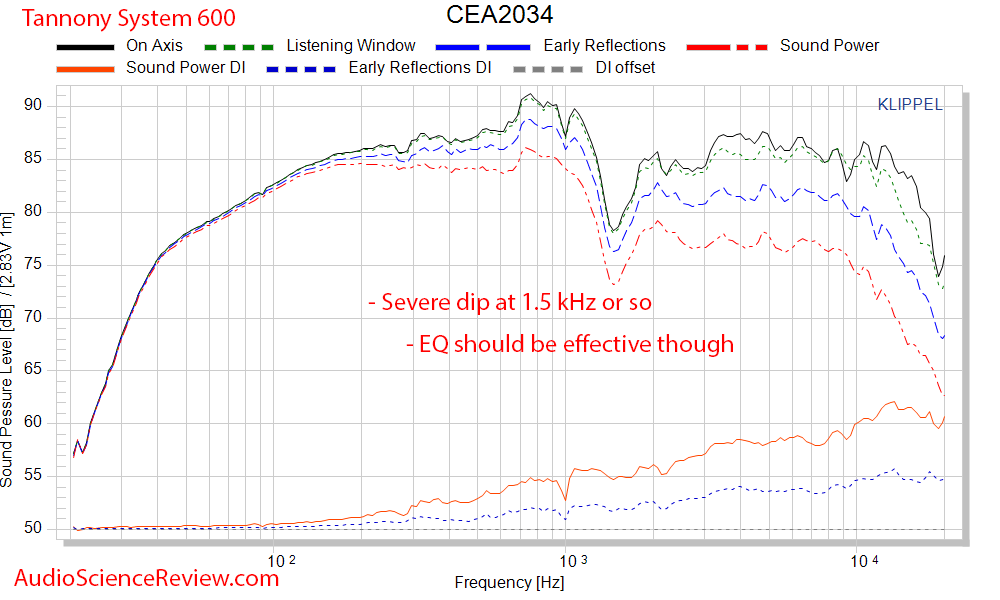

Take a look at the freq response in the link i gave Allen, it reveals the issue quite clearly and cannot be equalized as suggested in the graph ( and as my own try to eq failed too... on same serie of driver but different diameter).
Experienced the same with my 3 ways which use 15" to 4" at 750hz ( stock), as expected destructive interference can't be eqed....
Post #18 Allen.
On my Tannoy it was easy to determine it was a Z axys issue ( it's more or less common issue with these drivers, really coincident on Z axys being the exception rather than the norm with coax).
On my threeway it is related to directivity mismatch but it didn't stopped me to identify if it was related to Z offset too/phase issue from initial passive xover ( using either 'J.Bagby method' - involving taking measurement of all individual drivers, then by group of two and with three of them and then load the individual response into lspcad and play with Z ( depth) parameter until overall shape of simulation match measurement/ or wavelet method as once suggested by Mark100 in an article he linked in the past- both are ok but i prefer wavelet as it's quicker and give info about time delay and phase( if applicable) in same measurement).

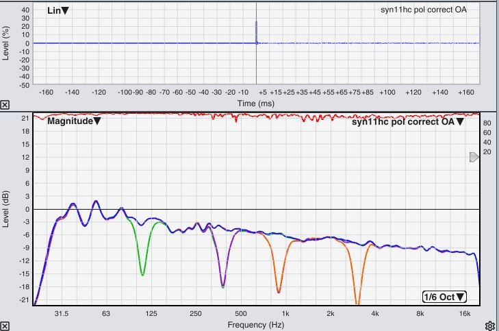

Ok, here's what's on the bench right now for a little demo...Not difficult? Lol
Working on seeing if i want to use a permanently imbedded house curve. Indoor non-gated, just fooling around really....
5-way synergy, syn11.
Here's on-axis. Blue = all polarities are correct
Notches at 110Hz and 375Hz, were caused by swapping low driver polarity.
375Hz and 900Hz caused by mid swap.
900Hz and 3000Hz by HF swap.
Done swapping one section at at time, and saving each trace.
Xover points of course...110, 375, 900, and 3000Hz.
All notches plain and clear as expected with on-axis tuning.

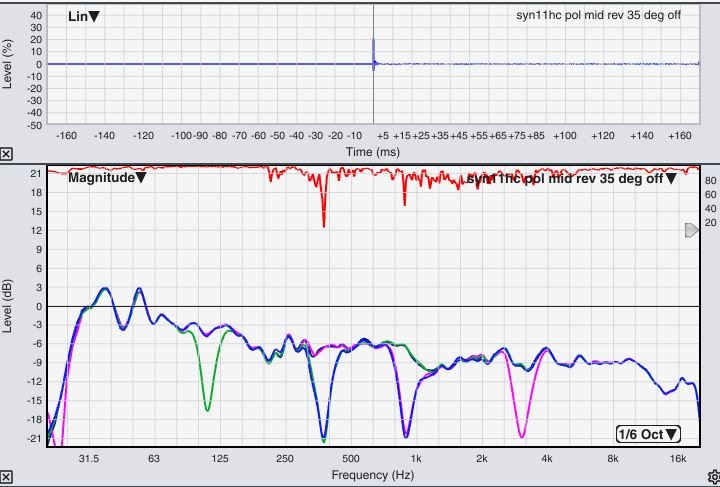

Here's same thing but now at 35 deg off-axis.
Horn is a 75 deg conical, so almost outside of its pattern.
Looks like nulls can be seen pretty easily, huh
Without their frequency budging a single Hz....

I don't see anything relevant - https://www.audiosciencereview.com/...y-system-600-speaker-review.11919/post-345503Post #18 Allen.
offtopic:Ok something wrong happened when i copied the link i suppose, it's on the first post of the thread
Traditionally (very) bad and way to quick of an advice as always to "just EQ the crap out of things".
(I am referring to the screenshot)
Bizarre that some people just keep doing that without knowing and EXPLAINING the ins and outs of a system as well as the (lack of) resolution of the graph and/or measurements. 😡👎
Can you determine whether this is a timing or phase issue by looking at the plot? Can you determine the amount of delay by looking at the plot?it's on the first post of the thread

I like to understand things, even more when something gone wrong with 2 designs using same drivers ( System800a doesn't have the dip) and when it's easy to find schematic of both designs... but he doesn't have time to spare, it's an 'old' design,... so wrong conclusion about the issue = wrong recommendation...
@AllenB : no of course not with this plot only, but if i see this behavior i know what to look for in the schematic of the version which doesn't have the issue and/or do what i described earlier to identify if it comes from this effect or not ( wavelet is good to identify both (delay/phase) in one shot).
Iow if a dip like that appear with a coax i know who the culprit can be.
