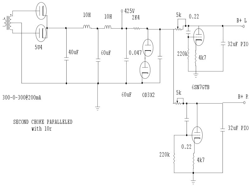

Here's the schematic for the PSU stage of my SRPP 6SN7 linestage.The 6SN7 and 5k pots work with 1K plate resistors to drop the 300v series-connected OD3 output to get 250v on the plates of the 6SN7's in the preamp section.And also to give a split-rail HT supply.Sounds VERY nice!!🙂🙂
s2kov, you want to torture that tube? 😀
the tube datasheet will tell you the maximum recommended capacitance. for the 0A3 it's like 0.1uF so a 100uF will be huge!
however, my VR105 datasheet from STC did not specify the max capacitance.
