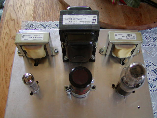

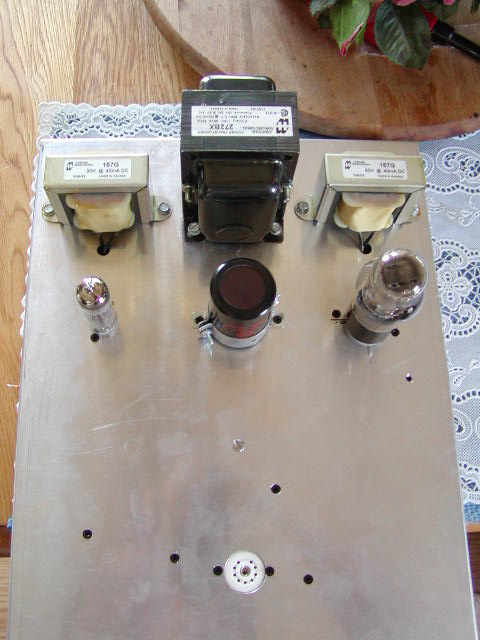

can't get 0D3 to stay on, any ideas?
Ok, I finally have gotten around to playing with my latest project line amp. Its a 5687 with a power supply consisting of these parts. A Hammond 272BX transformer, 6X4 rectifier tube, (2) Hammond 157G 30H
40Ma DC chokes, a dual 50mfd capacitor, and a 0D3 voltage regulator tube.
The power supply voltage after the last cap is 434volts. This is without the 0D3 or the 5687 tube. When I plug in the 0D3 tube it lights up ok without the load(5687 tube). When I put the 5687 tube into the circuit the 0D3 lights for a split second then goes out.
I have tried a 0B3(VR90) tube and I can put the 5687 tube in circuit and I end up with 93.9 volts at the output of the tube.
I have also tried a 0A3 tube and it puts out 80.6 volts with the 5687 tube in circuit.
What the heck am I doing wrong that the 0D3 tube won't run the load?
Any help here would be appreciated very much.
I will throw in an unfinished picture of the animal. Keep in mind that this is a garage animal so cost and finish are minimal.
