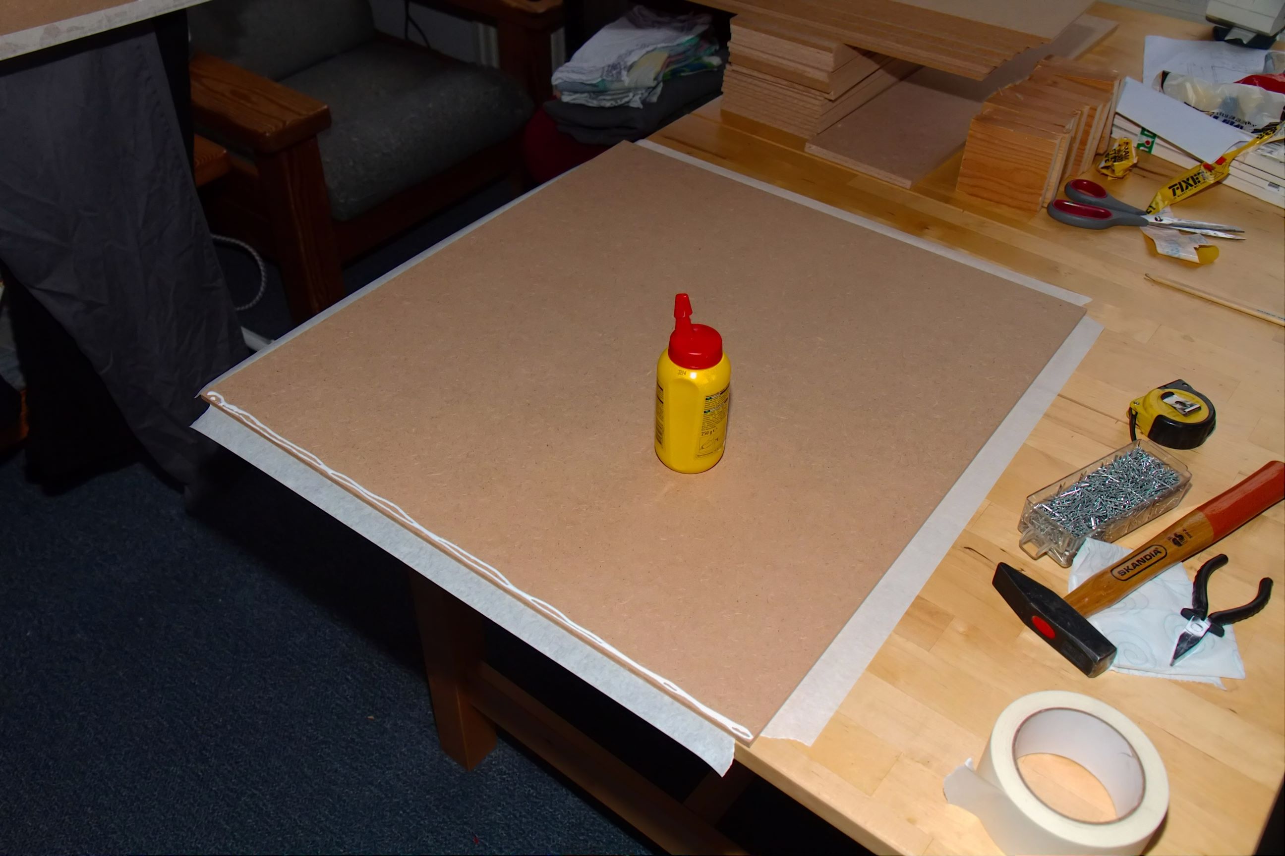

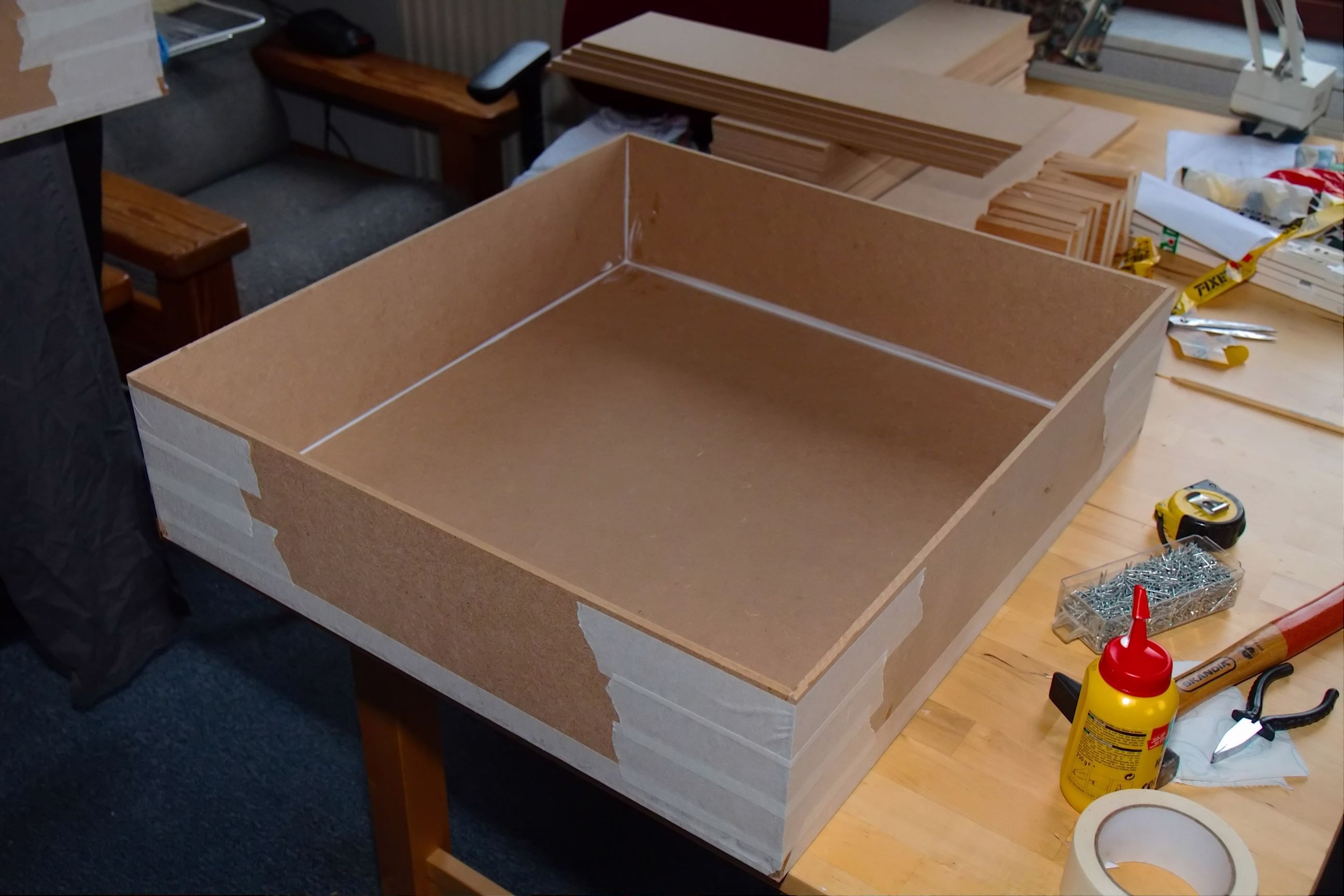

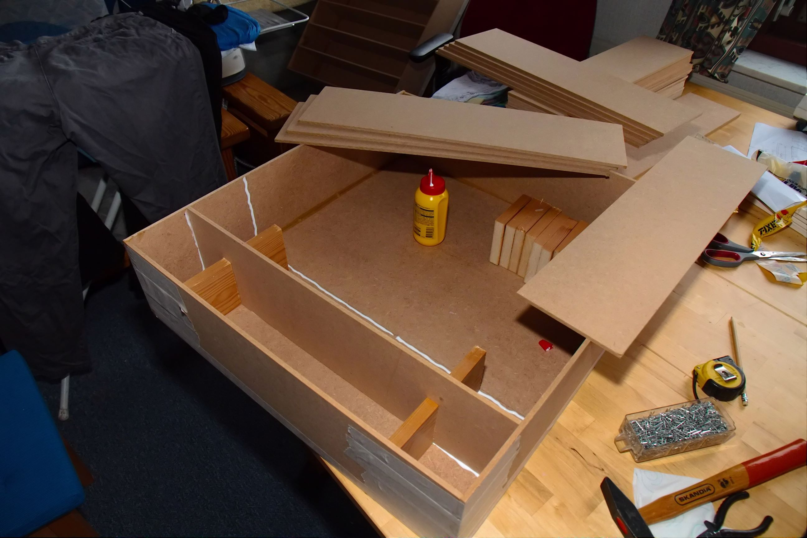

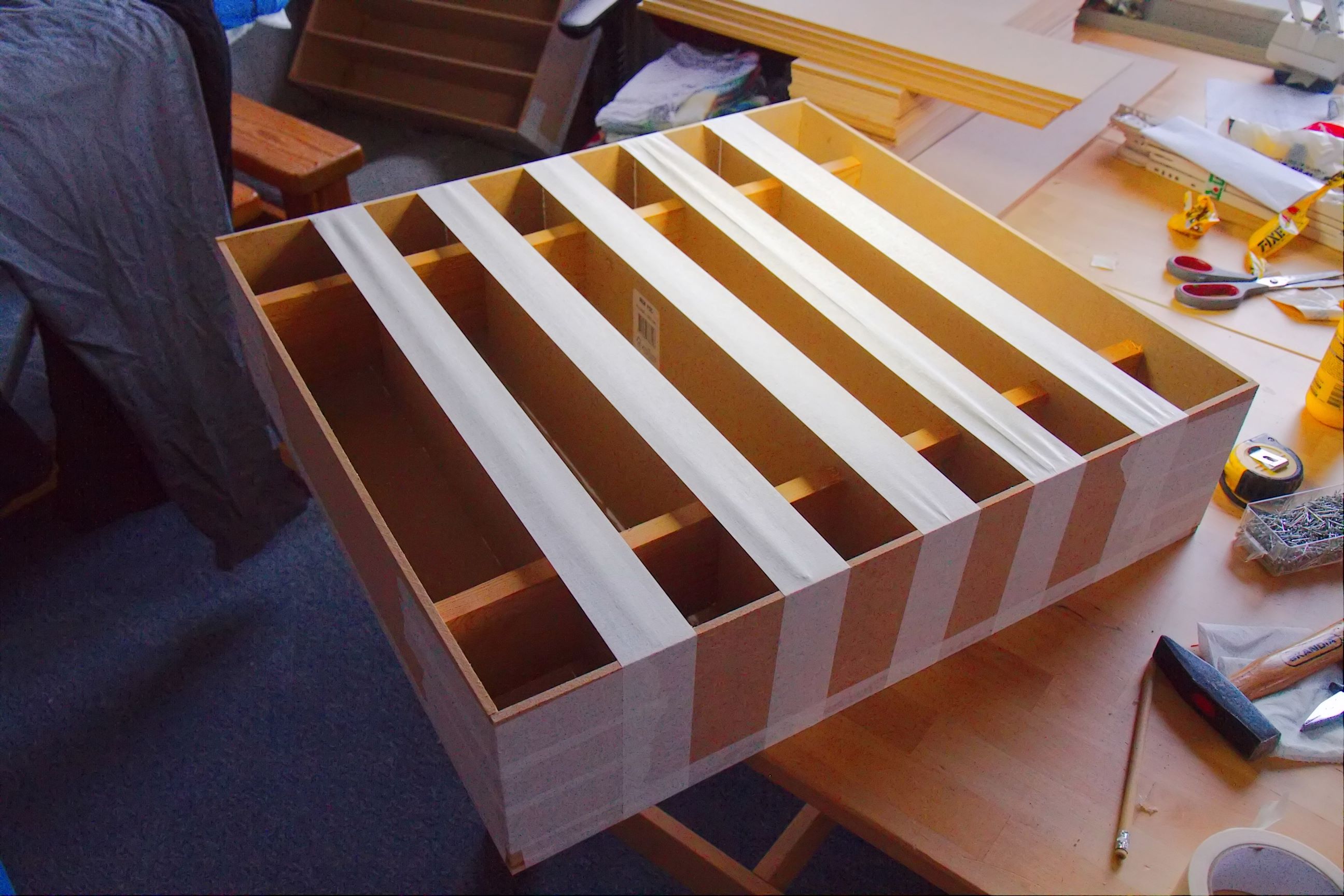

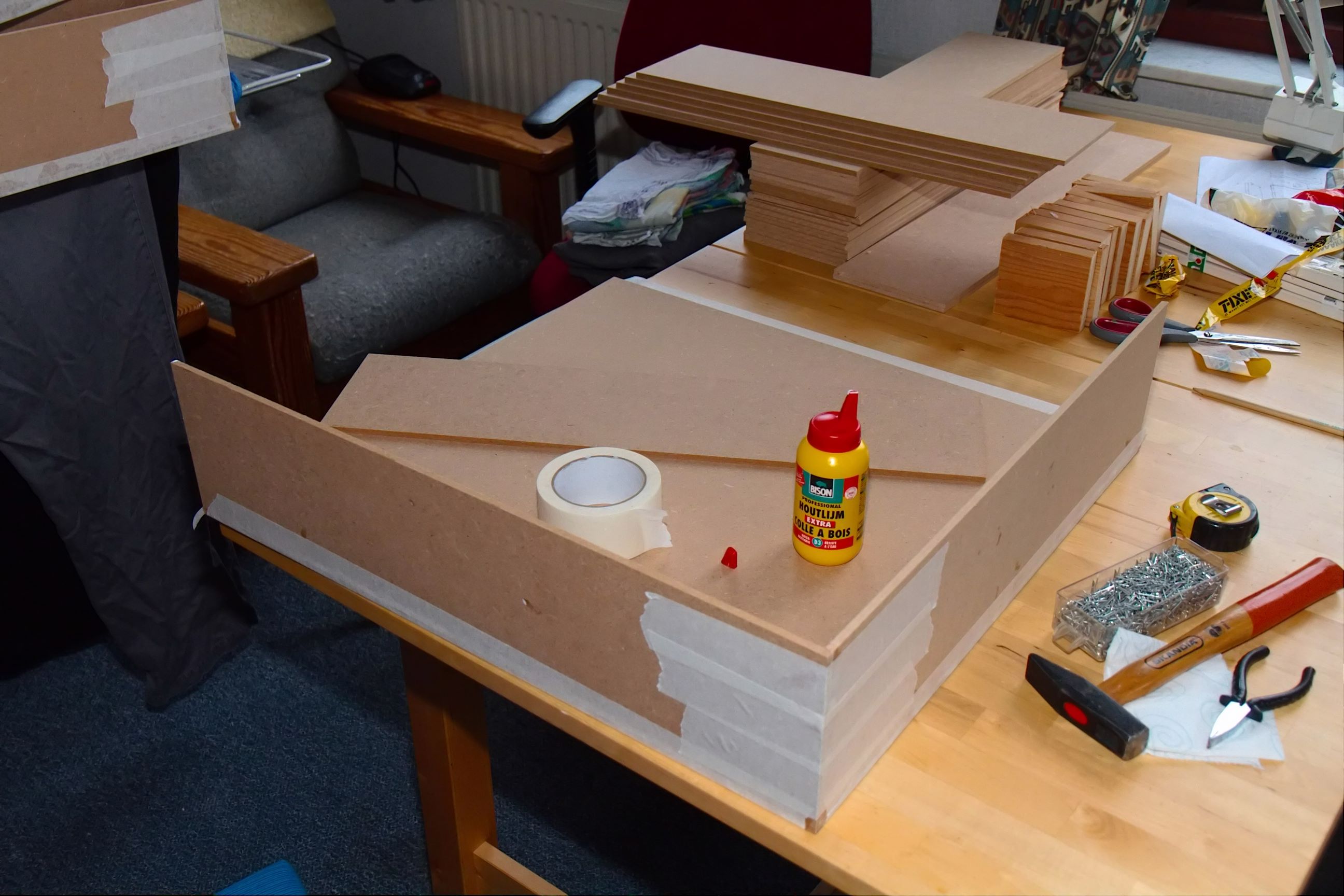

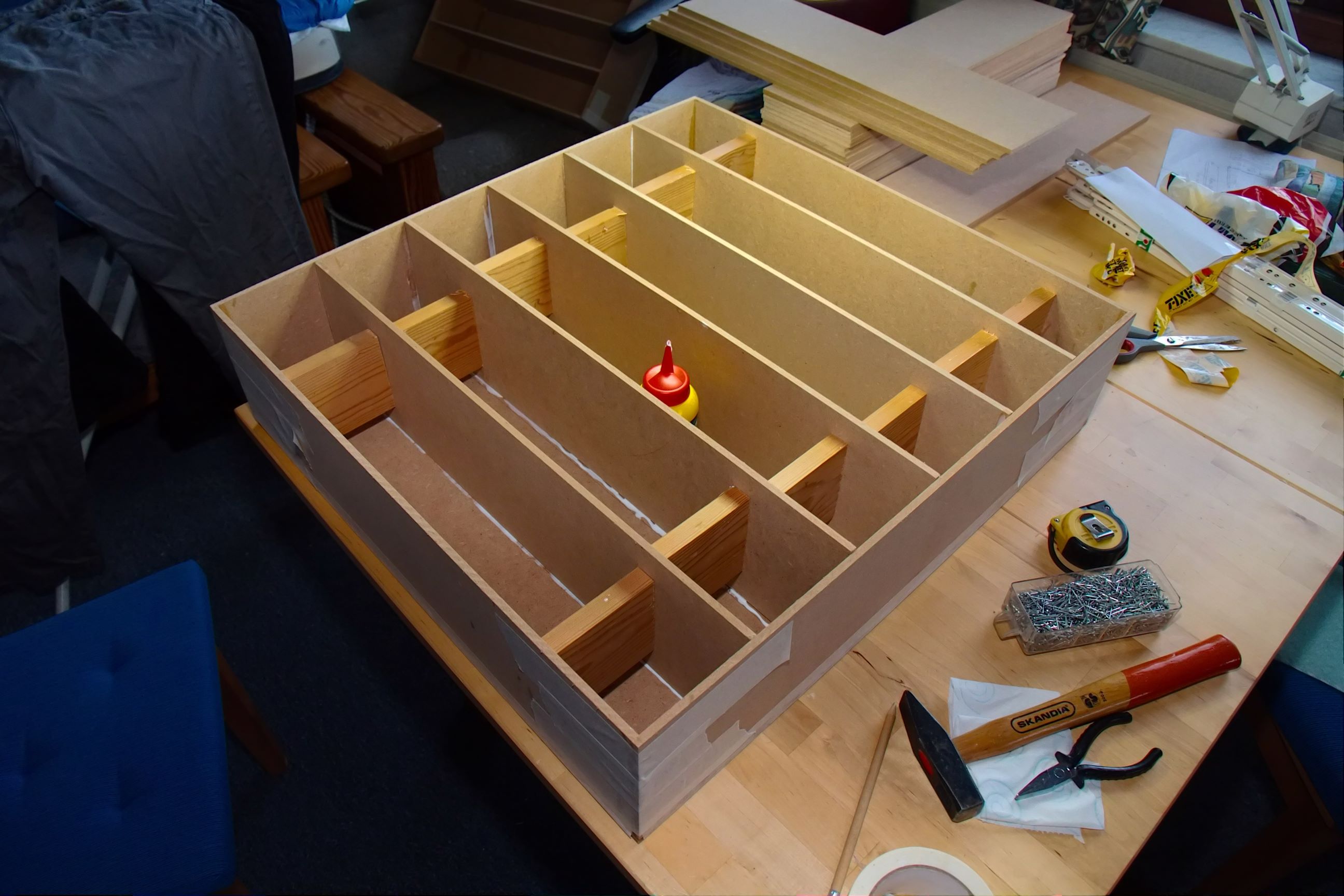

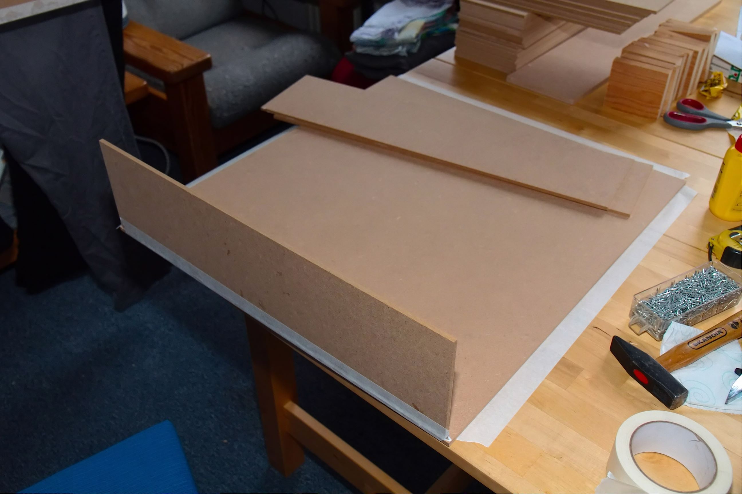

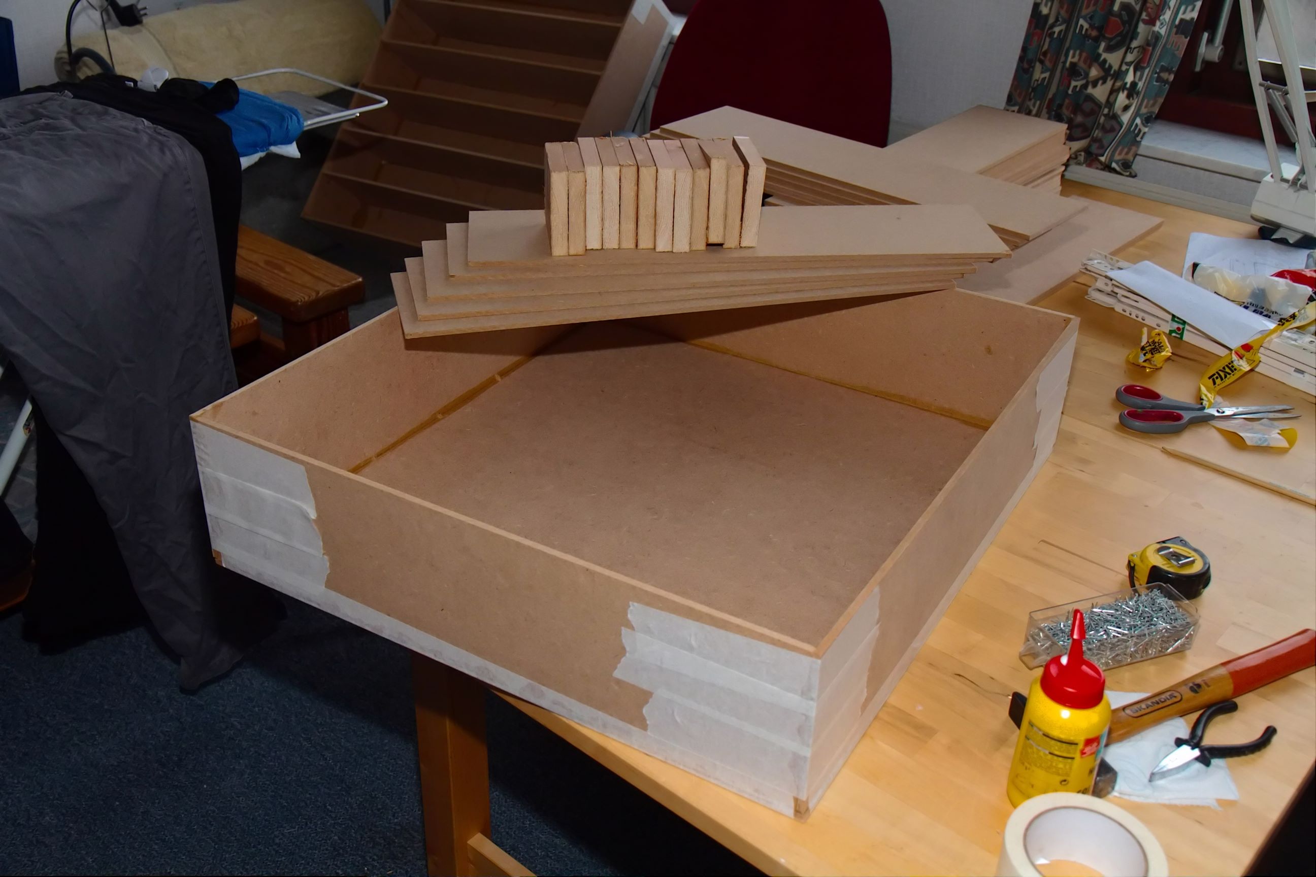

Next I must build a drawer-cabinet that holds 4 drawers that store the bags.
The drawers are (about) 60x60cm and 15cm high each drawer is divided into 6 10cm wide slots.

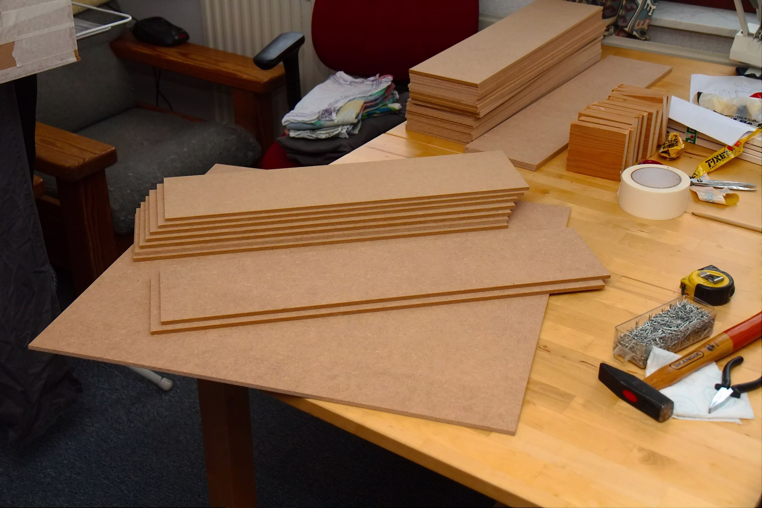

The exact wood measures are:
Bottom plate: 60cm x (60cm + (7 x 8d)); 1 needed (per drawer)
Front plate: 15cm x (60cm + (7 x 8d)); 2 needed (per drawer)
Dividers: 15cm x 60cm; 7 needed (per drawer)
Spacers: 10cm; 12 needed (for all drawers)
All plate's(boards) are of 8mm MDF (medium density fiber-board (http://en.wikipedia.org/wiki/Medium-density_fibreboard)).

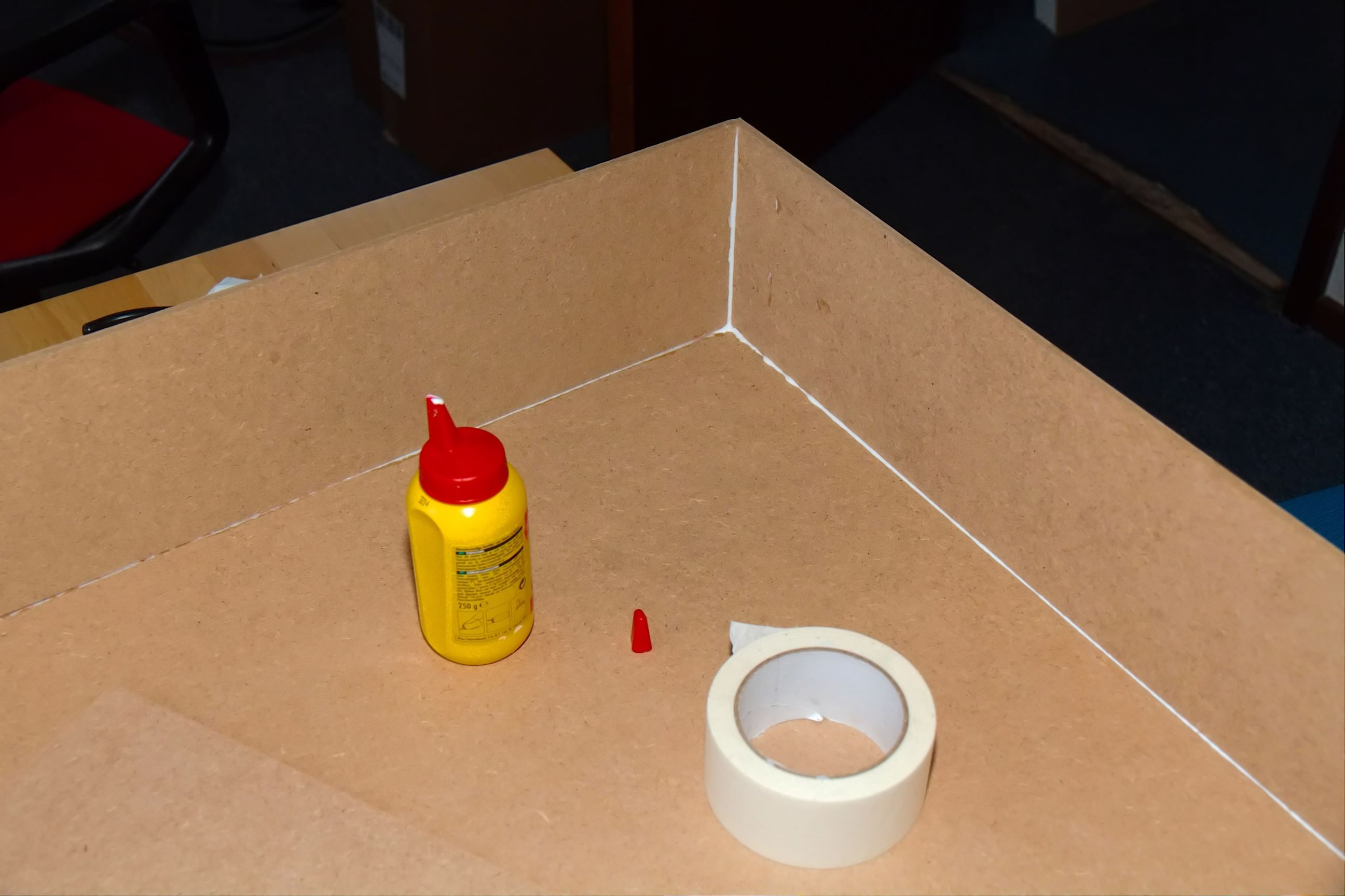

You need wood-glue, a good quality tape and a bit of 'skill' to build the drawer.
After gluing the dividers in place, do not forget to lift the spacers (so they do not get glued in place).

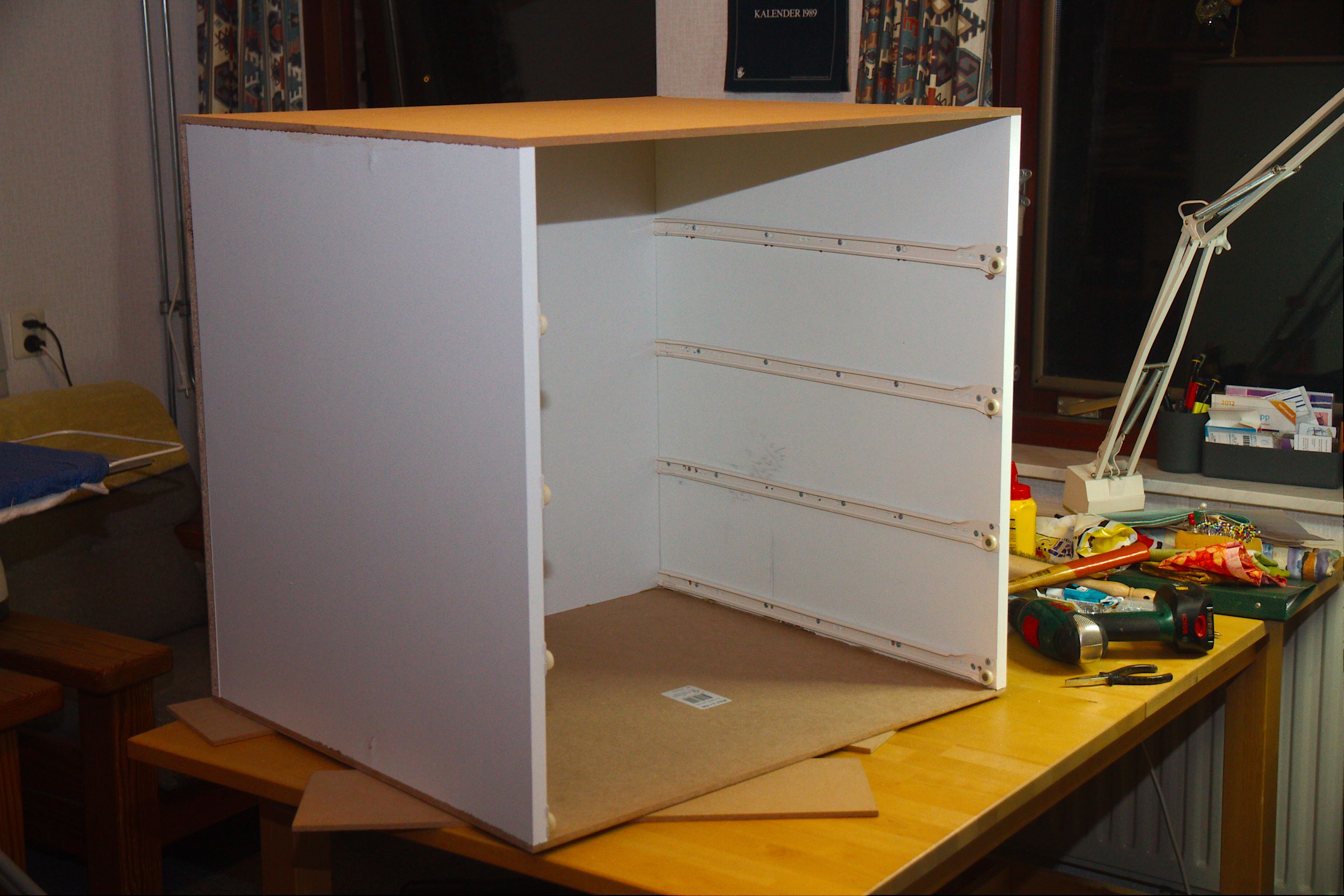

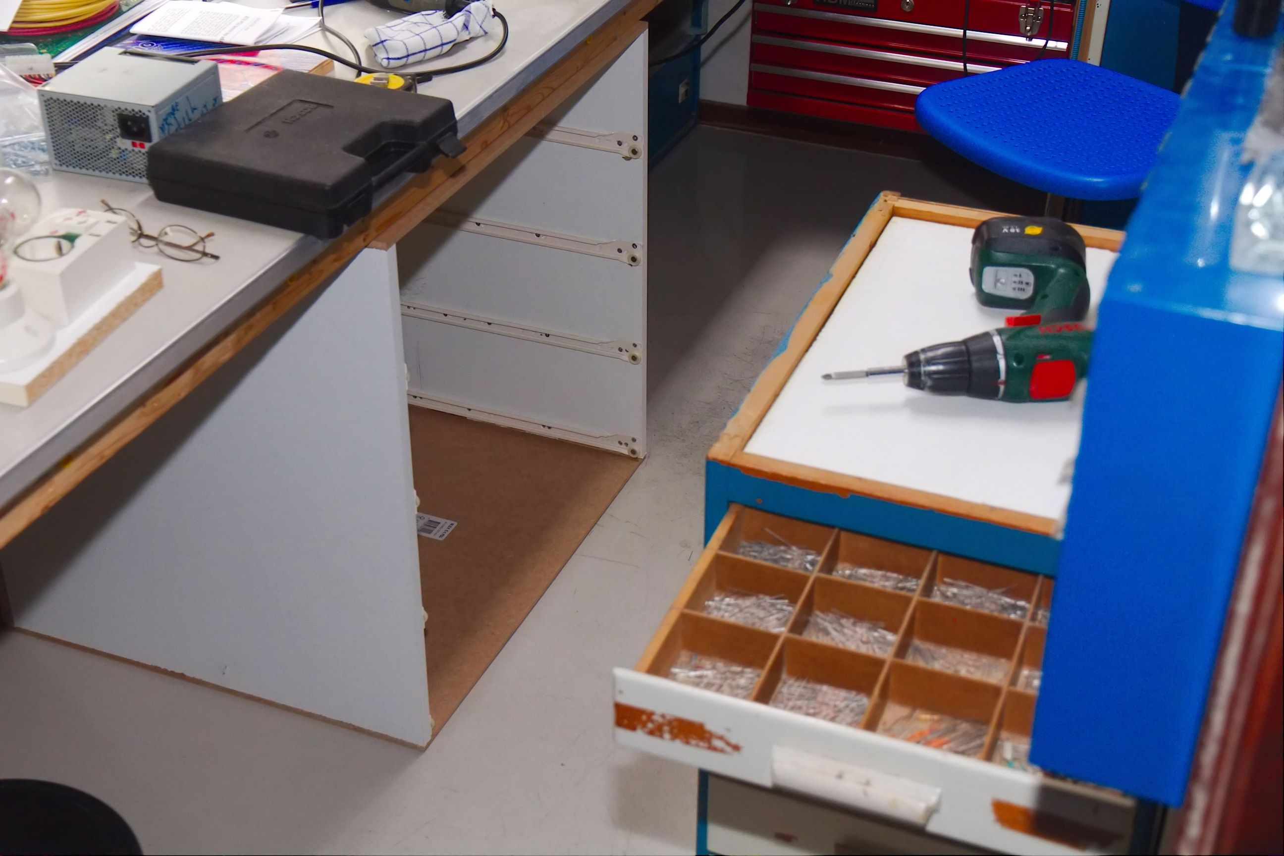

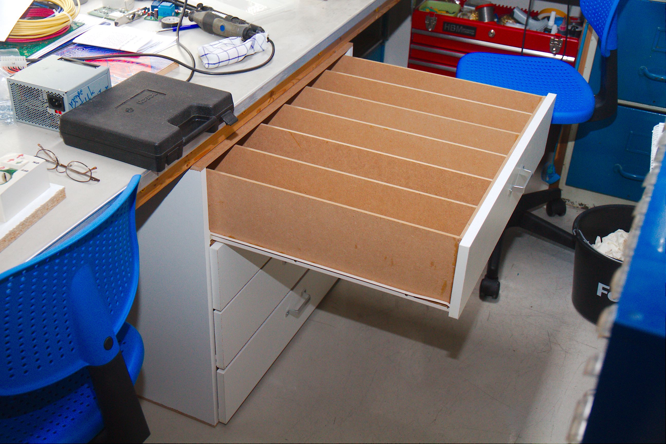

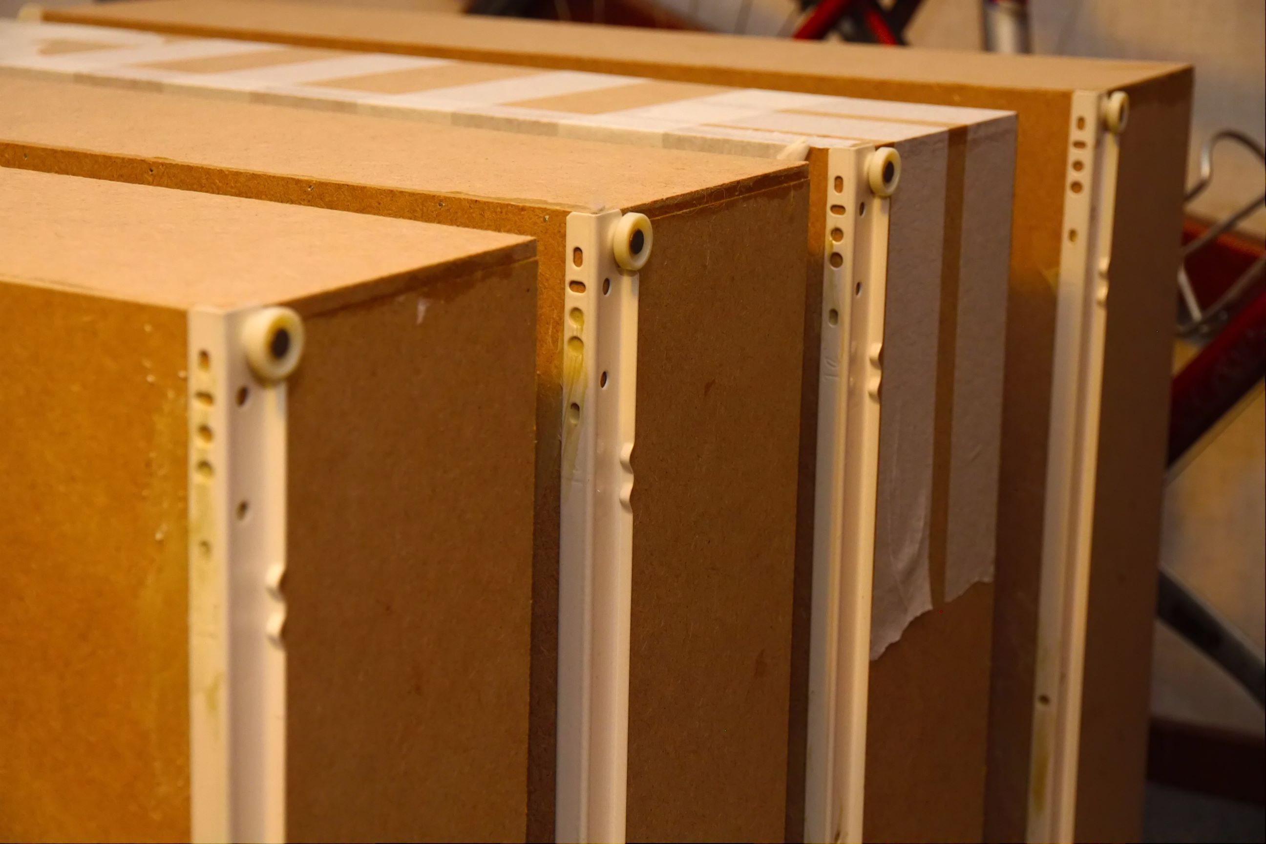

This is the second part of the components-cabinet build.
After building the drawers we need to attach the rails to the bottom of the drawer, this is easily done using mounting-glue (as shown).
Next a simple box (one side open) is build, the height of this box matches the space under my lab-desk.
Width outside: 60cm + (2 x 8mm MDF) + (2 x 12mm rail) + (2 x 18mm board)
Height outside: (4 x (15cm + 8mm MDF drawer)) + (3 x 12mm space between drawers) + (2cm space on top) + (2 x 8mm MDF top and bottom)
After building the box, the drawer rails are mounted in the box.
Next the box is moved under the desk (the old cabinet is set to the side, it is hard to depart fro it, I have been using the old one for more then 30 years 🙂)
One last thing to do to the drawers, fronts have to be added and a small handle is then attached to the front.
The last pictures show the drawers in the cabinet. All done.
Total cost, 130 Euro.

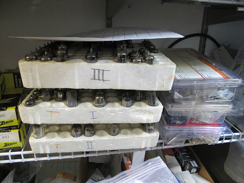

I keep all my resistors in plastic bags, and all those in a big cardboard box. Every time I need a resistor, I go through all the bags until I find it. No, they're not in any kind of order, just whatever order they ended up in the last time I looked for a resistor. I also have some common values in small parts cabinets that are labeled, and some easily read boxes in plastic storage bins. I do keep a master list of all values that tells me where to look. Sort of. Capacitors follow a similar system, I just don't have as many of them. Then there are the parts on reels out in the garage, lined up in cardboard boxes in no sort of order. Oddly, I have little trouble finding what I need in a couple minutes.
