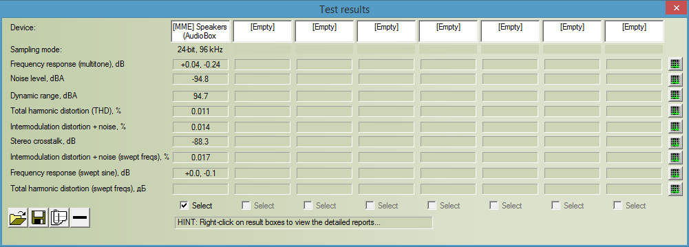

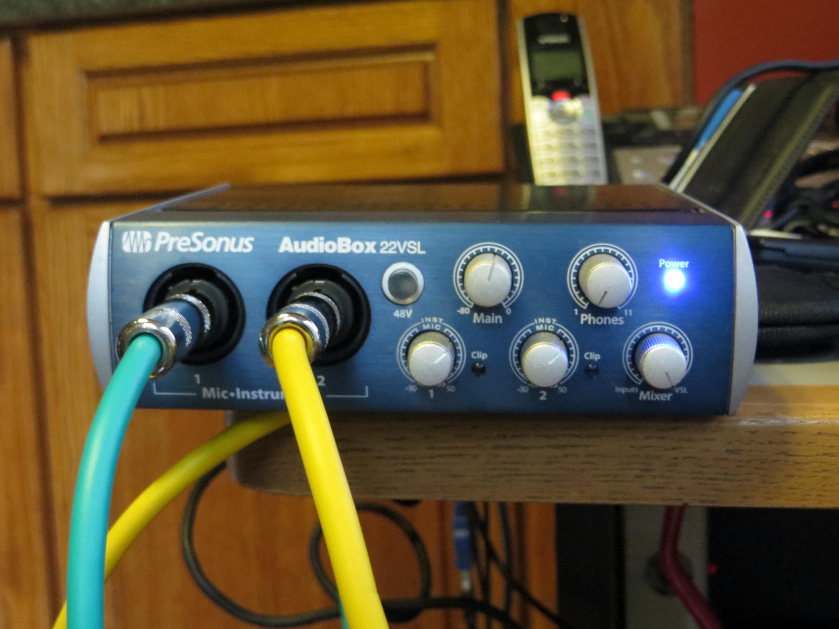

This is my Presonus USB interface set up to run the Audio Rightmark program which is a good starting point.
The Blue and Yellow wires run back to the TRS line out jacks on the back of the Presonus. You can crib the knob settings out of the enlargement of the photo.

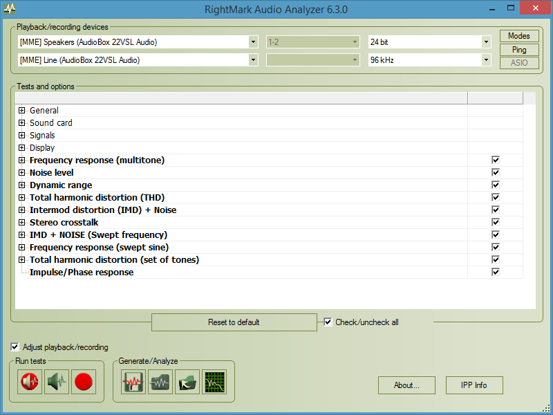

The Rightmark program is configured like this:
Presonus RMAA setup.png\
All I had to do is select the input and output devices and sample rate, etc. shown in the top two lines.

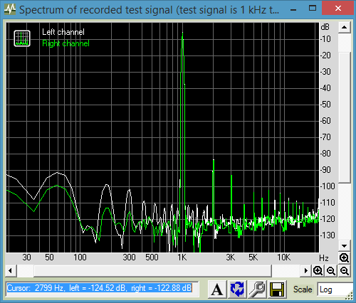

I press the button with the red loudspeaker in the "Run tests box" and I set the level controls on the Presonus appropriately:
I press the "Start Test" Button which takes a minute or so to run the test and enters a dialog box to manage the test report.

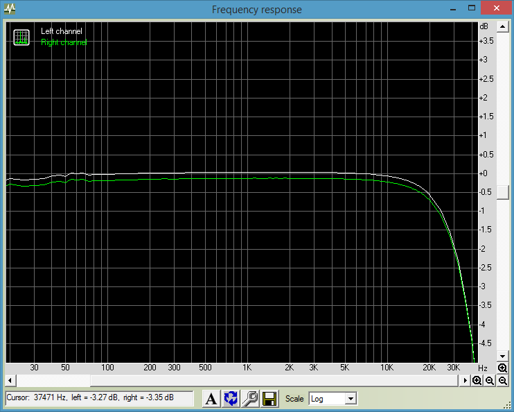

If I press one of the buttons on the right hand edge of the report management window, say for "Frequency Response" I get this:

I looked at your graph, it stopped at 20KHz, can you go beyond 20KHz as we usually look at the 20KHz sine wave and look at the harmonics.
It didn't stop @ 20 KHz, it just rolled off a bit. ;-)
When you need to measure high frequency nonlinearity, just use twin tones. You can pick the tones so that their difference is down at lower frequencies like 1 kHz.
You can use freeware programs like Audacity to create the test tones of your dreams and RMAA has a FFT mode for analyzing them.
