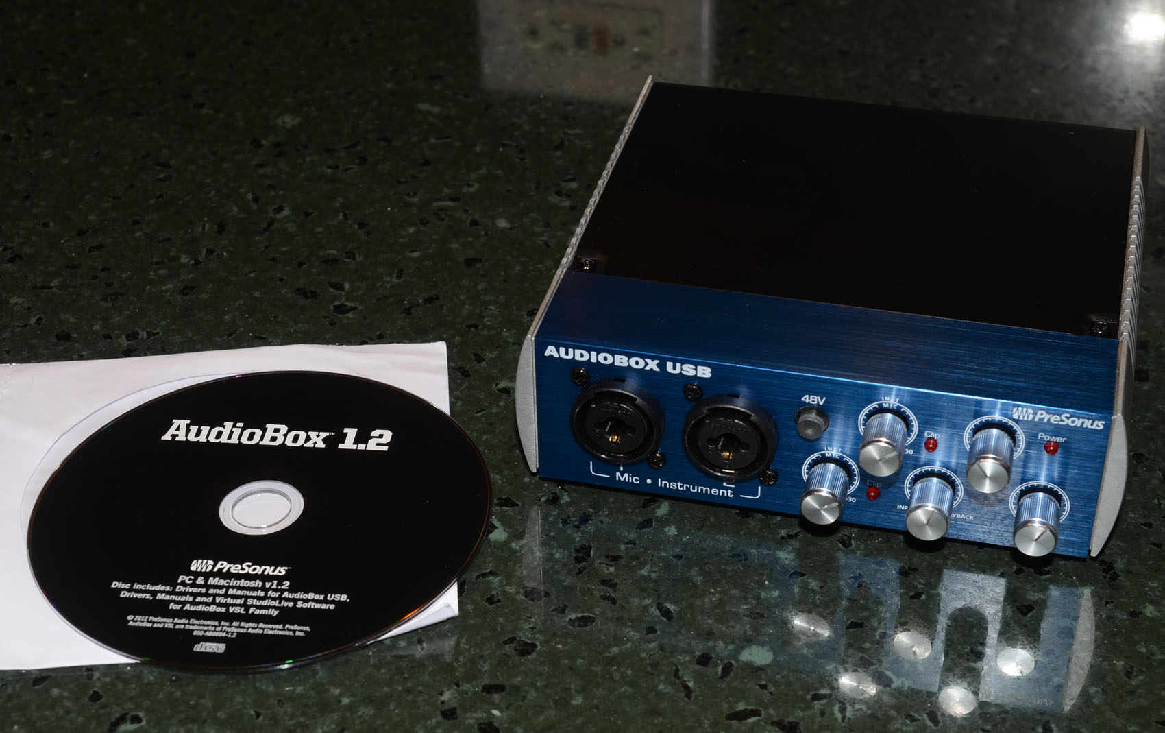

1) Is this one connects to any computer including a laptop through USB?
2) This looks like the Presonus Audiobox USB I have already shown in post #11. how can this one work as spectrum analyzer to display the FFT?
3) If it is like my Presonus, there is no signal generator output to drive the amp to perform THD display.
Can you point me to articles how to make a THD analyzer out of this?
Yes.

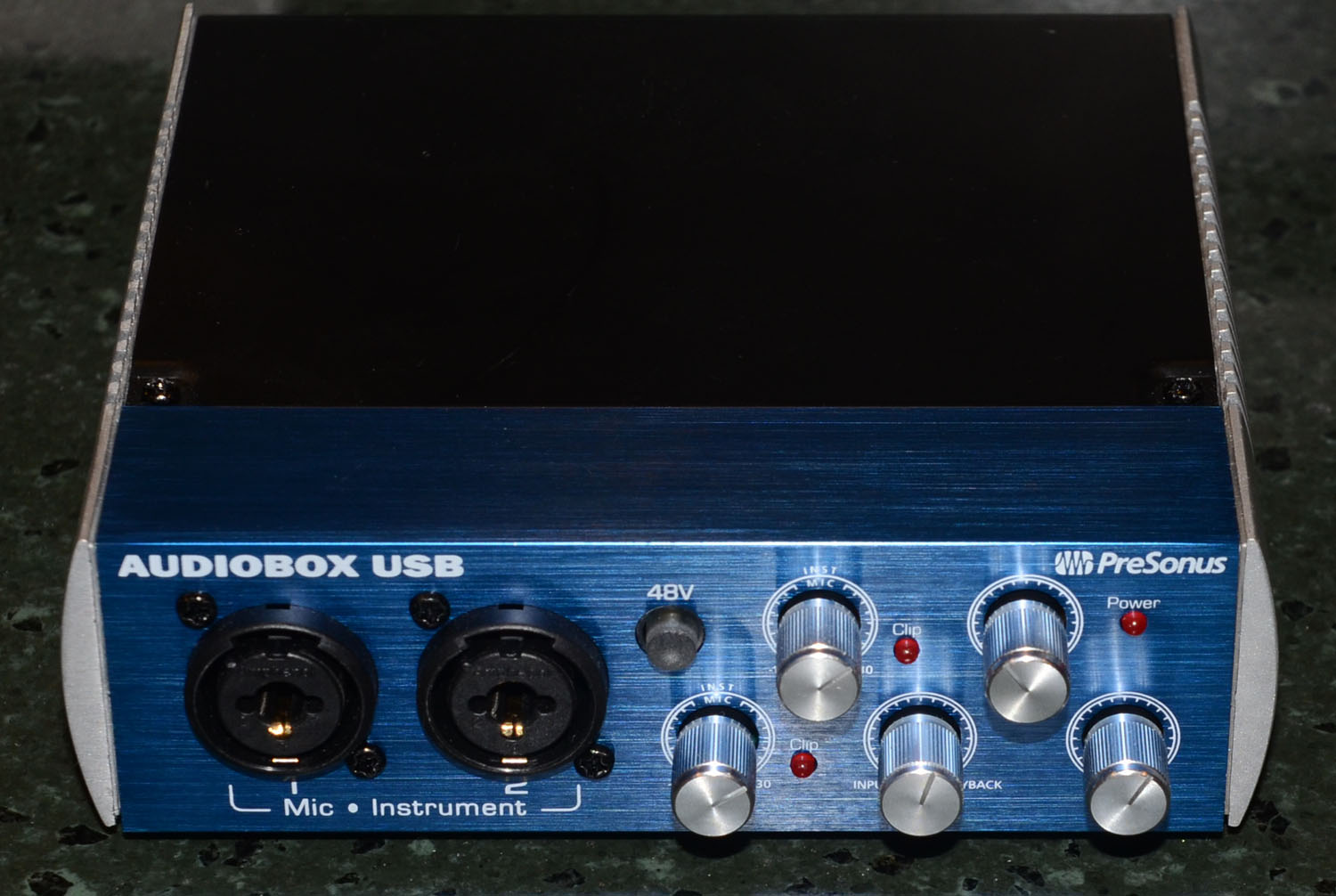

Download one of the many freeware FFT programs, install it, configure it, and run it.

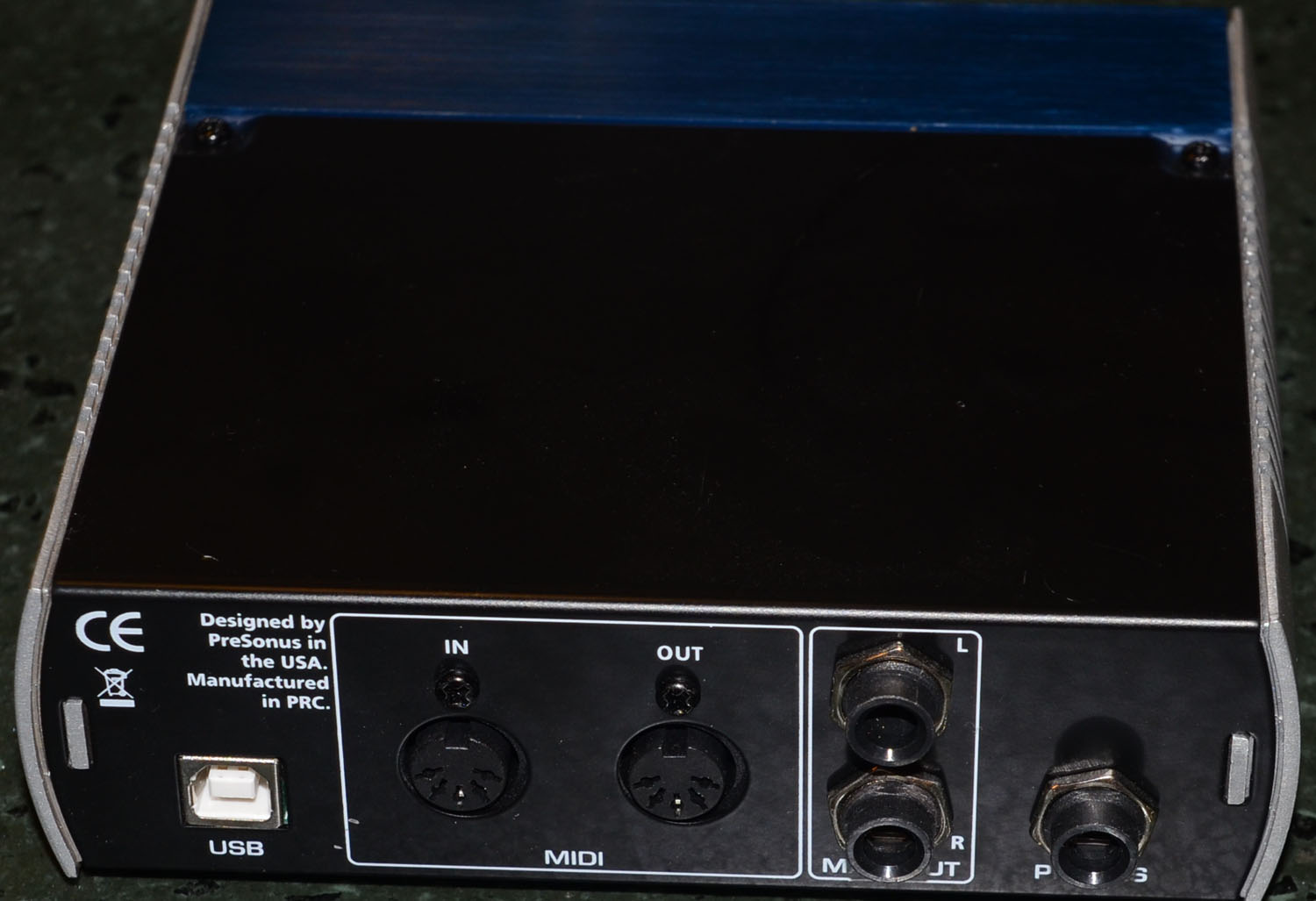

Sure there is. The Presonus has a line output, and you configure that to be your signal generator output.
This is my Presonus USB interface set up to run the Audio Rightmark program which is a good starting point.
The Blue and Yellow wires run back to the TRS line out jacks on the back of the Presonus. You can crib the knob settings out of the enlargement of the photo.
The Rightmark program is configured like this:
All I had to do is select the input and output devices and sample rate, etc. shown in the top two lines.
I press the button with the red loudspeaker in the "Run tests box" and I set the level controls on the Presonus appropriately:
I press the "Start Test" Button which takes a minute or so to run the test and enters a dialog box to manage the test report.
If I press one of the buttons on the right hand edge of the report management window, say for "Frequency Response" I get this:
Once you get the Rightmark program working its easy to move up to more complicated programs like VA.
