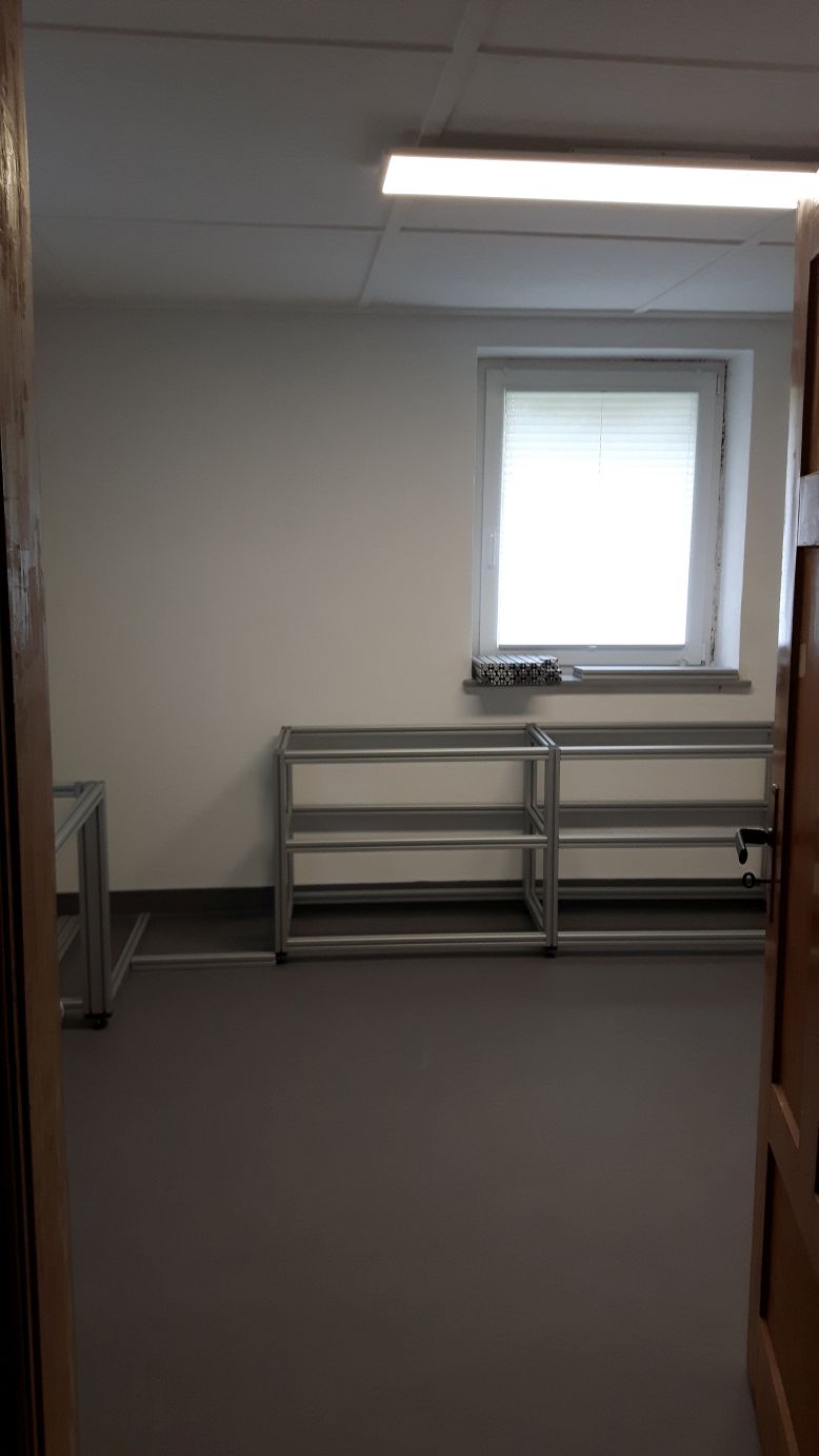

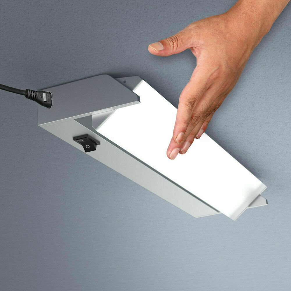

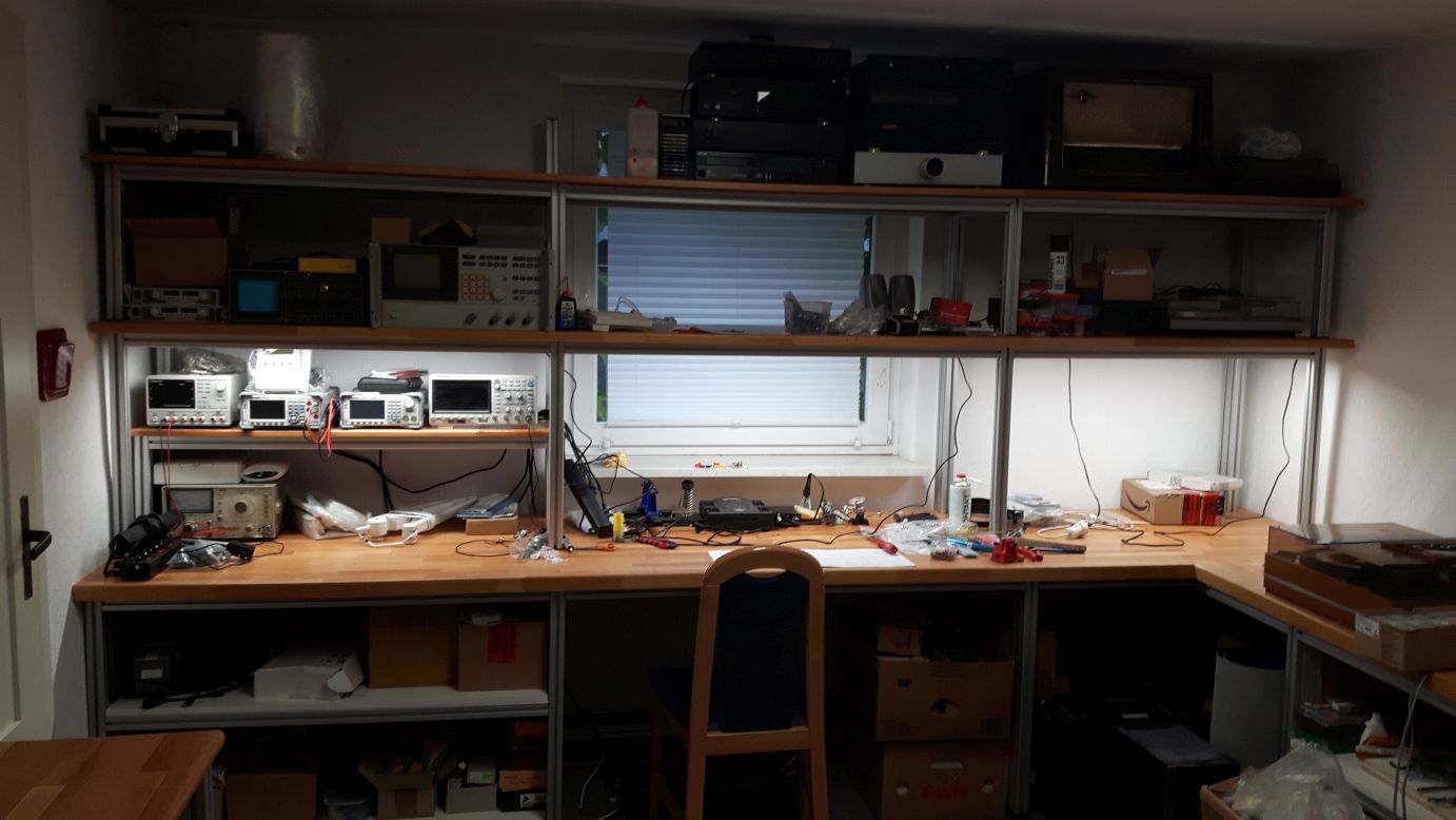

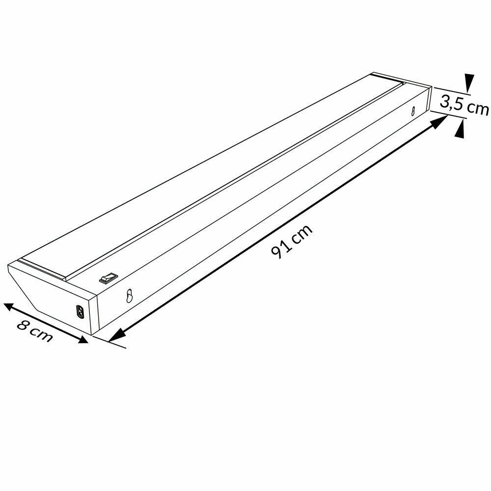

in my lab I use three tiltable LED lights mounted below the upper board of the desks.
They can be daisychained for reduced cabling, but feature an On-Off switch each.
This way there´s plenty of direct and diffuse light without blinding someone.
As major light source for the room serves a single 30x100cm large LED light panel.
jauu
Calvin
ps. notice the big red light switch to the left ;-)
In the meantime I mounted aside that switch a small casing with a big red emergency kill button on top (FRDs and all that stuff inside to switch off each phase separately and also added a fire extinguisher)
