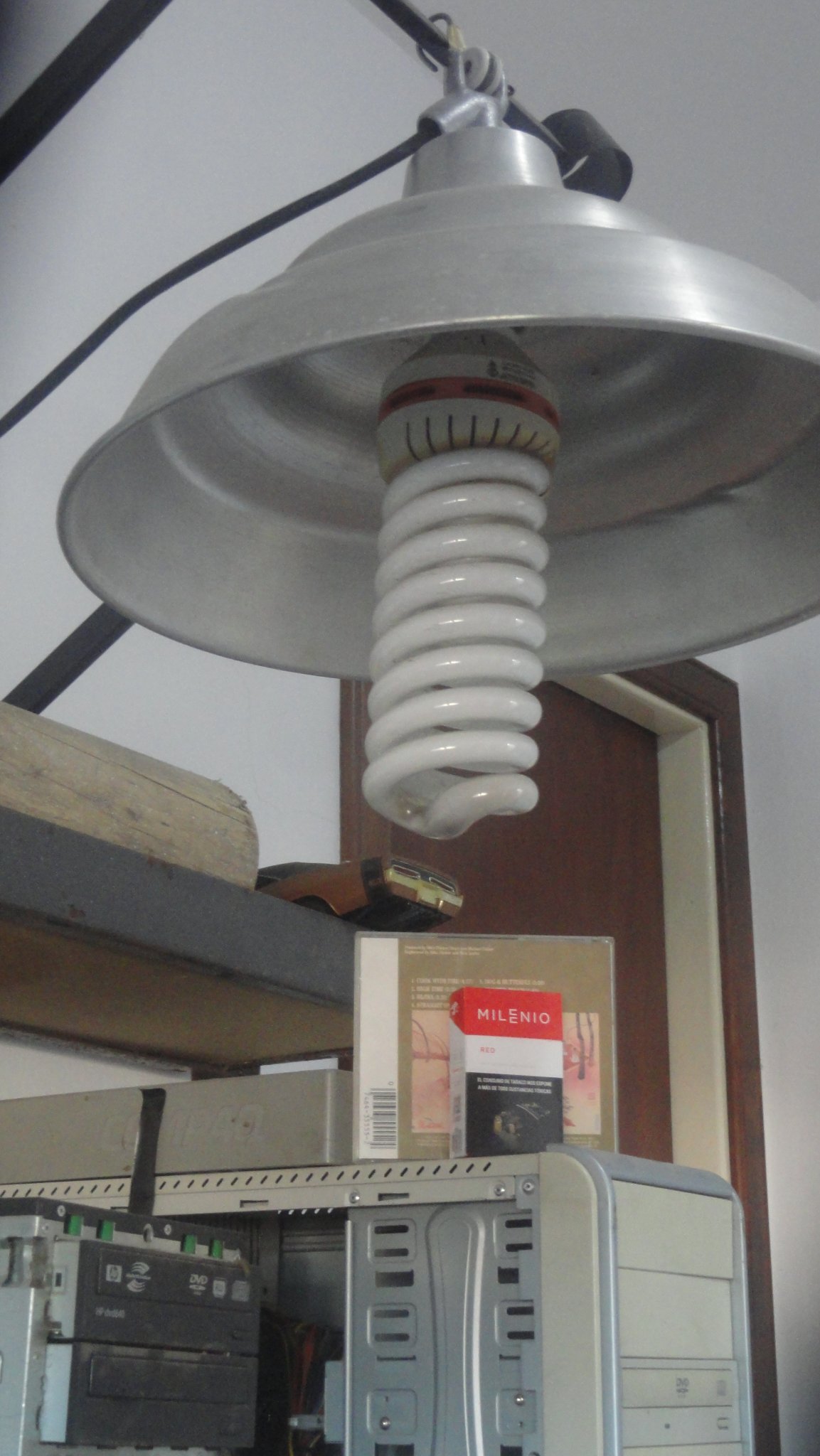

After trying several types of bulbs & fixtures, I found this to be spectacular. An E39 base, 220V, 105 Watt "Grow-light" running at 6400 Kelvin. I modified this reflector/shade assembly to accommodate the E39 base...a single is OK, a pair or trio will be like bringing in the Sun to your workspace.

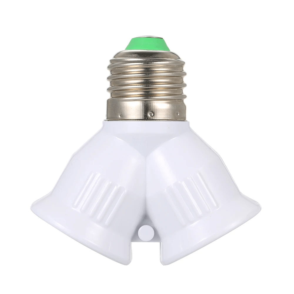

For a real cheap bright lights, you can Y-adapt a bunch of cheap (Dollar store) LED lamps. These will be limited to 800 lumens each, but 4+ will be fair bright.
Y adapter

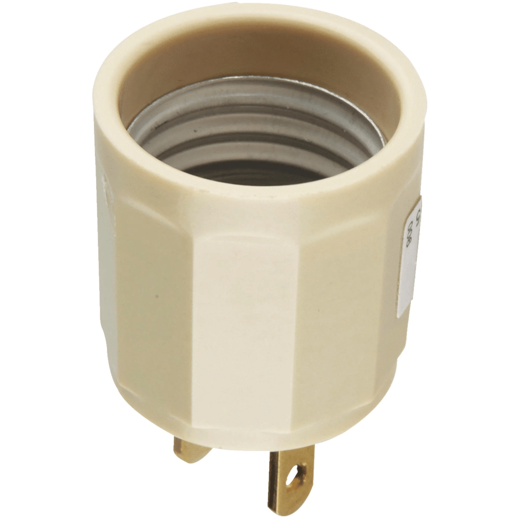

I also use a lamp +2 outlet adapter with two outlet-lamp sockets for a 3-way T lamp. lamp-socket adapter
This is a bit ugly but it's fine for the garage and the basement, and it's cheap.
