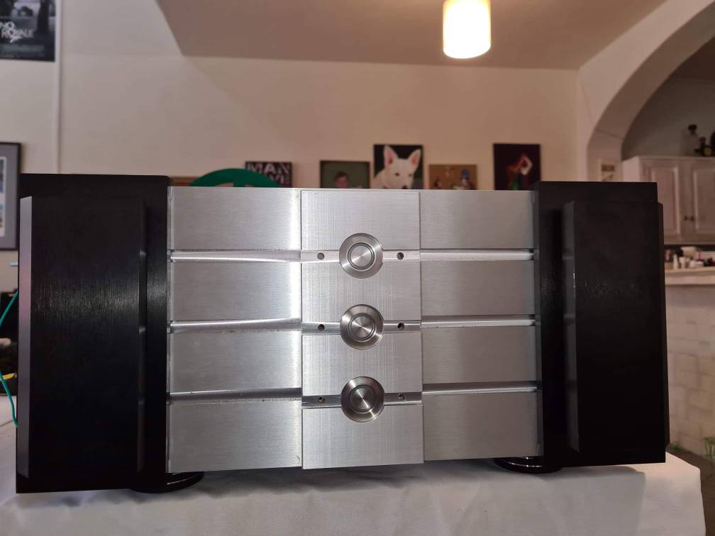

Its been a while since I created this thread, but I'm making some chassis now. I went around and around deciding what alloy of aluminum I liked best since I am doing bends to form the front and rear panels. 6061 has a much too hard of temper for bending so I settled on 3003 alloy. The 3003 also cuts up better in my CNC machine (which is really made for wood, but can handle aluminum). As for the finish, I have always had a love affair for bare aluminum or anodized aluminum uncolored. I love the look of the old Sansui aluminum face receivers of the 70's.
As for finish I tried many different things... But for ease of getting a job done in a reasonable amount of time I've settled on this:
I orbital sand the plate (before bending and after cutting with 800 grit. I go direct to 800 because I found starting with a courser grit left too much scratches that I had to just get rid of with 800 anyway. I sand the hell out of it with 800 for a fairly long time to ensure its consistent. Its also important to pull the sander off the work flat, not tilted or it will leave a scuff. After the sanding session with 800 I wipe off the work with paper towel. Then I put a scotch bright disk on my sander (a 5.5 inch random orbital) and I buff it well with scotch bright. This last step really gives me the patina I want! The Scotch Bright pad "dulls out" all the 800 grit patina and leaves it with a nice pearl finish I'm after. I did try going to 1200 grit in my trials but found that I could not get a pearl-like finish, 1200 grit begins to approach a mirror finish which I dont want. Right now I'm not anodizing nor am I putting on Cerakote clear for protection. Just going raw to see how it holds up. If I find that its not durable enough I may use Cerakote on other projects.
When I get more examples I'll post a photo.
