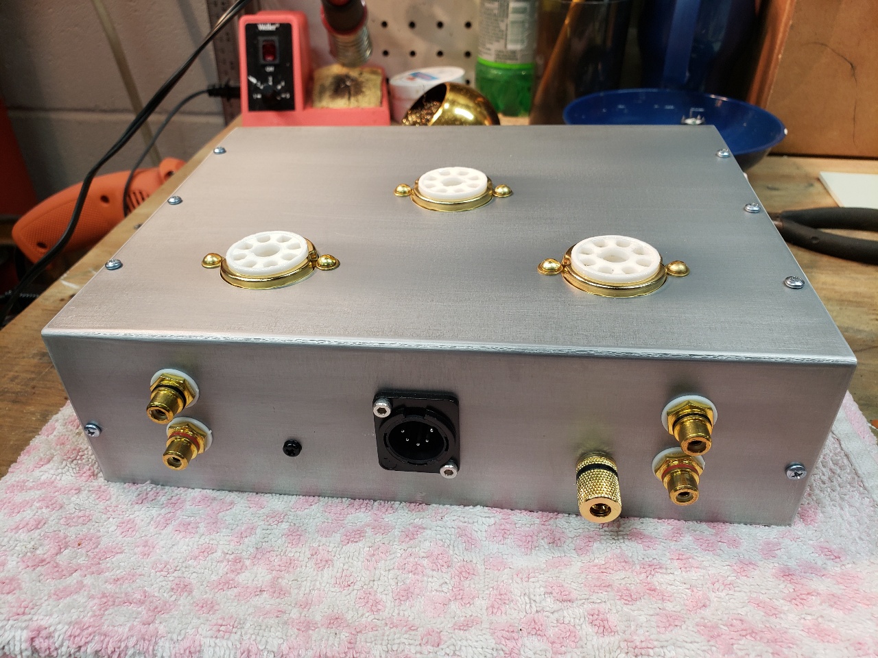

For the home store finish you can try soaking the aluminum in a lye drain cleaner solution, rinsing, then soaking in muriatic acid and scrubbing with a brush to clean then rinsing again. That will get you a frosted finish you can cover with clear. Depending on how long you leave it in the lye you can get rid of small scratches etc. The black smut that develops in the lye is probably better removed with nitric acid but that stuff is expensive.
Make sure you do it outdoors and wear proper ppe. The bath in lye releases hydrogen gas so keep well away from an ignition source.

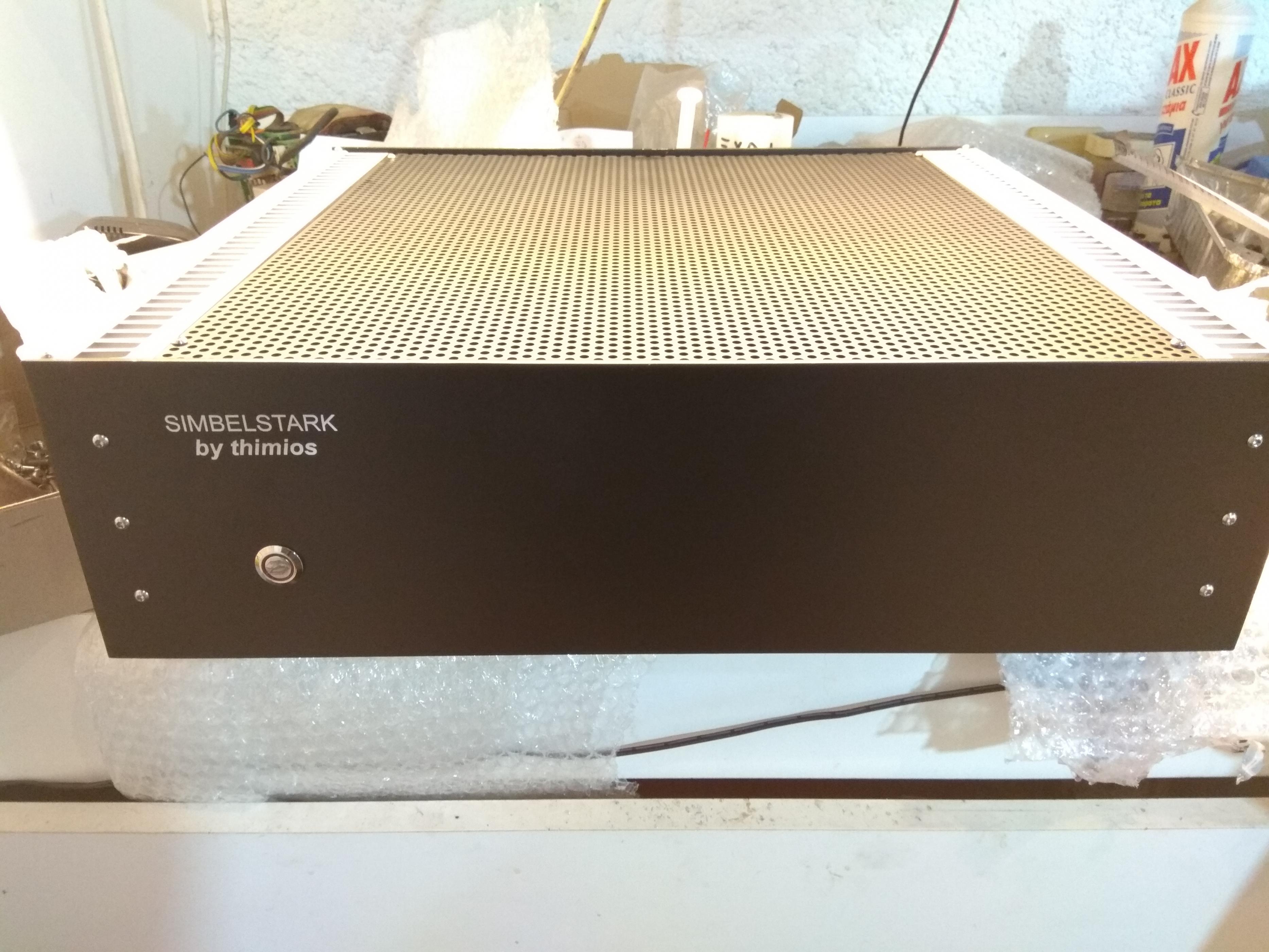

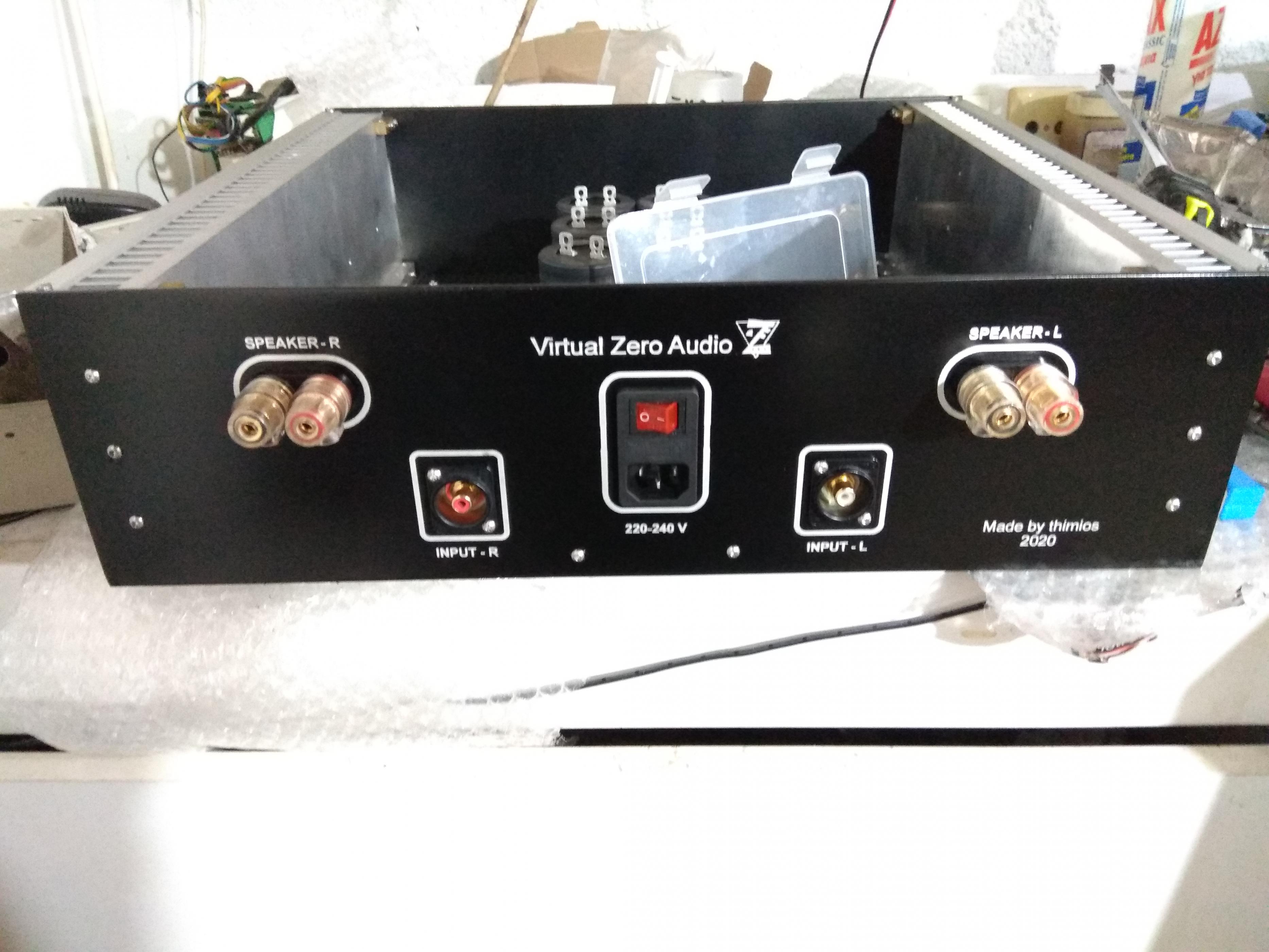

I start with one coat of good quality spray paint, and I painfully found Krylon to be the best option. The panels are painted light or, better - white. Then print the label on a special waterslide decal paper. Thin coat of clear polyurethane (again, Krylon is great), dry until it does not stick to the finger at all. Cut out, slide on, use soft cloth to get water bubbles from underneath and dry out for a couple of hours. Another coat of polyurethane to hide the edges of the patches.
Do you use laser or inkjet waterslide?
Inkjet. Printing on HP inkjet printer with 'Other glossy paper' and 'Best print' settings. It needs to dry out on its own before coating with polyurethane, forgot to mention that!
I cut out the decals using my wife's craft exacto knife and her rubber craft mat so no visible rapture to the edges is typically created. Krylon stuff is also true transparent, the other brands could be yellowish and multiple coats may end up changing the looks.

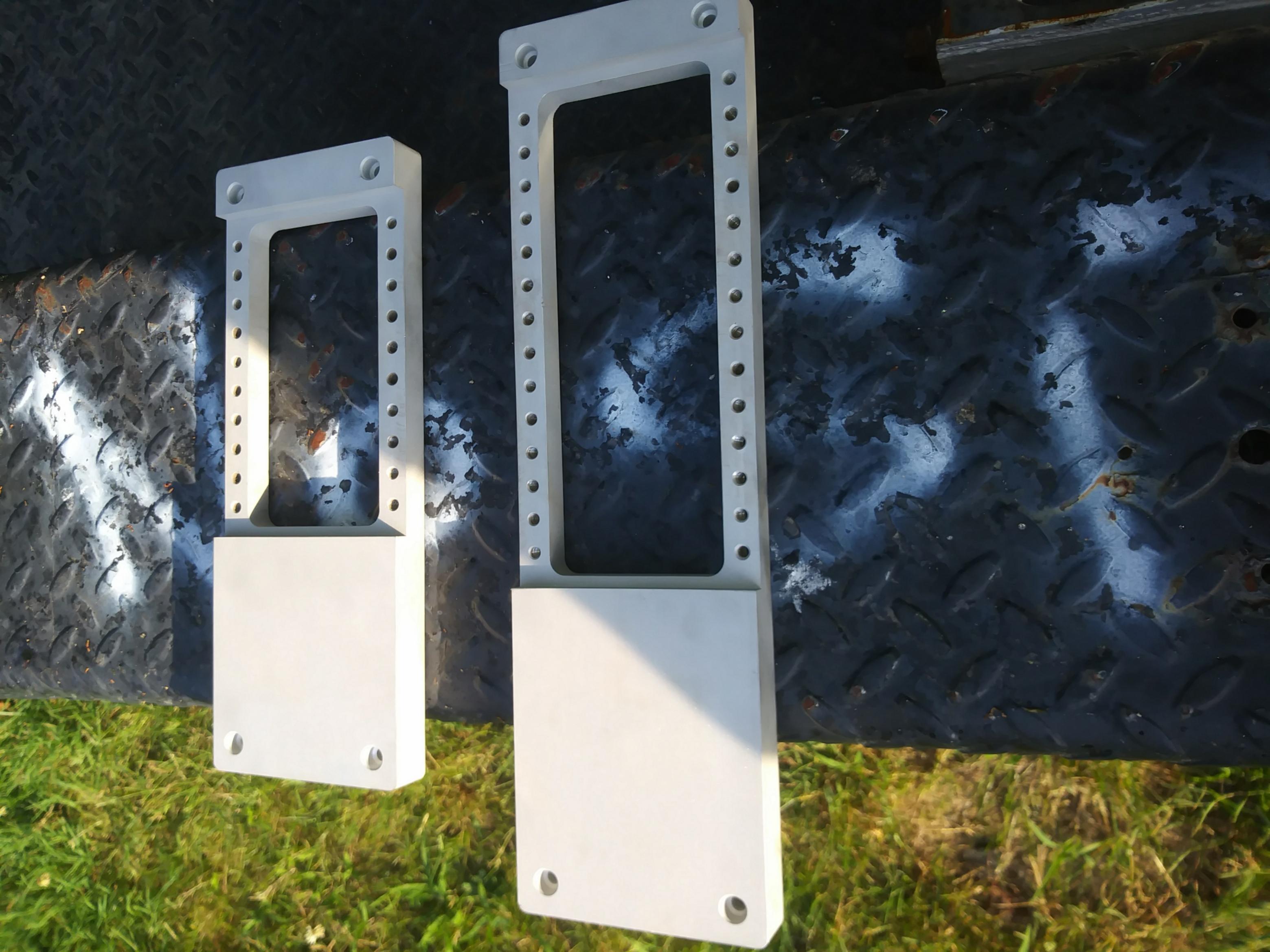

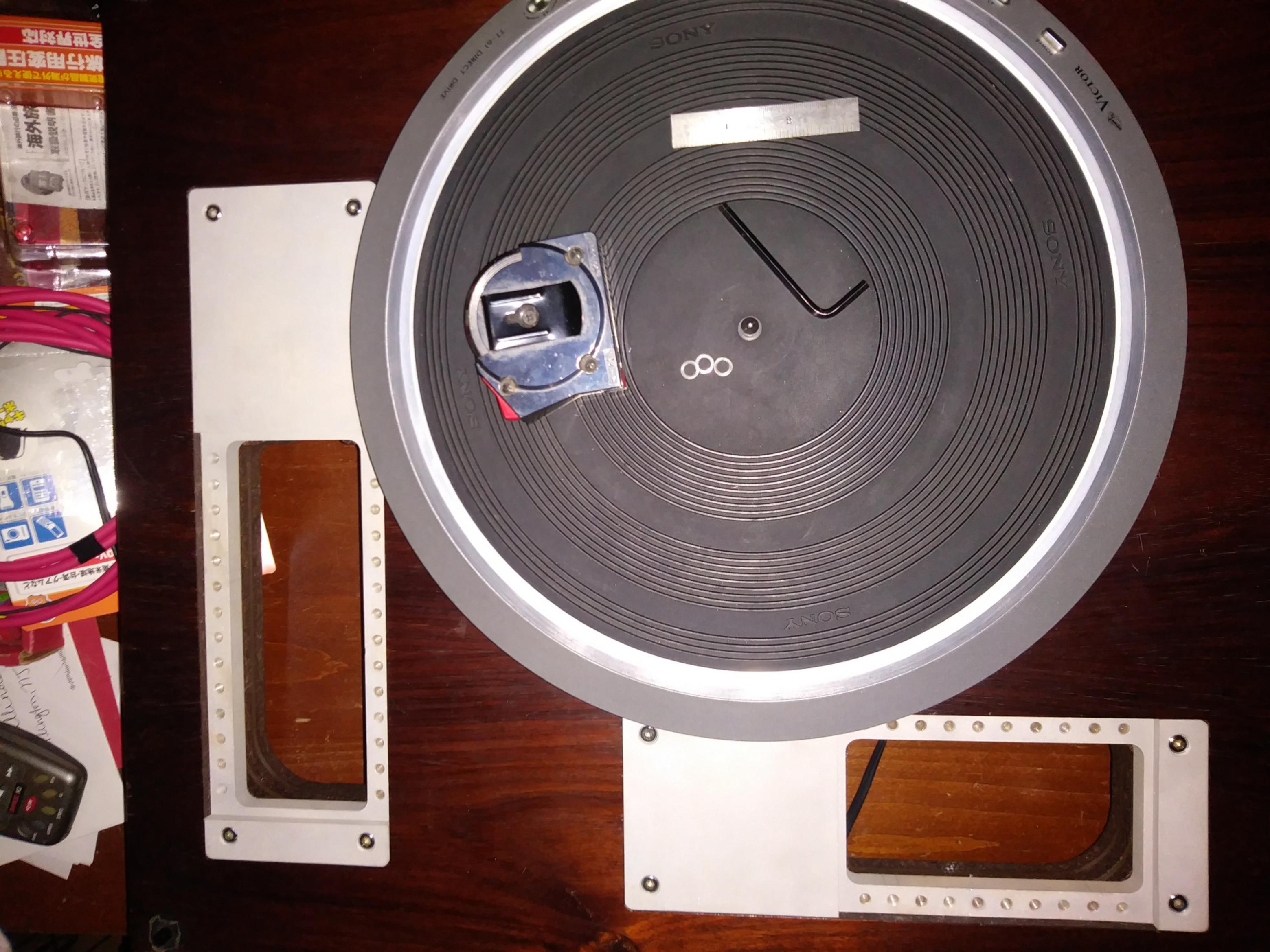

I'm building up a Victor TT with the two arm constrained layer plinth. I didn't want to use the original wood arm boards as they are hard to find and pricey so I built my own. Made the main armboard from aluminum and it will hold smaller aluminum plates to attach the arms to.
I finished the aluminum by glass beading them in a blast media cabinet. Gives a very nice smooth mat finish.
