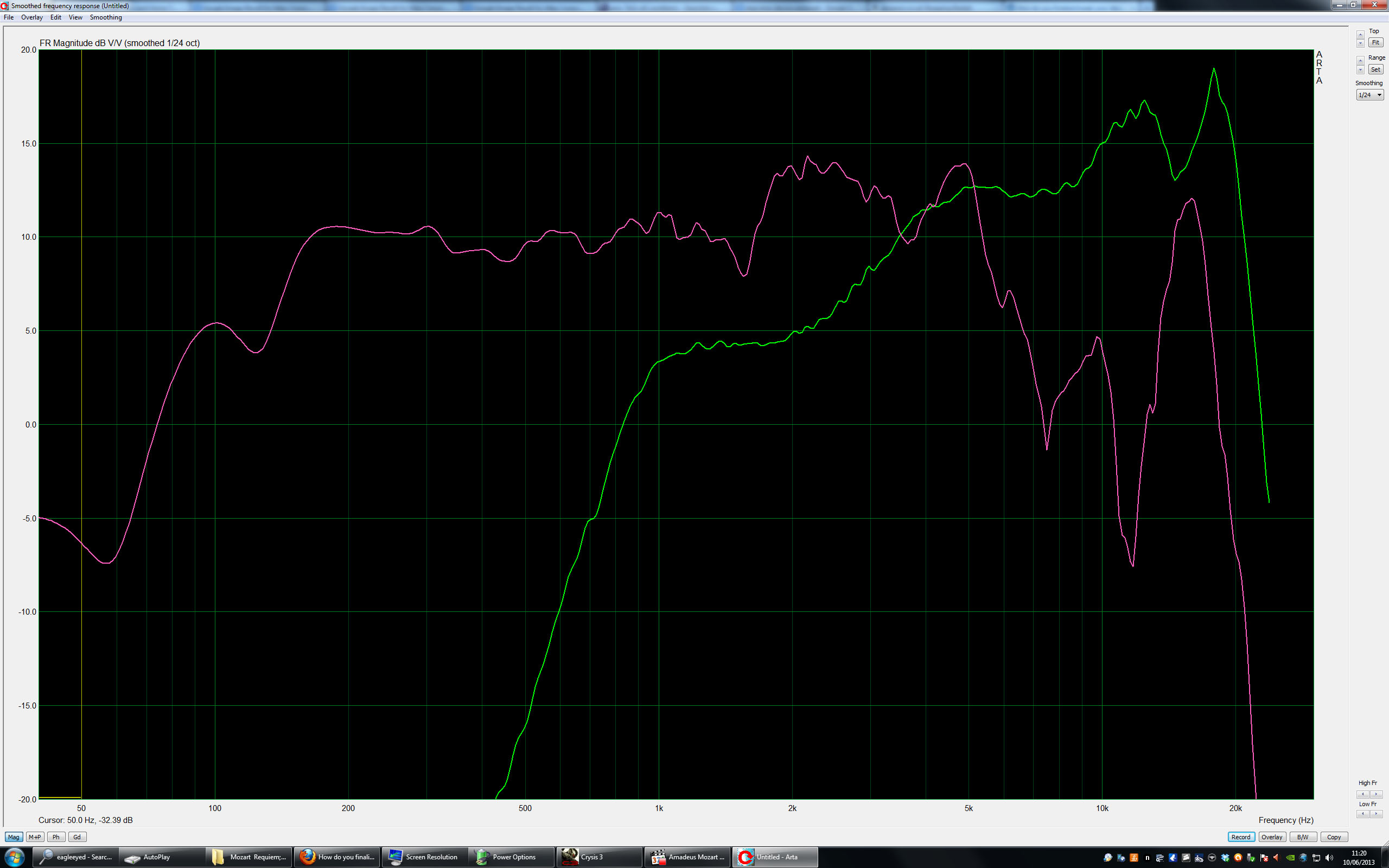

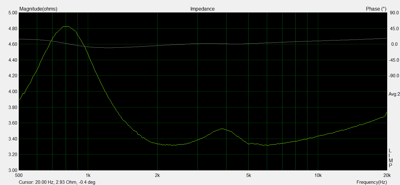

Sorry, that tweeter plot was a bit kak, made a better one fore y'all, please note this one is done with a calibrated resistor value
yeah I was using stepped sine, i'll go and try noise now.
.....I presume I need all 100 measurements to get a decent average?
When conditions are good, stepped sine is preferred. Averaging helps when you are dealing with noise, but it's also necessary for dealing with the shortcomings of reproducing and separating this band of noise.
Often, three to six averages will net the bulk of the result.

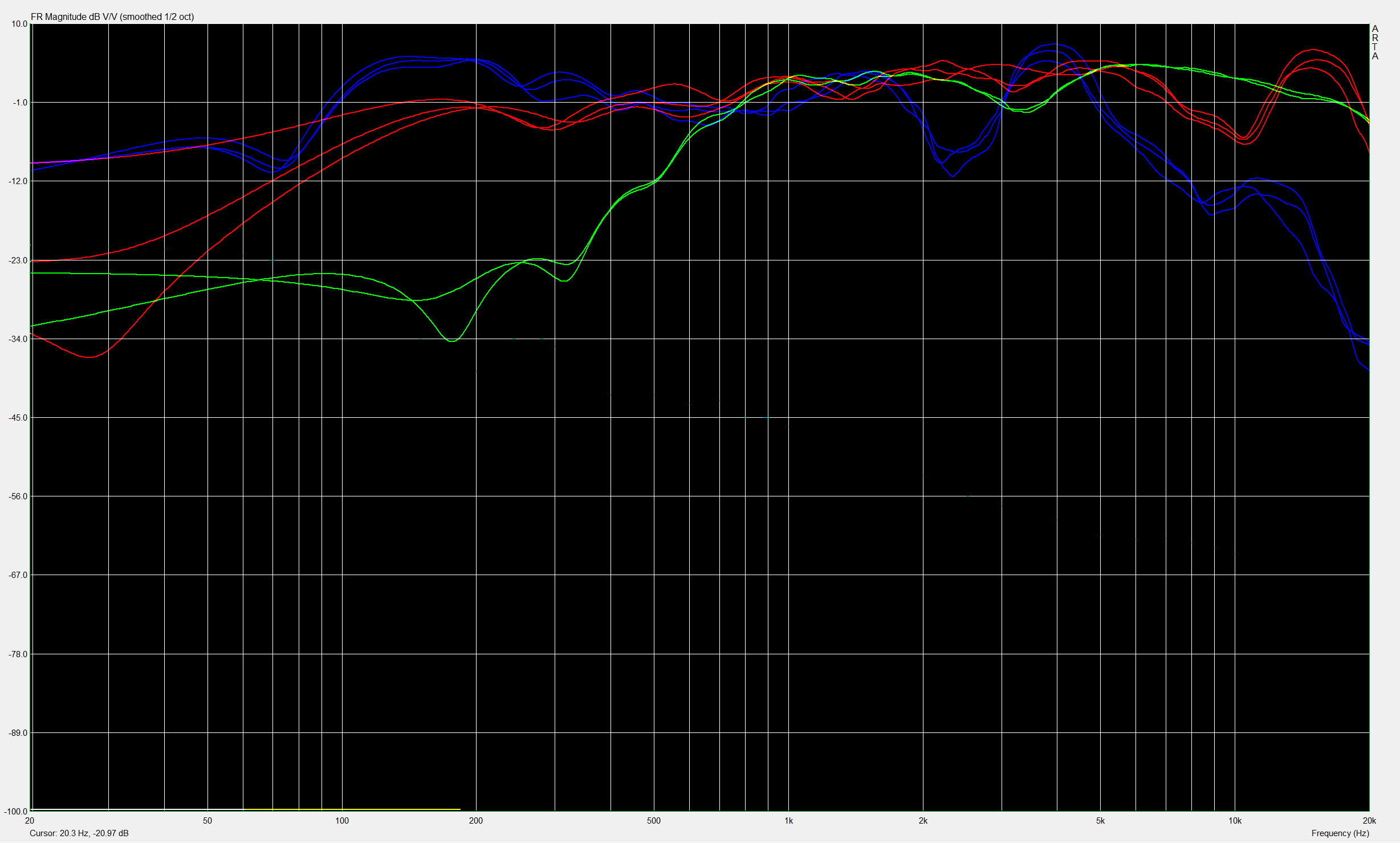

Here's an image of the frequency sweep response of the drivers inside the cabinet, measured at 1m on axis horizontally, midway between the tweeter and mid woofer horizontally.
I'm having a lot of trouble with integrating the tweeter, the 'dip' at 3.5k is proving difficult to get rid of, as pretty much any filter network I have tried has resulted in a peak from about 4k-10k (ish)
Any suggestions on what topology you'd use? should I be considering LCR/CR pads?

A dip at 3.5k is a pretty good problem to have, but if that's what your response looks like at 1/2 octave smoothing, I think maybe you need to revisit the measurement instructions/tips that I and another person left here for you. With a tweeter, you should have no trouble at all getting a clean graph with 1/24 smoothing. Also, you should not really be seeing any variation if you're not moving the mic (is that what the overlays indicate?). Use a few more averages if you're using the MLS signal.
Dumptruck - thanks for keeping the thread updated with advice, it's been a great help.
I'll have to re-visit the measurements procedure and work out what I'm doing wrong, the overlays were from different room positions, I was getting very ragged response curves from 1/24 smoothing so obviously doing something wrong, though I was using sine sweeps not MLS, so I'll try and sort my measurement technique out.
I tried the speaker as a 3 way with 1 or 2 bass drivers, as a 2.5 way and as a 2 way without the bass woofers.
Building the 2-way is very easy and produces a great sound, but when I add the high pass filter to the mid it seems to raise the response towards the top end, and the bass response from the woofer although good seems to be focussed around 100hz.
At this point I'm thinking i need to sort out the cabinet tuning for the bass woofer before I try to re-integrate it into a 3-way, then I expect to keep it as single bass, mid and tweeter. When I played with the crossovers yesterday (most of the day, again) I managed to achieve a flat response from 100hz to 20khz, give or take about 5db, however the overall sound was a little bit tinny/ringy (for lack of better words) I then tried rolling of the trebble a little, so the overall response curved down by about 10db between about 500hz and 15kHz. That was a lot easier to listen to, but also sounded dull and a bit life-less. My hope is when I get the bass response up to what it should be the overall sound of the speaker will be less bright, but If I fix my measurements then hopefully that'll allow me to see the cause of any audio discomfort in the trebble.

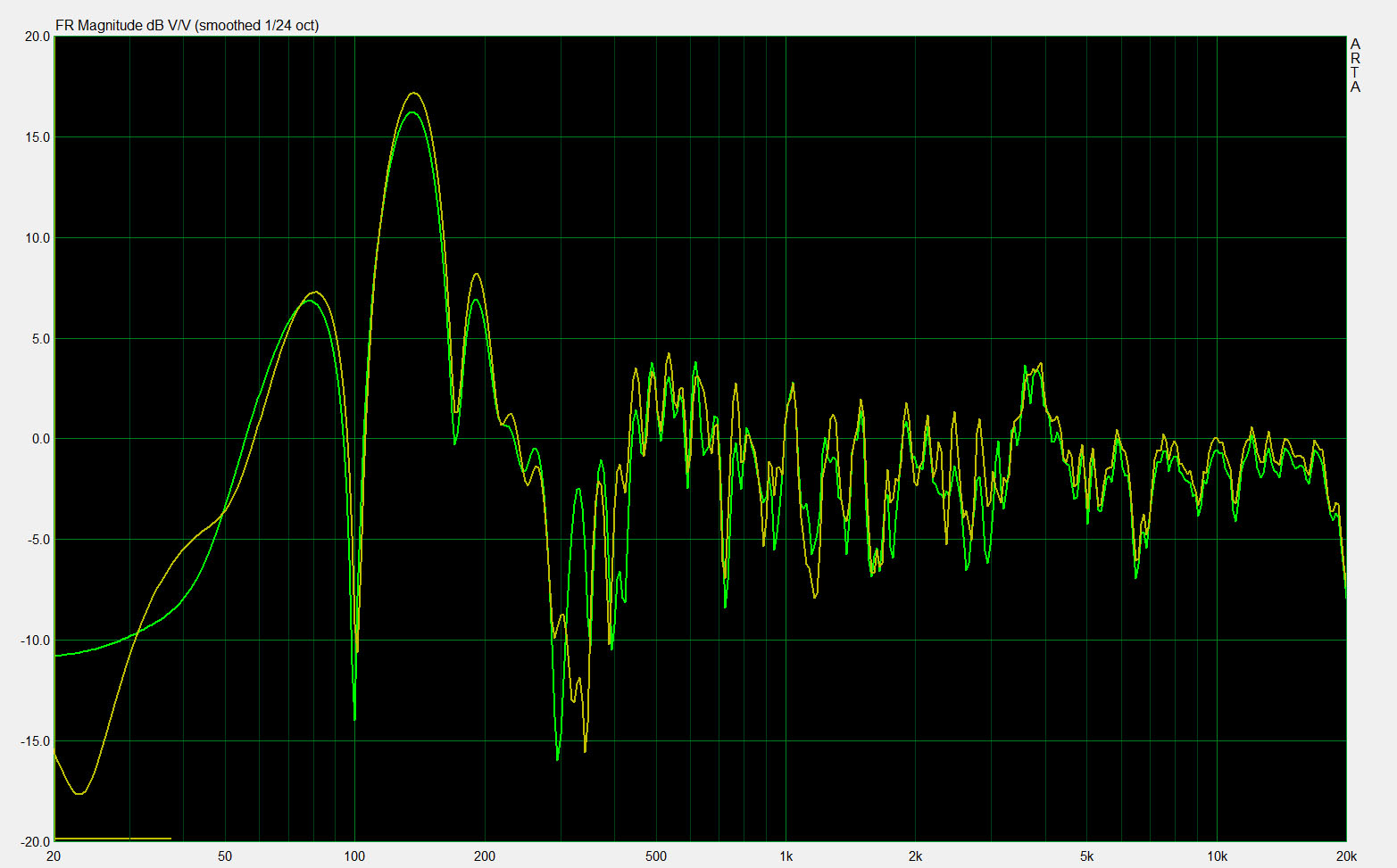

Ok, so I think I'm getting better measurements now, this picture shows combined MLS (avg=25) and sine sweep for the speaker in current form, this is with two bass woofers.
The extra bass woofer is obviously making the tuning (or non-tuning) of the enclosure worse, as the previous small peak above 100hz grew significantly when it was added. The enclosure is approx. .33cu/ft, with a 5cm dia 12cm port.
Any tuning suggestions would be well received, though I am trying to understand the loudspeaker cookbook better in order to improve the tuning. I thought the problem was the port was nowhere near long enough, but crude tests with longer ports don't seem to improve things at all, so maybe i need a shorter port???
I'll get FR again with a single bass woofer later.

One last note: I tried these at low volume levels with simple first order xo's lastnight, expecting them to sound worse, though they were arguably better, is this due to the low listening levels or something else? (I'm guessing all the advantages of using 2nd/3rd order slopes on the xo kick in at a reasonable volume)
Some people think that only first order xo's, or really high order, gives the best musical presentation. Trust your ears.
Also, as you stated, you acheive flat response if you only use the midrange and the tweeter, but once you add the woofers, it doesnt work. Thats kinda normal. The addition of the woofers adds a whole other dimension of problems.

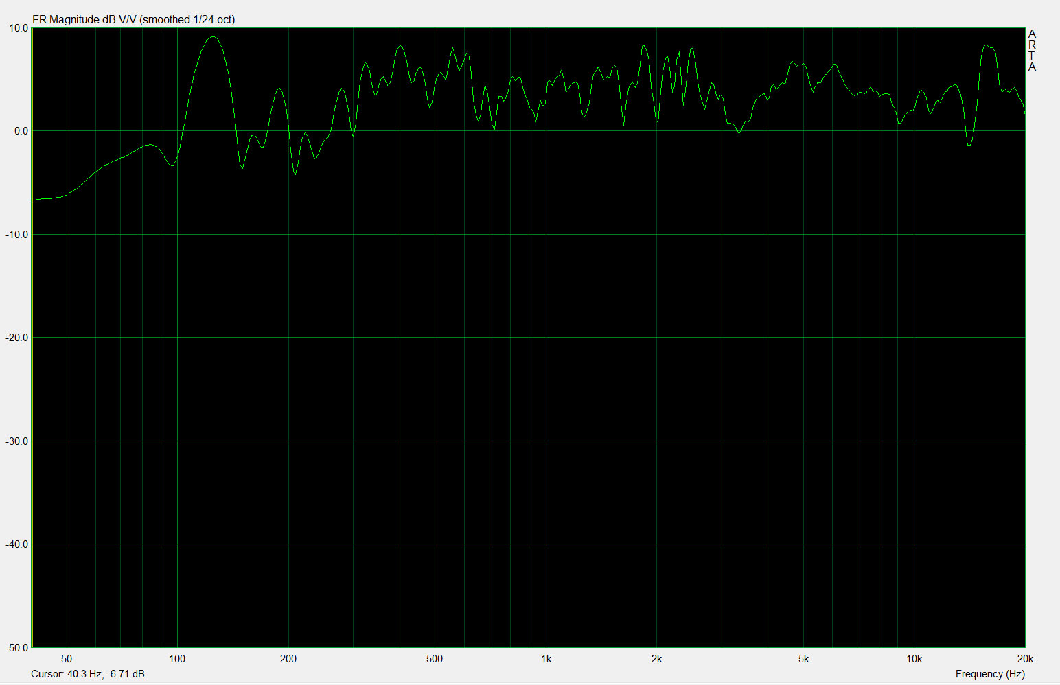

I did a lot of research last night on the XT4 and found out the original crossover was in fact at single order between the tweeter and mid. Currently I'm still running 3rd order on the tweeter, but I've softened the mid pass to a single capacitor and inductor, rather than the old 3rd-order low pass that was going on. Also running an L-pad on the mid woofer now.
Current FR is attached, I'm happy with the measurements and the sound now, so have gone back to working on the cabinet. There's way more baffle vibration than I was expecting, given that the bracing is effectively a shelf from front to back between each woofer. The front baffle was 18mm, with front bracing to be added later (wait for pictures) but I've added another 18mm internally to one cabinet, I'll do the same with the other, finish them up so that I can have a quick AB of alternative xo's then it'll just be a case of controlling cabinet vibrations and finishing off... not long now 😉

A shelf brace can be a good thing to reduce the cabinet's overall (first) resonance. Having them directly behind the woofers may seem logical but closer to the middle of the cabinet gives the greater effect here.
The braces may not, however help much with regards to vibrations that run through the panels.
