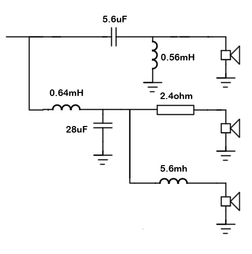

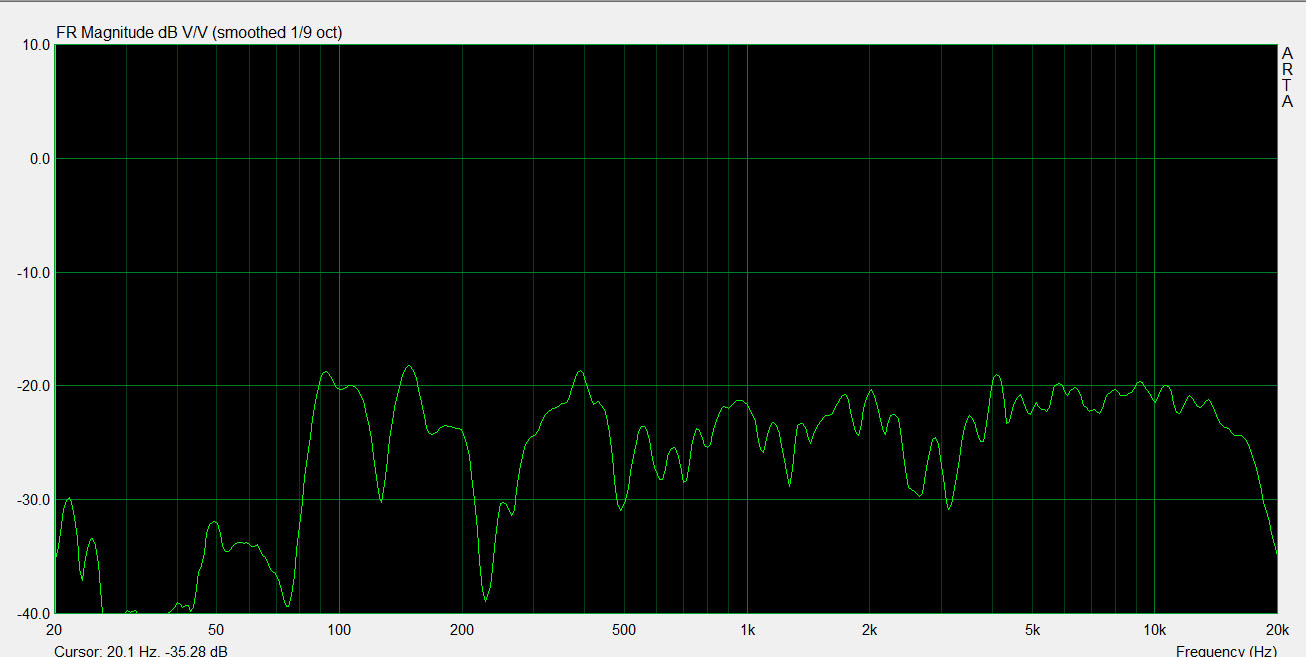

The measurement microphone has arrived and I've been using ARTA to run a few basic FR tests, this lead to a re-designed crossover. (and of course a better understanding of xo design)
Also, I confirmed my suspicion that the mid-range unit is the same as used in the normal 2-way XT-2 speakers. Given that I only have 2 bass woofers, it seemed logical to switch to a 2.5 way topology.

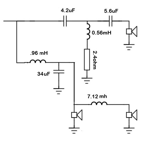

I've attached pictures of the old and new crossovers, which should give a good idea of what's going on, and a FR sweep of the speaker, I'm not too worried about the low end response atm as the cabinet is floor standing with half the front missing whilst I tune the crossovers.

update again.. i was sure i should be able to do better so i spent more time and tightened up the tweeters FR, ended up with a very steep roll off at about 1.7k, (give or take, that's from memory!) and flat (ish) response from there up. The new crossover design is attached, with this crossover the speaker is really singing, just a few questions:
1.The overall tweeter output is much lower than if I just had a high value cap in series, is this normal, and is there a way to regain some output?
2. Is the need for the resistor in line with the parallel inductor on the tweeter network a sign that I've spec'd the value wrong, or is this normal to come across?
Also, the bass driver is much lower efficiency than the mid, which means the mid ends up doing too much bass work and overpowering the rest of the drivers. With the current design this isn't too bad - in fact, I may just order some more resistors and attenuate the mid individually, but if there's another way to help the mid to play ball I'm open to suggestions!
Also... port tuning. This is in a ported enclosure, can I tune the port length with the aid of the measurement mic (maybe measuring internal FR and port FR?) or do I need to learn to do some proper calculations to get the best out of this enclosure? (there is a port in the enclosure already, made form some 50mm drain pipe I had laying around)

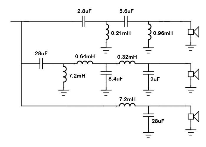

Sorry it's taken so long top get on this, I'm sure all the forum members that have been engineering students will sympathize!

When you use formulas for woofers and some mid drivers, their inductance is as big or bigger than the resistance at the crossover point. You can tame the ringing, harsh result by adding a resistor in series with the capacitor, 2 ohm typically. Avoid a traditional Zobel.

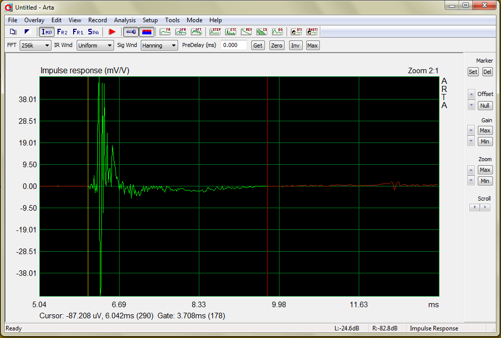

You can take time-gated measurements in ARTA that will be much more helpful.
1. With ARTA all set up and functioning (also make sure you've loaded your mic calibration if you have a calibrated mic), click over to impulse mode ("IMP" button upper-left"), and click the red arrow to record, which pops up the record box.
2. Click the MLS tab (it's a fast type of measurement, good for when you're experimenting). If all the settings look right (you can stay with the default signal length), click "Generate MLS" to start the signal going, adjust volume to sound close to how loud you might listen, and then adjust mic level to get a strong signal bar that isn't banging into the 0dB level. Then, click the "Record" button.
3. Now you've got an impulse, if all went well. Mess with the gain, zoom, and scroll until you can see it well (example below). If you're lucky, your first major reflection will be far enough away that you can see it. In my example, that is the red blip off to the right side. If not, it will be mixed up with the main impulse, but you'll be able to figure that out with some messing around.
4. With the cursor over the graph, click and hold the left mouse button, and drag the yellow line that appears to the start of your impulse, like in the example. Let go, and then click and hold the right mouse button. This gives you a red line. Drag that out to where the graph appears to be settling to zero, but before it increases in amplitude again. If you need a guess, drag it out until the "Gate: ___ms (###)" line at the bottom is around 4ms. The part between these two lines is now your gated measurement window.
attachment.php
4. Click the first graph button at the top ("FR") to generate smoothed frequency response. Now a new window pops up with the response of your measurement. You will notice a yellow line at the bottom, and left of this line (and a bit right of it too), your response will be falsely smoothed and rolled off. That is the low frequency part that is invalidated by the gating, and that is fine. If you get strange ripples, there is probably a reflection. You can close the window, right-click to move your red gate line to an earlier point in time, and then go back to the FR and see what happened. You can also save overlays in the FR window to see what things look with at different gate times.
From the FR window, you can also export frd files to use for crossover simulation, but I'm not getting into that in this post :).

I'm a little surprised nobody has had any direct observations or advice on the crossover design, either old or new. Any 'try this' would be great ;)
Also, the parallel inductor on the tweeter was creating a spike in the FR, any ideas why on this? (the resistor removes the spike and helps create a flat-then-steep filter) It would be good to improve my intuition on that.
My arta response measurements are a little all over the place, but they are reliably so, is this just room interaction preventing a flat(ish) response? the overall sound of the speaker is certainly improving, and without having a stereo pair it's a little hard to tell how good it actually is (for me a lot of the enjoyability of a 'great' speaker is the imaging)
Well, it would help to have impedance measurements, target functions, and actual transfer characteristics. For SPL, you absolutely need raw driver responses (on baffles) and polar pattern. A single on-axis measurement tells you very little.

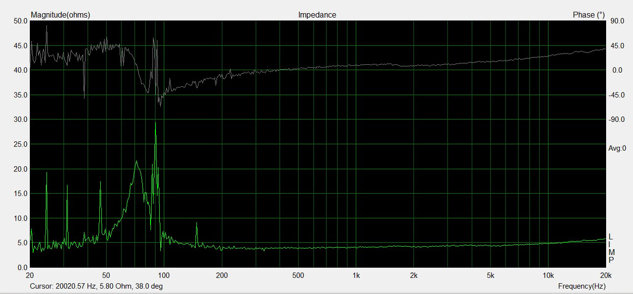

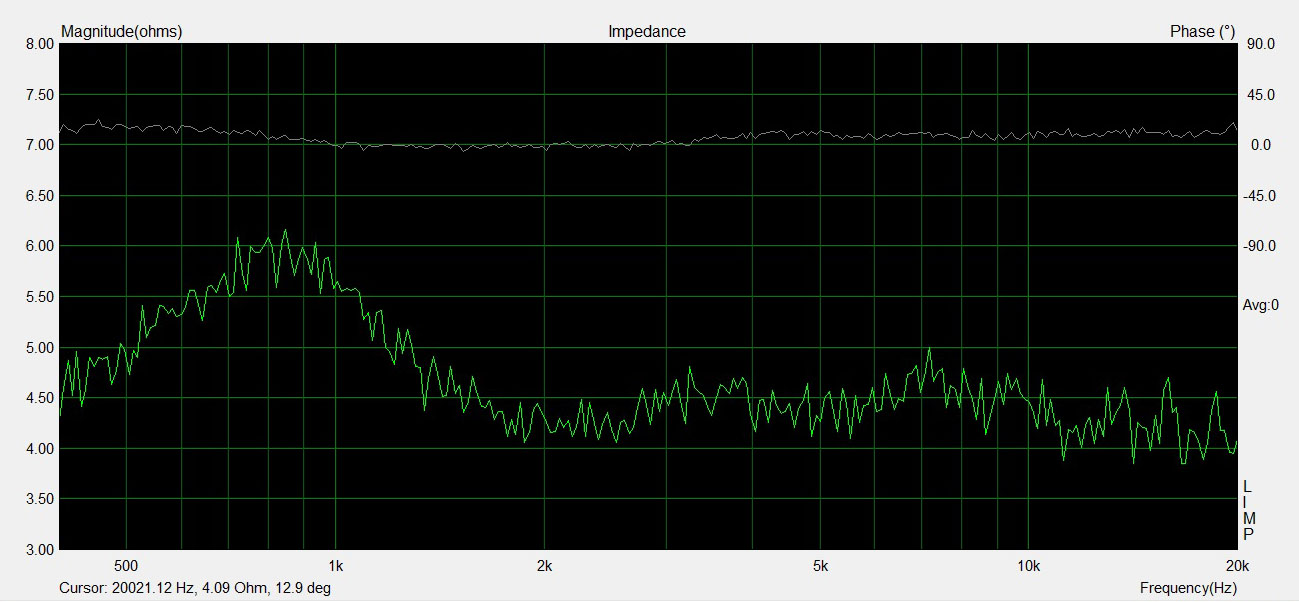

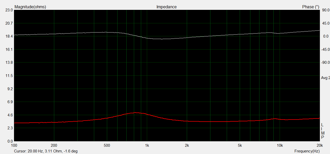

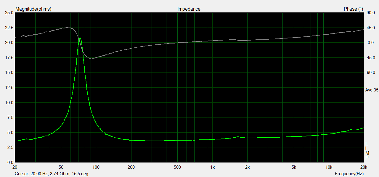

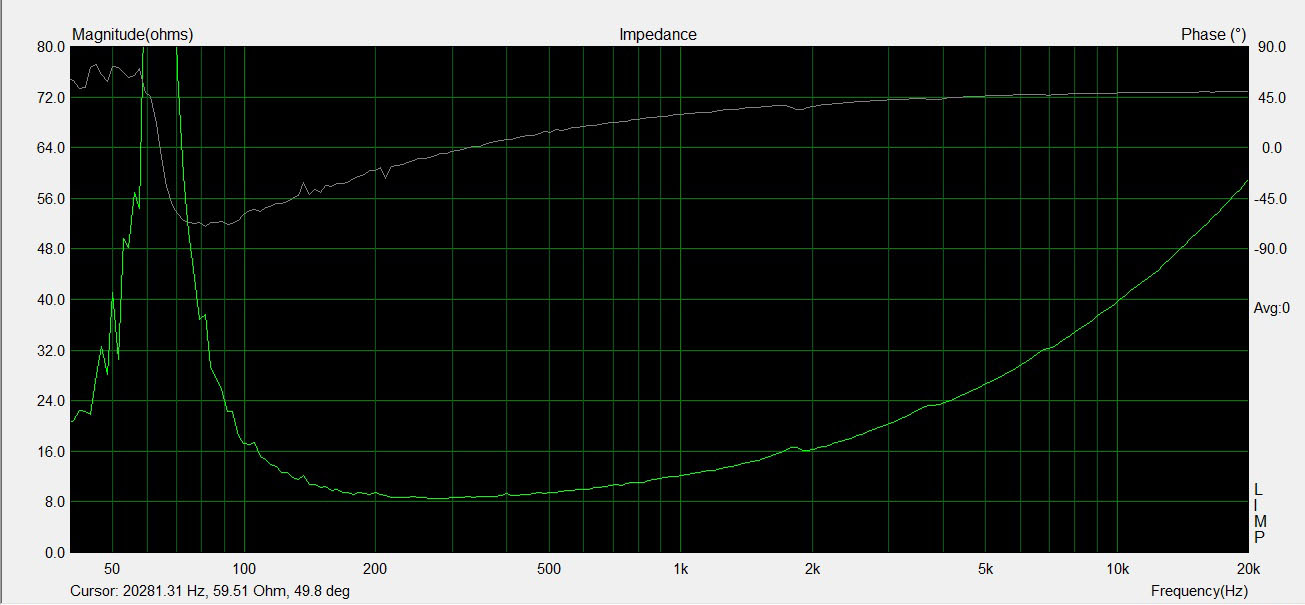

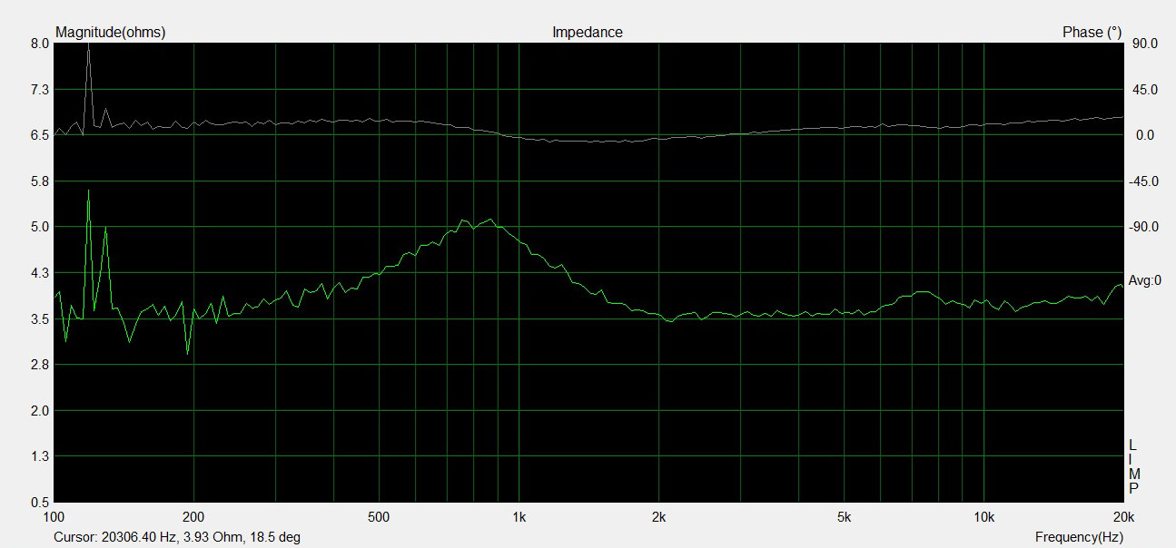

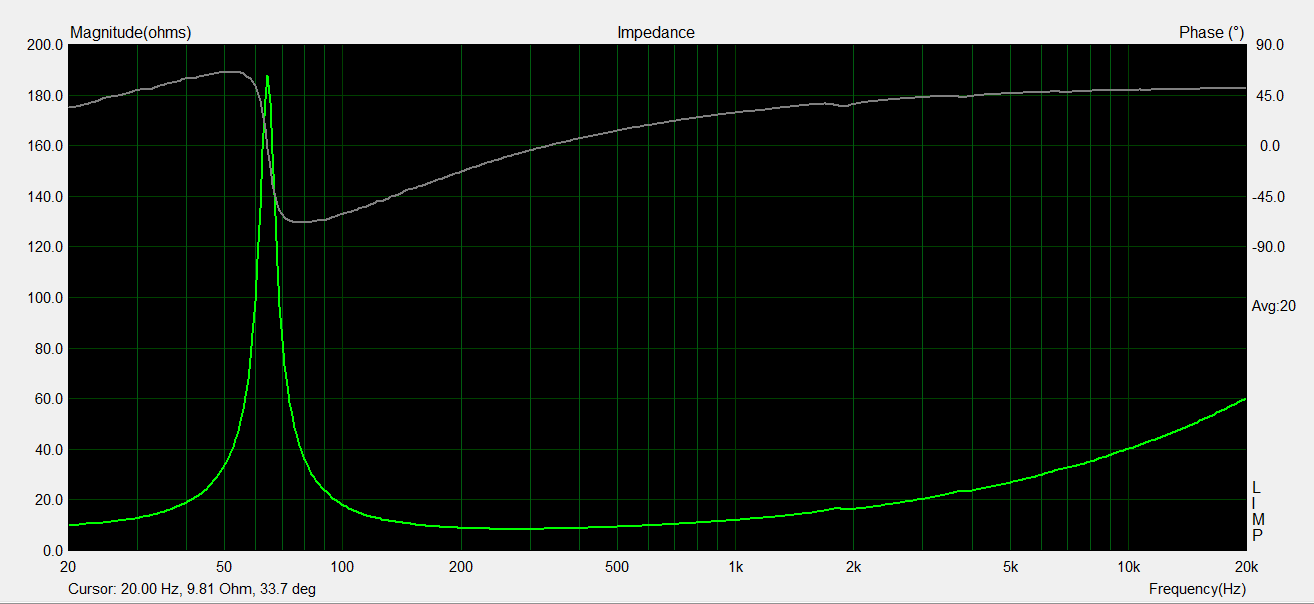

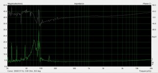

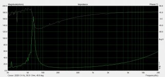

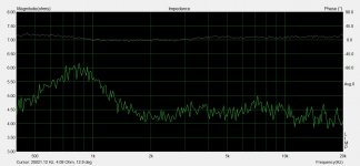

I've started taking measurements today of driver impedance, and they're quite far off what is printed on the stickers which says 8ohm.
Both the tweeter and the mid range seem to have a nominal impedance of about 4 ohms, whilst the bass woofer has an impedance of about 8. Fo appears to be around 850Hz, 90Hz and 65Hz respectively. The phase plot for the bass woofer looks nuts to me but maybe this is normal (pictures will follow this evening I promise!)
With this in mind, it seems I would struggle to get the bass driver's output to match the mid and tweeter without putting a large L-Pad on the pair (for the proposed 2.5 way design) - a problem I was already having.
Would anybody agree that I would be better off purchasing another bass driver, so that I have two per side (as per the original design) in which case the impedance and hopefully output of the drivers would match more naturally? (obv. then I'd expect to switch back to 3-way)
or... is it too early to tell, and should a wait till I have chance to take the on-baffle axis response FR sweep measurements?
Yes. Impedance does not tell you what the sensitivity is.
Yeah, don't know if I said in a previous post that the woofer has much lower sensitivity than the mid/tweeter units, obviously they were meant to be used in parallel in the original 3-way design :( (I only have 3 bass woofers atm)
The impedance plots are attached.
With a ported design, are you dealing with box internal air resonance and port resonance in two separate calculations? or is the box tuned by the port length?
(I know that's probably a stupid question, but it's one I'm finding hard to get an answer to!)

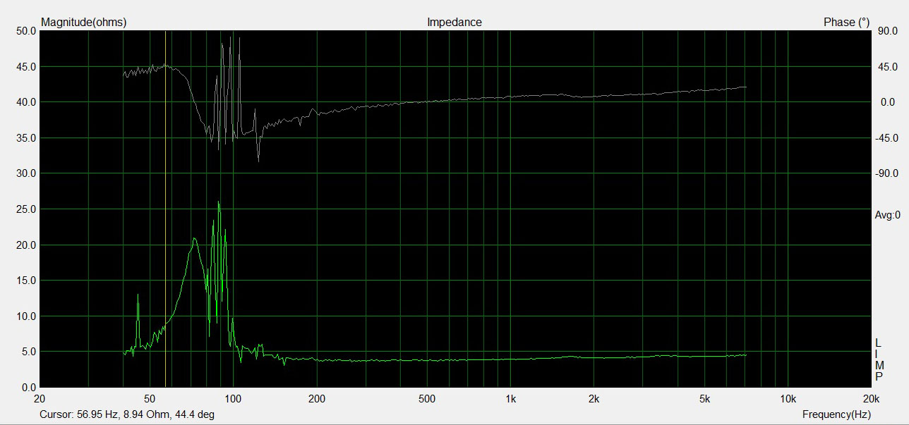

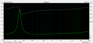

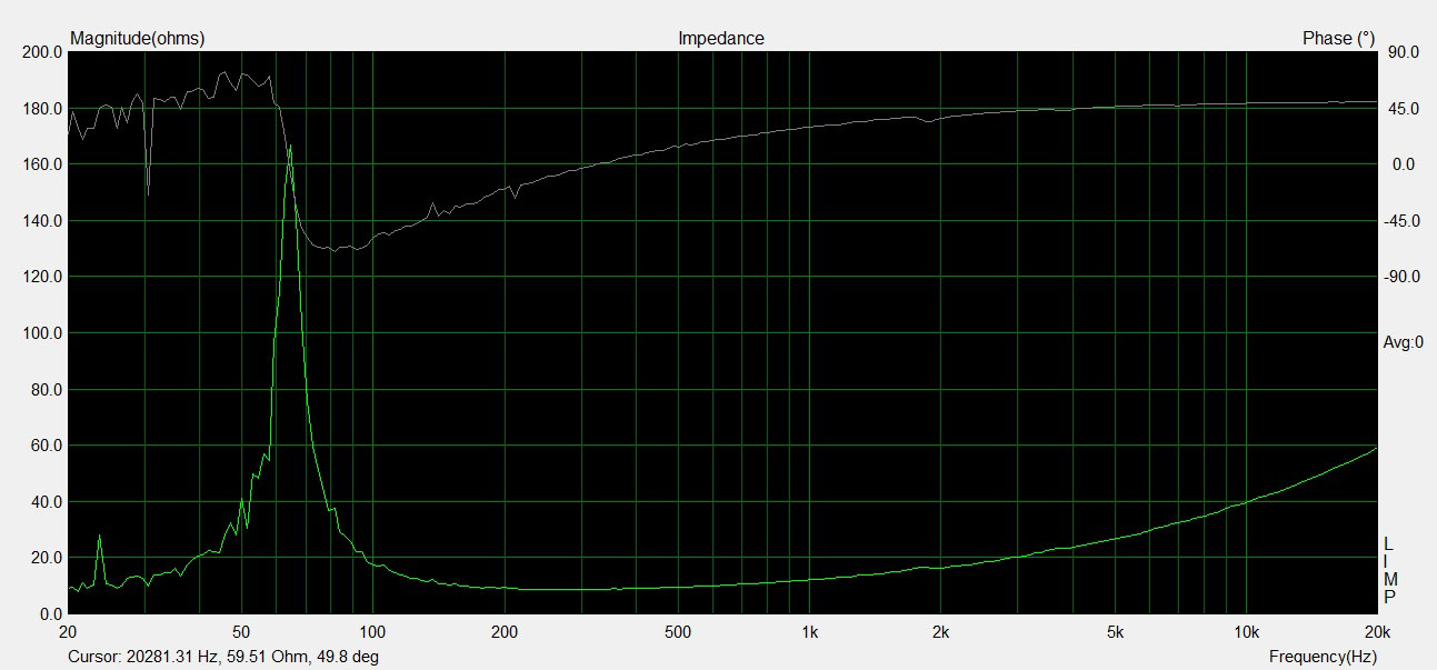

Are you using a jig cable with an amplifier in the loop or just line level? The noise makes me think line level. In any case...
- did you measure impedance of some low value resistors to make sure you're getting accurate magnitude?
- are you doing lots of averages and still getting that much noise?
- are these measurements in the enclosure? what's it like? Either the mid is ported, or that big spike at 90Hz is a severe resonance or measurement problem.
- The phase for the bass woofer is normal for a sealed box - it wraps at Fc where the impedance peak is.
I used line level with a 470ohm resistor.
- I didn't measure the impedance of a low value resistor, but I will do
- I tried multiple measurements but they all came out pretty much the same, I attempted to remove the noise 'by eye' but that lead to the obvious '2nd spike'
- the measurements were with raw drivers sitting on my kitchen table
- as above
Well... that wasn't what I was expecting to learn today but none-the-less, here's some much better graphs :eek:
My 2.4 ohm resistors measure as 2.525 however (unfortunately I measured these after the drivers, so I guess we just multiply the chart resistance values by 0.95 to get correct values?)
