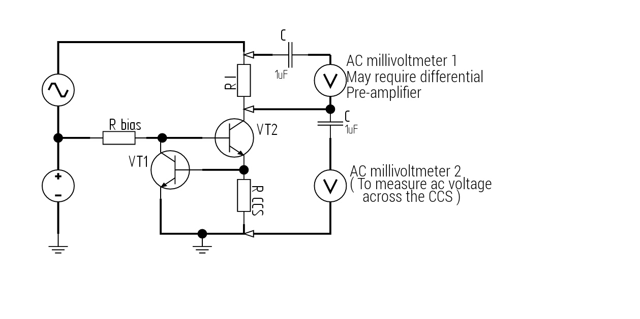

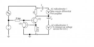

I have redrafted my original scheme to make my intentions clearer, I realize now that it may have suggested that the CCS took its DC power from the combination of the ac and DC sources when in fact the CCS should have been powered from only the DC source. I don't think that this was clear in the original scheme.
R I is the ac current sense resistor, this needs to be small in comparison with the CCS impedance. By measuring the voltage across this resistor the ac current can be found using ohms law. The idea of using a differential preamplifier in this role is taken from Gary Pimm's site. I expect that it would be best to power the preamp from batteries to avoid any ground loop problems.
The CCS impedance is then calculated, again with ohms law, as V(ac millivoltmeter 2) / ac current, as derived previously.

And in the case of the single transistor CCS or the cascode version the base bias would also be derived from the DC supply ( preferably a stiff and clean supply )

Don't know if that is right, but it does look much better.
Now the variable current is applied to the load.
And you can measure the effect that has on the CCS.

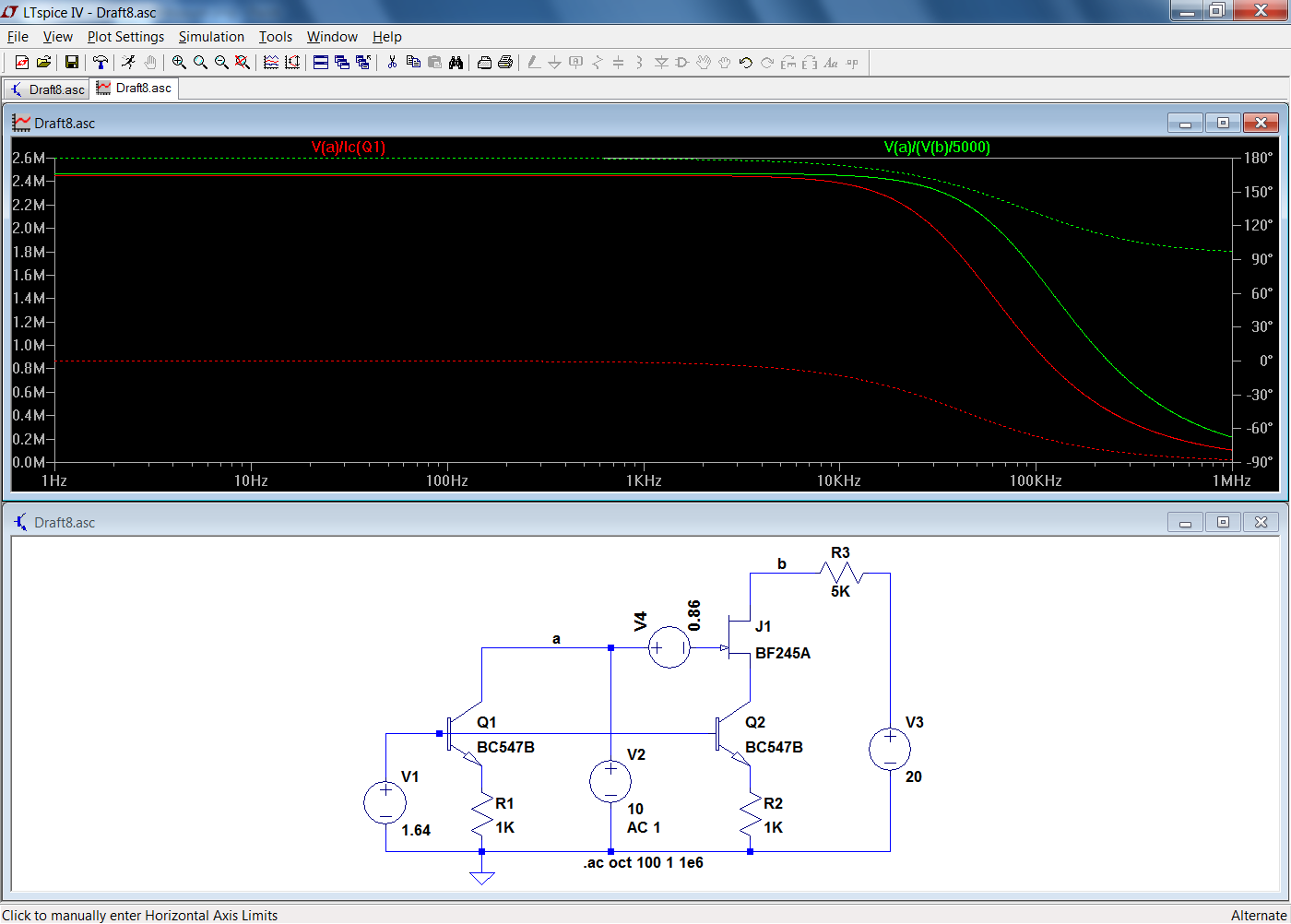

To avoid the difficulty of measuring a small AC voltage riding on a much larger one, you can use a FET cascode to reference the error voltage to a steady DC rail. This will make things considerably easier, since you just need a single-ended, sensitive millivoltmeter or measuring amplifier.I have redrafted my original scheme to make my intentions clearer, I realize now that it may have suggested that the CCS took its DC power from the combination of the ac and DC sources when in fact the CCS should have been powered from only the DC source. I don't think that this was clear in the original scheme.

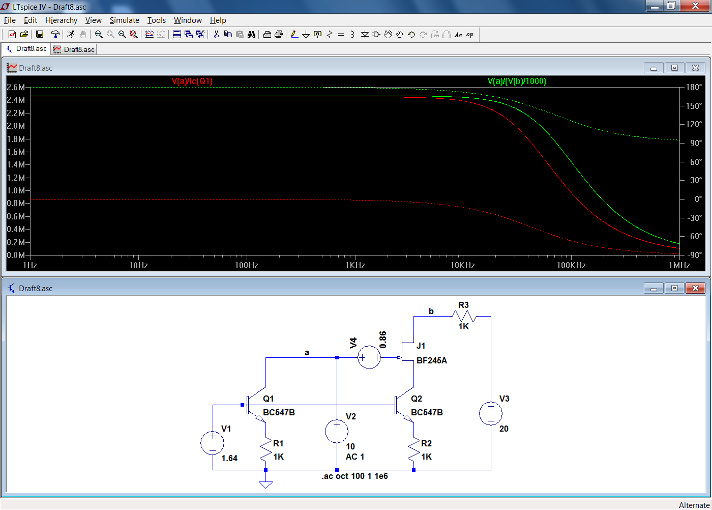

In this example the red trace is the output impedance measured the "traditional" way.
The green one is the result of the cascade isolator. V4 serves to equalize the static Vce's of the two transistors.
You can see that the method is quite robust: even if the measurement shunt is made 5x larger, there is no significant difference in the result
Thanks again elvee, This should be quite easy to accomplish, I can use the DC offset on my signal gen to provide the -0.86 v to bias the fet. My 41/2 digit bench dmm should be able to measure the ac voltage at point b on the 20 mV range, I think.
Just to clarify, the test signal is 10 volts DC with 1 volt AC ( peak or RMS ? ) riding on it, that would make the ac collector current around 0.5uA or 0.5mV across
a 1k resistor?
EDIT: If the smallest range on the DMM is only 200mV, perhaps a 20 db / x10 or even 40db / x100 preamp might be in order, I forget if the minimum range is 20 or 200mV ( terrible memory. )
In this example, with a stimulus of 1V, the current into the measuring shunt would be 0.4µA, resulting in a voltage of 0.4mV.My 41/2 digit bench dmm should be able to measure the ac voltage at point b on the 20 mV range, I think.
If that is too low, a simple amplifier made with a TL071 or NE5534 could raise it to more manageable levels.
Yes. The fact that it is peak or rms doesn't change anything provided you use the same format in the calculation of the impedance. The absolute value of 1V does not really matter either. It cannot be too large because non-linear effects will begin to show, or too small because the noise will become an issue but that leaves quite a usable rangeJust to clarify, the test signal is 10 volts DC with 1 volt AC ( peak or RMS ? ) riding on it, that would make the ac collector current around 0.5uA or 0.5mV across

An fet question I've always wanted to ask and relevant here, in terms of the DC component what is the relationship of the voltage at the source and the voltage at the gate? I know that with a bjt its -0.6v and for a MOSFET -2~4 volts (Vth).
Can I trouble you to explain why it's 0.4 uA instead of 0.5 uA ?( sorry, I don't have the mu symbol on this tablet so u is used instead, you probably figured this already, but thought I should clarify for any other readers )
