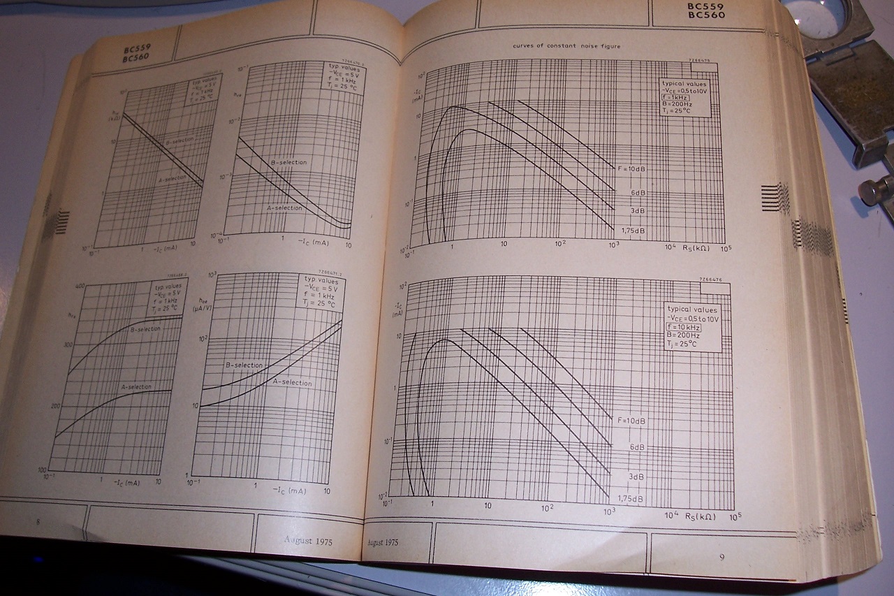

Here, a Philips datasheet example with the plot of hoe vs Ic.
This is from an old paper databook, if you look at the Fairchild DS for the same transistor f.e., it is much more succinct

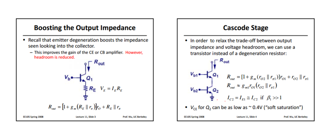

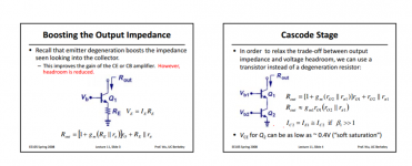

Assuming I can find a value for hoe, Can I substitute 1/hoe for Ro in these equations? ( see attached; from a lecture on current sources at the University of Berkeley )
Presumably in the absence of an actual value for hoe then I can use your suggestion for estimating it, 100/Ic or Ic/100 for Ro since Ro = 1/hoe.

I think soAssuming I can find a value for hoe, Can I substitute 1/hoe for Ro in these equations? ( see attached; from a lecture on current sources at the University of Berkeley )

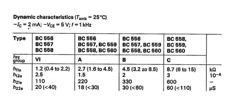

I found this Siemens data sheet ( old by the look of it ) for the bc556~560 series of PNP signal transistors. It shows hoe is higher for transistors with higher beta. Presumably this would mean that Ro would be lower for the higher gain transistors and consequently less suitable for making a CCS.
Lower beta/HFE would therefore be better for CCS as they would have higher impedance, at least at DC.
Yes, that is known fact, and it is confirmed by the Philips DS.Lower beta/HFE would therefore be better for CCS as they would have higher impedance, at least at DC.

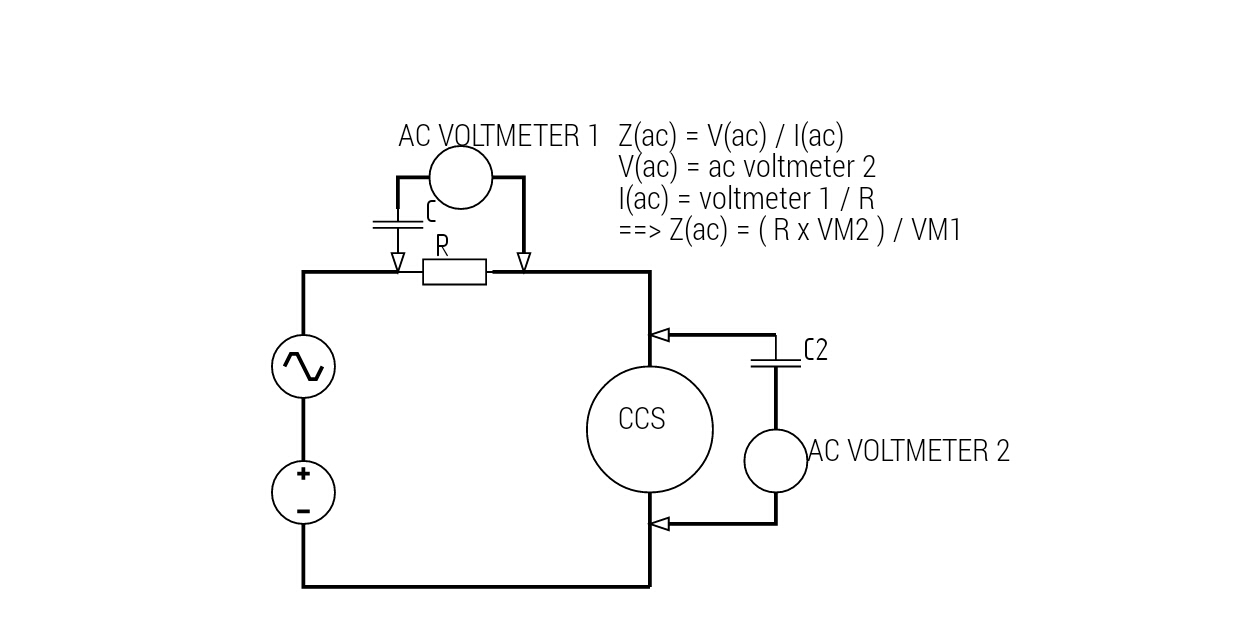

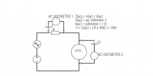

For a simple one-transistor CCS the impedance will be pretty much constant from DC to 20kHz. That being the case, you can measure the impedance simply by applying a DC voltage across the CCS and measuring the current through it. Then increase the voltage slightly, and measure the current again. The difference in voltage, divided by the difference in current, is the impedance. However, be aware that it may vary quite a lot depending on the average voltage across the CCS.I have come up with a scheme to measure the ac impedance of CCS', see attached. Should this work?
If you want to measure the impedance at higher frequencies then you can feed in an AC signal and arrange the CCS as a potential divider, and measure the output signal across R. However, if the CCS is a good one then you may need a large input signal and a very sensitive microvolt meter to detect any signal across R...
Using Merlin post37 pic,
moving the sig gen to Vout and moving Vout to be across the lower R gives a variable load and retains the near constant supply voltage into the CCS inputs.
I'm not sure about this, self heating might mess up the output impedance for very low frequencies: high VCE -> high Pd -> high junction temperature -> lower VBE -> slightly higher current.
- How do you calculate impedance of a current source?
