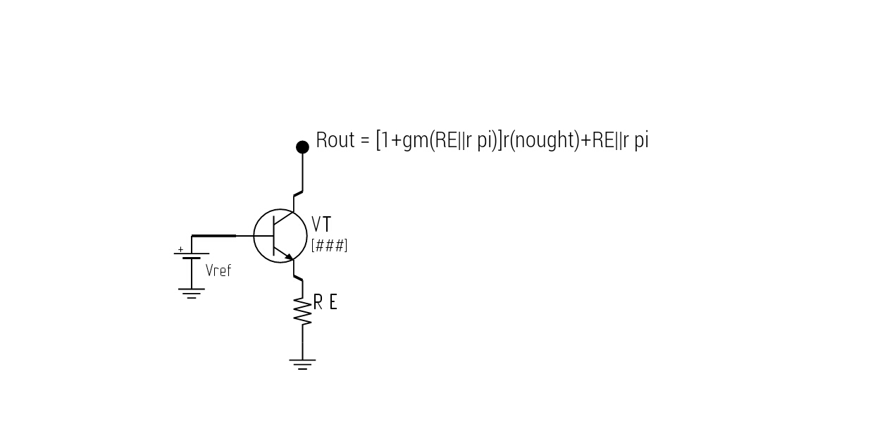

Can anyone advise on how to calculate the impedance of a bjt based current source.
What I have been able to determine thus far is that the value of r nought of the transistor is needed in order to calculate the impedance of the current source, using the hybrid pi model.
The problem is with the calculation of r nought, this is not given on data sheets, neither is Va, the early voltage which can be used to determine r nought. Someone on a physics forum suggested a graphical method of determining Va by extending the Ic / Vce curves backwards until they intersect the x axis. Is this the only way to go about finding Va and ultimately r nought and then plugging this into the hybrid pi model?

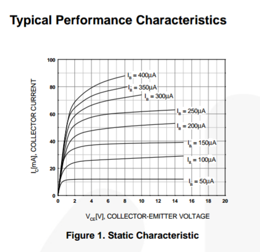

I might be wrong (often!) but it's the gradient of the Ic vs Vce curve at the operating point that you want, not a fictional Va. If you have the gradient then you have a pretty reasonable estimate of the collector impedance and hence a reasonable estimate when used as a single-device current source. I think ?
Yes, the small signal parameter you want is the derivative at the operating point.

Yes, because Va is specified at Ic = 0, which is ludicrous!
I understand that the emitter resistor in a single device current source increases the impedance too, can anyone explain how much?

I would guess it helps out quite a lot - i.e. the impedance is enhanced significantly through the emitter resistor.
This emitter resistor acts as local negative feedback, it will act to reduce variations in current flow through the device by modulating the emitter potential wrt to the base. The feedback is essentially a function of the value of the emitter resistor and the transconductance of the device. You'll pick an emitter resistor that gives you a current of around 0.7V / Re. And the transconductance of a bipolar is roughly the current / 26mV, so the transconductance of the device when used as a current source will be roughly 700/26 * 1/Re = 27/Re. The current variation through Re will produce a voltage variation at the emitter which through the transconductance will act to reduce the current flow. Hmmm, sounds rather circular. For some reason it suggests that the emitter resistor will increase the collector impedance by this factor of 27 ? - have to think about that! 😱

transconductance and gm are the same, yes?
Re is 1/gm, I think.
I'm getting confused between Re, the intrinsic emitter resistance and RE the external emitter resistor.
You may well be right.
Looking at the curves for the bc547, it is essentially perfectly flat at just over 10mA, suggesting that r nought would be very high. The graph has nowhere near the resolution with which you could make a reasonable assessment of r nought.
See attached graph for reference.
I think you need to refine the question in terms of applying to which circuit implementation
ie common emitter, common collector or common base.
Also interesting discussion with SY and DF96 in particular here discussing if hfe does or does not enter into results. http://www.diyaudio.com/forums/parts/221198-high-low-hfe-better-ccs.html
It was the common emitter implementation, see attached.
If the data sheet is correct it implies that this device would be a good choice for a CCS. And perhaps with such devices the effective impedance is high enough for your application that you don't much care what it is ?
