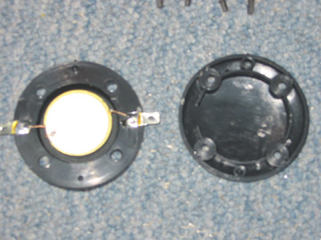

All I/we need to complete the picture is knowing how that motion is transferred to the diaphragm. I took some pictures of the unit as I was taking it apart and made these 6 figures to refer to.
It is actually the disc's inertia that is responible for mechanically coupling (maybe "grounding" would be a good expression) the bending motion to the diaphragm.
This is building some sort of mechanical highpass and therefore it is possible (though not advisible in the interest of good sound) to use this drivers without an electrical crossover.
The second mechanical highpass in this tweeters is the horn of course.

Yes, it appears to be simply the disk's inertia that works against the diaphragm. In fact I found that you get the same level of sound out of the horn by simply rubbing your finger about on the back of the bimorph disk. So, I do not think the diaphragm really moves in and out at all. Rather it just vibrates like a tin can does with a tuning fork placed against it. Which would mean that the timbre of the sound would greatly depend on the material the diaphragm is made of. And it would explain why this device can work with such a small gap between the diaphragm and the cone on the back of the horn.
As for what this means for the DIY tweaker, I would say that mods to the stiffness and dampness of the diaphragm material itself would pay off the most. And probably mods intended to reduce reflected sound from the rear chamber would be worthwhile. The ENAbl patterning still seems applicable as well. Anything that touches the disk to try and control or damp larger motions would have to be done with great care to avoid adverse effects on sound quality. Something light and rubber which touches only the rim of the disk might make sense to try, but it would have to be mounted in a "neutral" fashion. Meaning it should not press the disk in either direction, forward or backward. It would have to allow the disk center to vibrate freely while a signal is applied but help kill the vibration quickly when the signal ends.

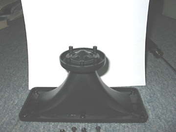

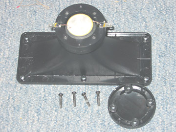

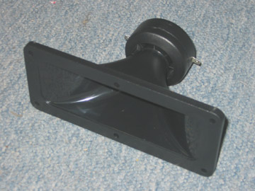

Trial piezo modification results
First off I want to tell you all about a great thing I found to listen to on your tweeters for comparison purposes, or just for fun. In iTunes Radio is a folder called Ambient. In there is a channel called Birdsong Radio. They just play recordings of birds, and even though they are MP3s they sound really good. I love listening to this stuff on the piezo horns!
I have now tried several things to see what might help the sound quality or frequency response of these piezos.
First off, the diaphragm was given two light coats of Modge Podge and allowed to dry O/N. That already makes a noticeable improvement in the sound, as I mentioned earlier.
I tried mounting a rubber washer cut to just overlap with the outer 1mm rim of the bimorph disk, with the outer edge laying on the back of the plastic ring the bimorph sits it. The back of the disk and the back of the plastic ring section are even so this rubber ring sits flat, in a neutral position.
This definitely damped down the early peak around 2500 Hz, and the piezo did sound a little more clear, but it also damped down the sound over the rest of the range. I tried cutting off most of the outer section of the rubber ring so that it was just touching the plastic ring section in four short segments each about 4 mm long. That did not seem to make much difference in the degree to which this damped down the overall sound level.
However, I found that you can put 4 small pieces of thick felt between the outer edge of the rim and the ID of the plastic ring section that houses the bimorph disk without killing the sound level. It is harder to tell if this has any really positive effect without a lot of critical listening comparisons I don't want to take the time for just now, but I will keep the keep the felt in there. It should at least help to kill some back reflections.
I also tried putting an ENAbl pattern on the front of the diaphragm, one ring at the outer circumference and one down next to the apex, with a dot in the center of the little flat spot where the diaphragm connects to the disk. The pattern was rather poorly made (it is such a tight space to work in) with flat black artist acrylic and coated with Micro Gloss. The paint had to be diluted by half and even then it doesn't really flow in the speedball nib.
This mod makes a noticeable improvement in the clarity of the sound even at high volume levels. I _really_ like listening to the birds now. This is a keeper! As soon as I heard it I treated the other one. I assembled the unit with the felt pads around the bimorph rim, lined the rear chamber with felt, and placed a pinch of poly batting in the rear chamber. That is how I will use this piezo tweeter. It sounds very good now, but it still has the peak around 2500 Hz. The recommendation to cross this unit over at 3500 Hz will still apply.
Now I'll see if these can make the dog howl if we play flute music...
