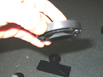

After a brief un-tamed listening, the low frequency limit of these drivers is surprising. They're mated to a wave guide designed for car audio use. Probably 2" tall by 18" wide with 6" throat length & ~90 deg horizontal dispersion.
The characteristic sound is a bit "splashy", and similar to smaller Motorola piezos I've dealt with in the past. It's easy to feel the vibration of the inexpensive plastic waveguide. Obviously, there's room for improvement.
They are very, very efficient. And very intriguing.

Hi Tim
The EV horn is cast alluminum and wont vibrate like the one you got.My problem was with the plastic housing of the piezo it self.

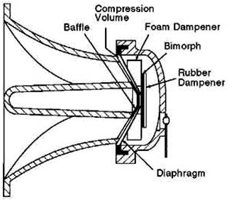

I found this web page about the Motorola/CTS line of piezos which actually explains how they work. They use the term "momentum drive principle" to describe it. This link pretty well covers everything we have discussed here in this thread, including crossovers, parallel/series arrangements, notch filters, and the theory of operation.
http://www.pulsardevelopments.com/products/detail/piezoan.html
These experiments have got me thinking that it should be possible to make a simple and pretty compact Phy style tweeter out of one of these cheap piezos if you have a lathe and can fabricate a housing that will enclose the disk at one end and provide a rim to hold the edge of the diaphragm at the other end. I will start working on a "MyPhy" tweeter soon. Prototype to made in PVC since it is inexpensive and reasonably damp.
