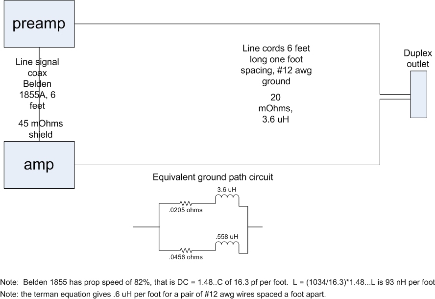

Yes, but these two paths are both low resistance relatively low inductance paths and both linear (contact problems aside). No mechanism for inducing distortion. Hum loops maybe.
I've highlited the two relevant statements.
The fact that there are two paths the return current can take is indeed the reason distortion can ensue.
At lower frequencies, the signal loop becomes that created by the IC center conductor and the line cord safety ground. While that in itself does not create distortion, it creates an unshielded input. Stray, time varying magnetic field passing through that loop will induce a voltage signal within that loop, that loop being the low level signal path.
Remaining is....where are the sources of time varying magnetic field which would be associated with a line cord? Simply, the amplifier current draw from the wall. In fact, hot and neutral are in proximity to a portion of that ground loop by design.
That line current draw is an audio power level modulated current, made of haversines rich in odd harmonics. In addition, the power supply capacitor bank loop will couple actual hf audio signals through the bridge and transformer into the line cord. This line cord current spectra and modulation has been measured by others many times.
And, it does not occur when the music is silent. So the music one listens to is actually the confounder.

Recall this pic..John
The disagreement is that I think what you wrote can be misread that at LF all the current flows through the power cord and only at some unspecified HF returns to the coaxial shield.
Where current goes depends on the impedance. Two paths, two breakpoints.
At low frequencies, the line cord ground conductance dominates.
At high frequencies, the line cord ground inductance decouples the safety ground.
cheers, jn

John,
Here we are disagreeing again. Dominates is the key word. At LF the current ratio is due to the resistance ratio, on this we agree. I think the original statement could have been read to say ALL of the current goes through the power cord.
It is the meaning of "At lower frequencies, the signal loop becomes that created by the IC center conductor and the line cord safety ground" that we disagree on.
