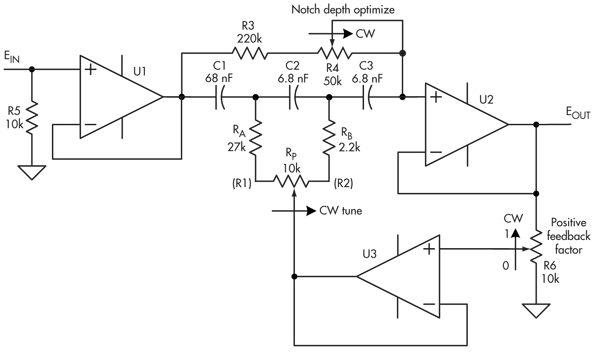

How do I tune my Twin T notch filter ?
The input sees the source and if there is a loading resistor at the Source/oscillator output, then the FET input opamp gets a biasing load back there.
Is there an advantage to taking the biasing resistor until after passing through the two R limbs?
Rather than taking the biasing resistor at the +IN pin of the FET input opamp?
Is there a ratio of biasing resistor for R+R:100k that needs to be used to maintain accuracy of the notch?
Another notch circuit uses 1M:7k+7k where the 1M is at the +IN pin.
Yes there is an advantage to positioning the 100k bias resistor at the far left rather than at the far right.
Try both in simulation and step the bias resistor value 10K, 100K, 1Meg. This generates six output traces, three for "resistor_at_left" and three more for "resistor_at_right". I predict you will prefer the traces for "resistor_at_left".
This came up in the low distortion oscillator thread, I forgot whose name is on this but there were some references in that thread last week. I simmed it and it worked great. It also works as a passive filter without the op-amp and Q enhancement response is then identical to twin-tee but with one pot frequency trim.

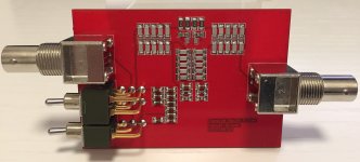

The Hall network filter works great. With Samuel's PCB and using 1% C0G caps, it's possible to match C to below 0.05% by grouping. Then with 0.1% 25ppm kit resistors, a notch depth of 88dB was reached at the desired frequency without much hassle.

Was that untrimmed I don't see a pot?
OT - I wonder how you apply a 1% 5pF cap, you would need some bridge setup to even measure it.
There is no pot for trimming. The procedure is first to populate the 30k and 10k resistors and then measure the notch frequency. Then calculate the value of the tuning resistors and add them (there are parallel and series resistors for tuning). It works easier than expected.
The capacitors are 1nF.
That's what I thought, at least it looked that way and it's good to know you don't need a lot of iterations. I was just surprised they make 5pF 1% capacitors you would need 50 femtoF parasitics to preserve that.
I used the DMM setting of 200.0nF. It reads 22.1nF for the two that were fitted into the low cap arms.
The two that read 22.0nF and 22.2nF were paralleled to fit in the high cap arm.
I guess my very inaccurate DMM has given me better than 0.5% matching.
And the final notch depth for the passive filter, with resistor trimming, gets me to -88dB to -89dB
Three questions about a hall filter. First what is the tuning range? Second can a relativly small notch depth (40dB) be obtained and how much does the notch depth change with frequency? Third can feedback alter the Q and depth of the notch?
Ill try a simulation soon but someone may already have some answers.
Sent from my LG-H811 using Tapatalk
At a given frequency tuning is not bad but does effect all other parameters.
Notch depth, Q etc. One would have to have to pots. Tuning and notch depth.
It looks just the same as a TT when FB is applied.
By the way the FB is really just a bootstrap. Is there a passive way of achieving this?

I built three notch filter boxes, two Twin-T and recently a new using the Hall network
(reading a post on the "low distortion audio range oscillator" thread).
That i can say is that both work fine.
The Hall can be adjusted more easily but each "depth" and "Fo" trim are dependent so they need to be trimmed both.
Anyway, It's still easier to adjust than my Twin-T.
The Hall need some feedback to avoid high attenuation of harmonics.
I used two AD797 with a little notch feedback but no output gain.
When testing the EOSC10KV3 10kHZ oscillator, i don't see any spurious or harmonics content.
