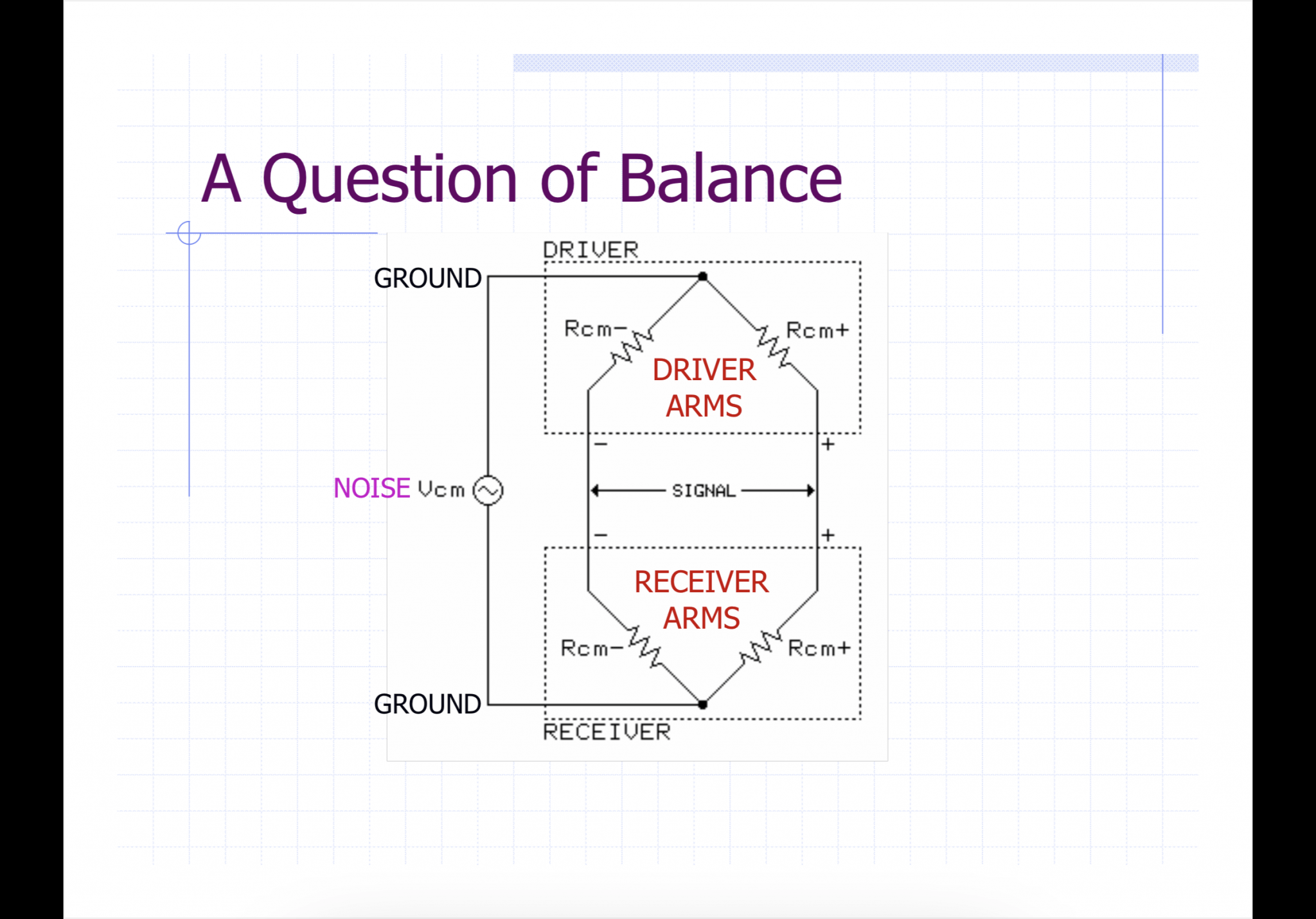

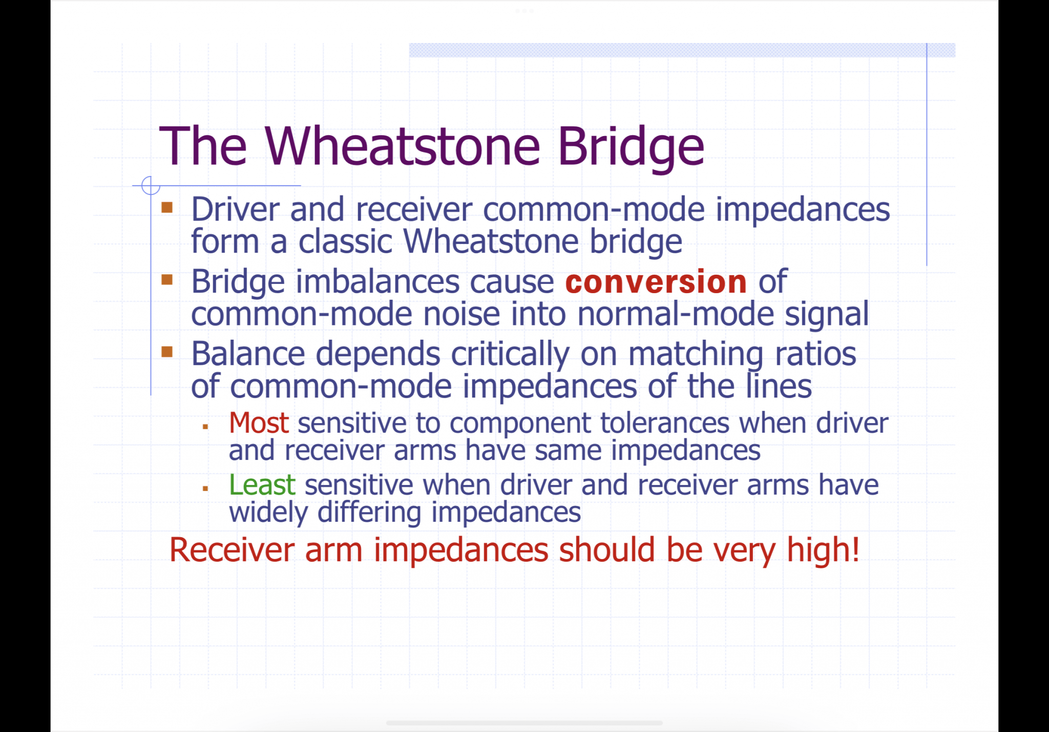

As I learned from reading Whitlock, a balanced interface is essentially a Wheatstone Bridge. IIRC, the source’s two output impedances form ther the two left most arms of the bridge, while the receivers input impedance service as the two rightmost arms.Just found a couple of authoritative articles of 2012 by Bill Whitlock, President of Jensen Transformers Inc. since 1989.

So glad to hear this from you.As I learned from reading Whitlock, a balanced interface is essentially a Wheatstone Bridge. IIRC, the source’s two output impedances form ther the two left most arms of the bridge, while the receivers input impedance service as the two rightmost arms.

Here’s also a couple of presentation slides by Whitlock himself about it essentially being a Wheatstone Bridge:
Only if the layout is also balanced and such that the interference source couples equally into each circuit half. I highly doubt you'll be able to achieve that in practice except for differential traces between circuit blocks.
You are correct, though, that in my previous statement I did have an unstated assumption: That the circuit and layout designer(s) is/are reasonably competent so coupling from EMI, power supplies, and whatnot into critical signals is minimized.

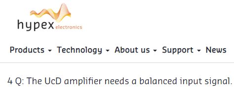

I remember putting a 100Kohm between RX+ and RX- and a 1Mohm betweewn RX- and GND.
That keeps the differential-mode impedance (the input impedance which the driver sees) at 100K, while setting the common-mode impedance of the receiver’s input at 1Meg. The higher the reciever’s common-mode input impedance, while also keeping the driver’s common-mode output impedance relatively low, the less sensitive is a balanced interface to impedance mismatches within the interface.I remember putting a 100Kohm between RX+ and RX- and a 1Mohm betweewn RX- and GND.
However, please note I said "some" not "all".
Yes I knew that, but it is a non-recommended alternative single-ended connection way that does work, but it prevents from exploiting full potential of amp design.
The truly recommended (needed) connection is a balanced input signal.
