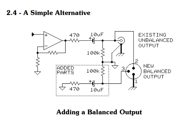

This gets me "Mostly Balanced".
Sound from pins 1&2 - yes.
Sound from pins 1&3 - nope.
But has all the fancy benefits of "True Balanced", except does not have 2x preamp gain if Amp input is Balanced, yes?

I don’t have a secure feeling that I‘ve correctly interpreted your point, but that figure 2.4 from Jensen AN003 is truly balanced, in terms of impedance. Which is what matters for a balanced interconnection. The purpose of a balanced (impedance) interconnection is that it enables rejection of common-mode noise. Jensen’s description of fig. 2.4 as being truly balanced, is because it provides every dB of CMRR as can a differential signaled, balanced (impedance) interface. By the way, most of the CMRR of a balanced interconnection is derived at the receiving (input) end.
Signal gain has to do with the active ciruitry prior to the output interface. Differential signaling is not really about gain. Rather, it’s main advantage is that it enables twice the peak-to-peak signal swing of single-ended signaling from the same supply voltage rails.

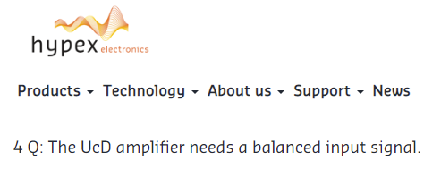

Some class D home power amps need balanced input signal.I'm not quite convinced that balanced circuits are needed in home audio equipment.
I don't know they need it.
I'm driving a pair of ICE amps with SE to balanced adapters and I'm putting together an Ncore amp that will be driven similarly.

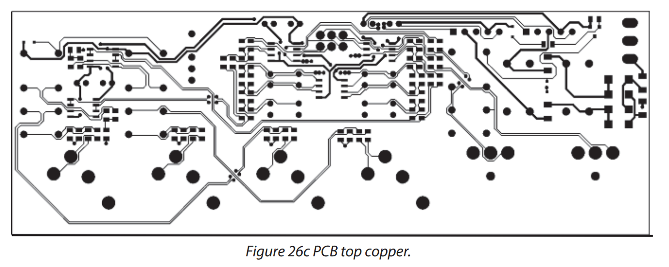

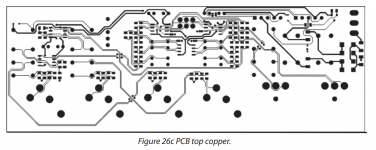

A good example of a purpose-designed balanced preamp is Bruno's demo project from Linear Audio.
Look at the PCB layout: if you check the signal routes from the left to the right you'll see that the signal and reference (sometimes that's ground) traces hug each other, treated as a balanced line, to get equal impedances to The Rest Of The World.
The full article is available on the 'net (The G-word, or how to get your audio off the ground).
https://www.diyaudio.com/archive/bl...d1460406090-bruno-putzeys-micropre-g-word.pdf
However, please note I said "some" not "all".Some class D home power amps need balanced input signal.
Yes I knew that, but it is a non-recommended alternative single-ended connection way that does work, but it prevents from exploiting full potential of amp design.I'm driving a pair of ICE amps with SE to balanced adapters and I'm putting together an Ncore amp that will be driven similarly.
The truly recommended (needed) connection is a balanced input signal.

Bill, I'm uncertain on what you are describing when you say, single-ended but balanced drive. Do you mean like as shown in Fig. 2.4 of that Jensen AppNote?Another thing that can be confusing is if you can reach max output from an amplifier from a single ended (but balanced) drive. Rarely explicit in the specs.
Yep. I do the same thing. Another trick is to stack the traces vertically.A good example of a purpose-designed balanced preamp is Bruno's demo project from Linear Audio.
