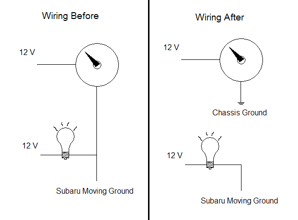

I am having trouble with some gauges I am putting in my car. I have a Subaru, and as I recall, Subaru uses a moving ground for dimming interior lights, not a moving source.
This gives me troubles, because in my gauges the dimming circuit and the gauge servo power circuit share the same ground. Thus, when I dim my lights, my gauges don't receive enough voltage to operate properly. This annoys the **** out of me; I go to dim my interior lights and the gauge needles fall down.
I would like to fix this problem with a circuit workaround, but I'm unsure where I should start.
The first thing I have to do is find out what is normal for a dimming wire in an automobile. Is the voltage range 0-12 Volts, 11-12 Volts, etc... I don't know what the "standard" voltage difference between fully illuminated and unilluminated is in automobiles.
Next, I have to take some measurements from my car, and find out what the voltage difference between fully illuminated and unilluminated is for my particular application.
Finally, I need to make a circuit that operates on the voltage difference of the moving ground, and transfers that to an equivalent voltage difference on the positive side. Then, I should be able to have the gauges dim correctly while operating correctly.

Usually fully illuminated lights are running from 12V. Not sure about anything else though....do you have a circuit diagram?

Obviously I cannot be sure without seeing the gauge in front of me, but based on what I have seen, my guess would be that it would be far far less effort to disassemble the gauge, isolate the light bulb socket from the common ground wire, solder on a new wire, and then just hook up the 2 light bulb wires in Subaru-polarity. Usually aftermarket gauges have good access to the lights for replacement purposes.
Thanks guys. After Thinking about it some more I think you're right, it would be simpler to isolate the lighting and hook it to the Subaru moving ground, and hook the gauge operation wire to a "real" ground on the chassis. I forgot there's more than one way to skin a cat.
