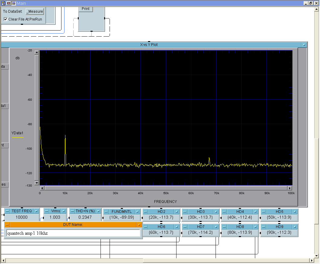

As I mentioned to Demian, I built a spare Amp 1 board, seem to work fine in testing, but one odd thing happened. When I hooked it up to your twin t at 1vrms out, the null dropped to about -80db. I've never been able to get much more that -60db on a really good day. Though I haven't measured it, I believe that the Amp 1 has a big DC offset that is taken out by a 10uF cap in the next stage, but don't know why I would get such a big null when testing this amp through your twin t.
Ken
Check that the twin tee isn't loading the amp in a way that causes a lot of the drop. The Quantech has a notch filter as part of the AGC circuit and "compresses" the gain to meet a target level for the reference tone. The output Z may be quite high and the notch filter actually causes a drop at the notch frequency.
I'll scan the compressor circuit tonight. I have several I'm (not) trying to maintain. More insight always helps.
The input Z of the Twin-T varies a lot depending on frequency. Might be a good idea to monitor the input level to the T-T while you have it nulled, as Demian pointed out -- if the level drops when you switch the T-T in, then you have the explanation.
I've resisted putting a unity-gain buffer in front of my T-T in order to minimize distortion, but that could be a good idea here. I would use an OPA1641 were I to do it.

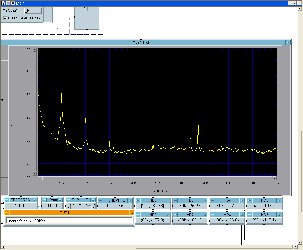

Demian and Dick, Thanks for the helpful suggestions. I'll follow Dick's suggestion for voltage droop. I am currently testing the Amp 1 board seperated from the Quantech, i.e. I bought a socket and have rigged up a power supply and input / outputs to test it stand alone inside of a metal box. A bit of overkill, but, I love projects...
Ken
Test of V2 of Amp 1. both tests are with 1vrms output, no voltage droop when connected to Dick's twin t, but, upon the second test the null dropped to -80 or so. Wierd! On second test I connected the amp 1 output to the Hp 8903 to get the Vrms reading, that's when the null dropped. But, when I disconnected the 8903 the null didn't come back up.
Any thoughts?
Ken
Any thoughts?
Ken

I was in a bit of a hurry this morning, at this point, I'm pretty confidant that my duplicate amp 1 board works well. Still have to check it's self noise, probably won't get to that until next week, going out of town for a few days.
Just a bit stumped by this 40db drop in the fundamental...
