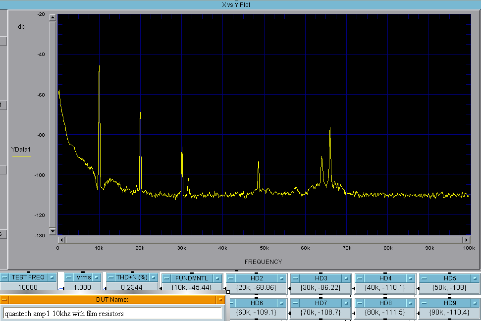

not knowing where else to post this, I figured here is probably as good a place as any. I am making some update modifications to an old Quan Tech 2173C Transistor Noise analyzer. I need to update an amp section (image 1 is the schematic) so that it will work with JFETs. I removed the amp section and powered it up with my lab bench supply to make a baseline measurement (image 2). A pretty clean amp and spectrum, all with the board unshielded out in the open air. I then replaced all the carbon resistors with metal film Dale Rn55's figuring that I could improve the noise floor a bit with quieter resistors. Well no such luck, with the same identical setup, measured early in the morning just like the prior measurement, things got much worse! (see image 3).
I've been thinking about this all day, and believe that it might be the ferrious quality of the Dale resistors that pick up the EMI far more readily than the non-ferrious carbon resistors.
So today I ordered up some non metalic Halco resistors and will install them to see if thing return to the baseline. If that doesn't work, I will put in some NOS Allen Bradley's. Any other thoughts would be welcome.

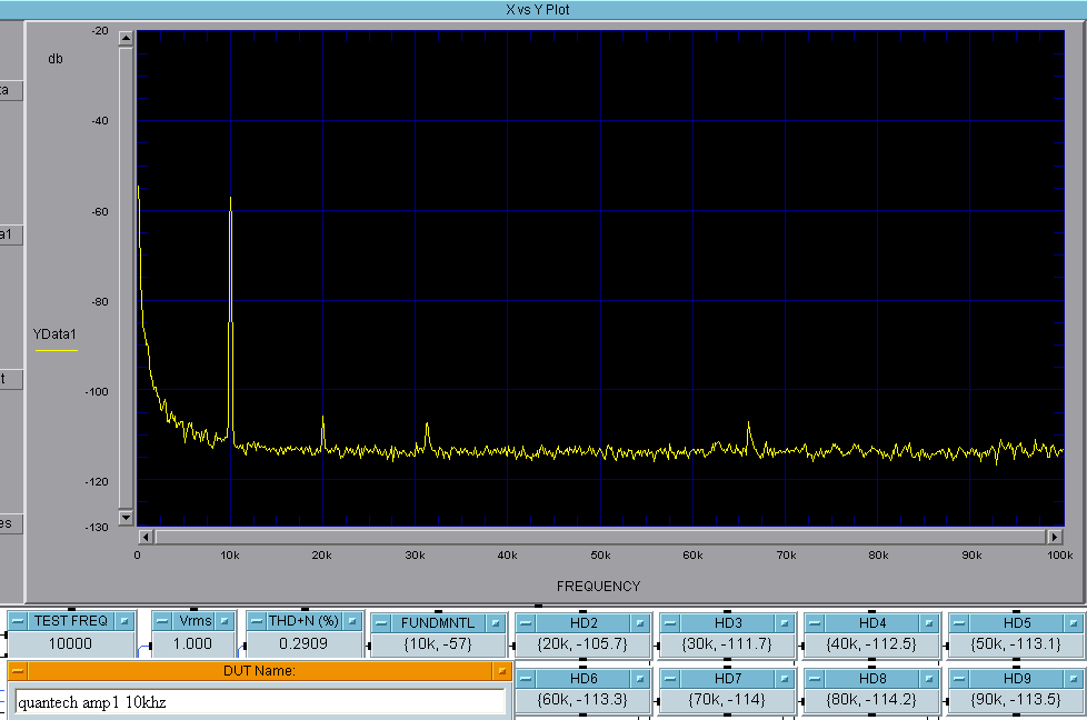

I was just struck by how different the spectrum was with the resistor change, when tested under identical conditions. My theory is that the ferrous quality of the resistors makes them subject to significant emi pick up.
Ken.
Ken, that's a huge difference in the plots and I can't believe that the change is solely due to changing resistors, especially to metal films. Something else is going on here. I assume you're using good old fashioned 60-40 tin-lead solder? Mixing Lead-free with regular can be a nightmare....
Hi Dick,Ken, that's a huge difference in the plots and I can't believe that the change is solely due to changing resistors, especially to metal films. Something else is going on here. I assume you're using good old fashioned 60-40 tin-lead solder? Mixing Lead-free with regular can be a nightmare....
Yes it seems like too big of a swing. I hope it doesn't indicate over heating of the transistors during the desolder. Using cardias eutectic solder.

Help me with the plots. The noise floor seems to be around -110 in both. The first plot has a 10 KHz peak in it. Where is that from? The second shows a lot of harmonics from the peak and some 48 kHz and some 65 kHz. The latter two look like switching supply or monitor or CF noise to me.

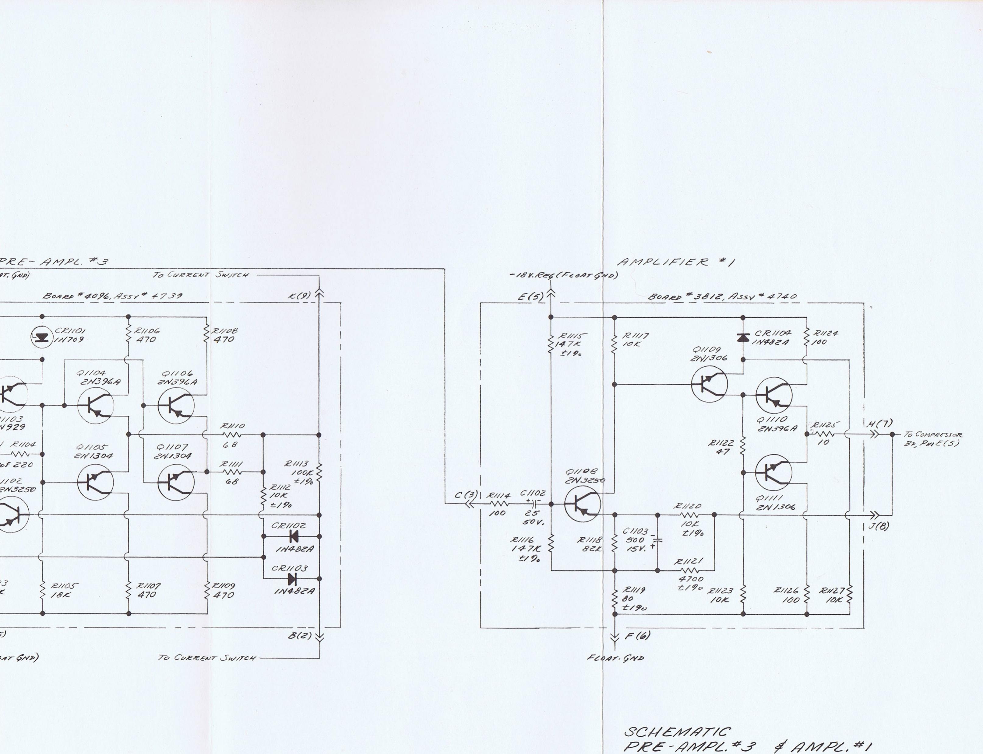

Which preamp are you tweaking? There are three, depending on the current setting. Or is it the amp (Front cage 4th board from the left)? There is a fair amount of gain in front of the amp so noise there is not too consequential.

Help me with the plots. The noise floor seems to be around -110 in both. The first plot has a 10 KHz peak in it. Where is that from? The second shows a lot of harmonics from the peak and some 48 kHz and some 65 kHz. The latter two look like switching supply or monitor or CF noise to me. .
The 10KHz peak is the fundamental frequency, it has gone through a notch filter (Dick's twin -T ) and is down about 50db - the amp output is at 1 Vrms. Using the notch filter drops the floor of the spectrum analyzer to about -130db.
I agree about harmonics being from environmental factors, like the switching supply. The interesting thing is that the board was relatively immune to these factors when first tested.
It's Amp#1 as shown on the right side of your posted schematic. The manual I have is a bit newer than yours, yours exactly matches my board. My manual show things like the JFET switch, which is a part of the AMP #1 schematic. (not shown on your schematic - see lower left corner of AMP #1 schematic.)

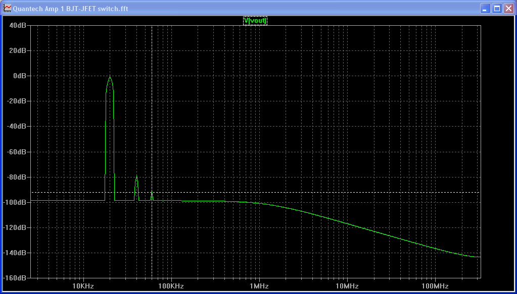

So I made a quick check with a spice simulation using 2N5401 and 2N5551 Cordell models. The FFT plot is quite similar to the second spectrum plot. I don't know what to think... maybe the first plot was a total fluke.
I thought that maybe I had run the first plot at a lower input voltage, but, the voltage measurement shown on the plot is taken from the HP8903A and it reads 1vrms on both plots.
Given the spice results, the quan tech will probably run fine as modified, but, I am still going to try to reproduce the first spectrum result. I will build a replacement board and try populating it with carbon resistor just like the original. Looks like a Fairchild SS8050 or BC63916 are both reasonable subsistution for the 2n3644 device.
