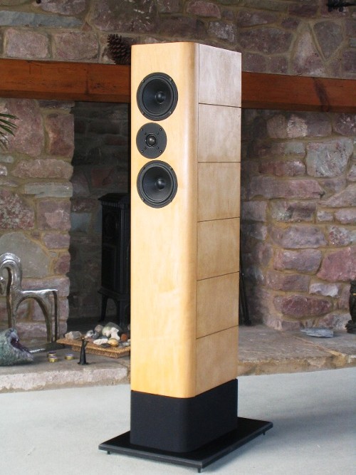

also have you got some nice pics of your finished ariels i could ...borrow for wife convincing purposes 😀
Steve
Hi Steve,
Sounds like your room will be OK. Heres a pic of one of mine. There are more on Lynn's site. I dread to think how much time these consumed!
The good thing about DIY is you can make them look how you want. They are not small, but they are an amazingly musical speaker that can hold its own against the very best. Just remember everything Lynn says on his site about them is true. Dont skimp on the crossovers.
Simon
