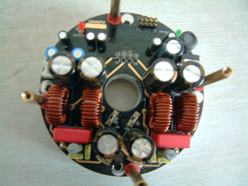

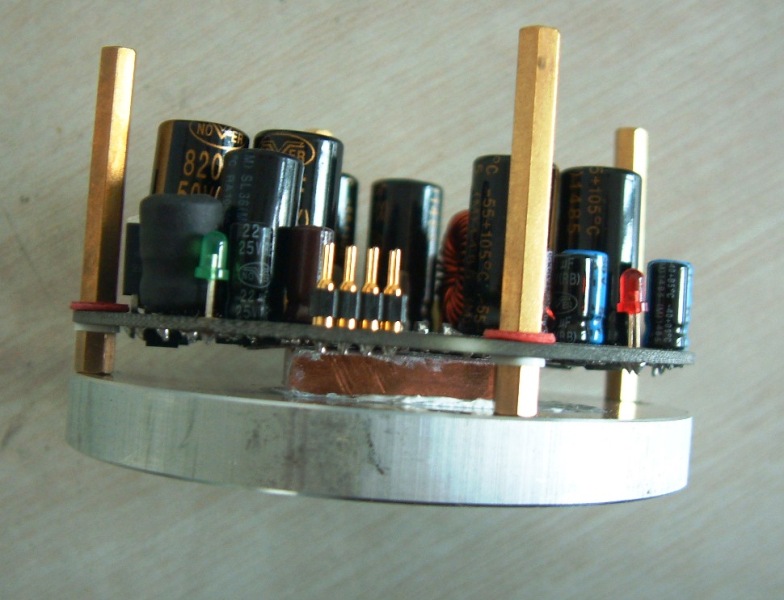

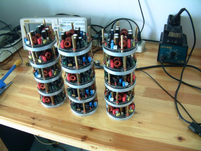

Special AMP use TAS5630
We have finished one type of special amp use tas5630,PBTL mode ,one channel,module dimensions :90mm diameter,45mm height.450W power out.
My friends use it in special way,6Khz-60Khz.
when we debugging it,we connect it with our 2ohm speaker,play music ,found sound excellent.
I think maybe damp factor higher in this mode.
Maybe some friends can use it as audio amp,I have tested indeed,sound excellent.
Strange idea,Special production.

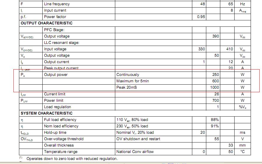

We developed this amp because the Ti recommended power supply so weak.
250W continus power out,600W at 5 minutes,I think it is not fit for tas5630 amp power supply, it's paradoxical sensation,if amp out power enough,the SMPS so little,if smps enough where the amp energy comes from.
http://focus.ti.com/lit/ug/slou293/slou293.pdf
We test our new G230PSD power supply at 46V@2ohm,it continous about 1hours,of course fan cooling system inside,it has variabl speed depond on the chip tempreture.

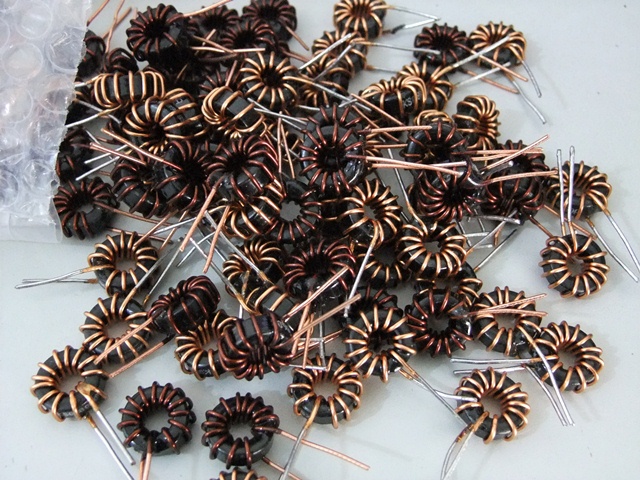

Just a quick question about the 7uH inductors used in TI's design refrence(PBTL mode), has anyone any idea where i can source these?
Thanks in advance :)
thousands of times testing.we confirm our tas series inductors, it is our customer order inductor ,works very well for tas series amp. temperature rise very lower,full loader continous working never exceed 40℃(20℃ room temperature).price lower.performance very good.
