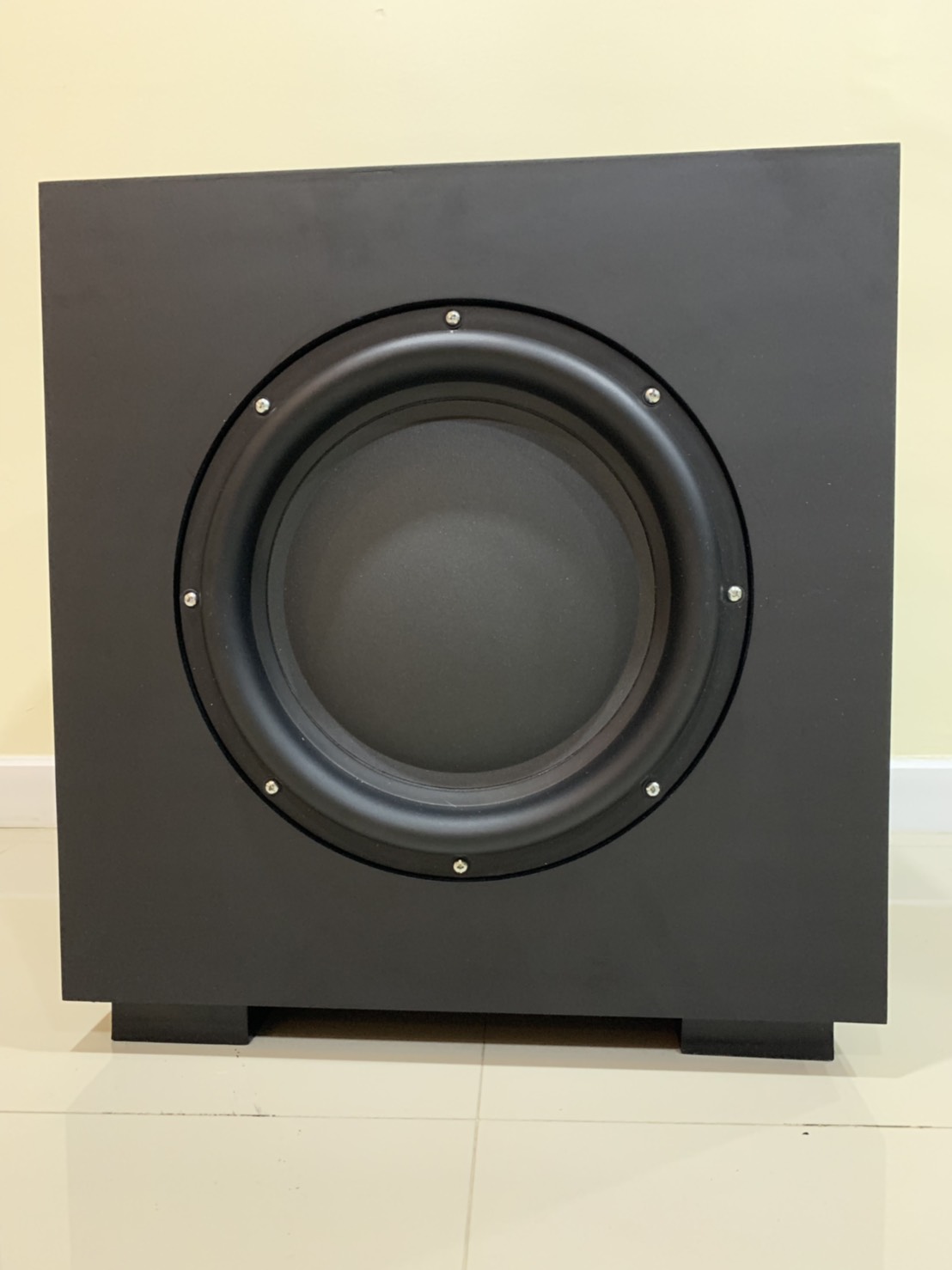

Get a sub with large excursion and use DSP to add gain at the bottom end...that may require a lot of power, but can extend the usable bottom end...my 15" Peerless STW350F still moves a lot of air at 16Hz! It is amazing to see the sub moving and not hear it...

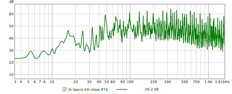

Here's an RTA of the colossal final moments of the St Saen's 3rd Sym (sorry, didn't note the performance). You can see sub-sonic content on the source, on the button at 16 Hz. But while 15dB below the mid-range peaks, likely minus 40dB or worse in audibility, even if your speakers were EQ'd to flat (not a good idea, but a common intention).
(Those distinct peaks is characteristic of an organ RTA.)

It looks good, is it in an anechoic room?
If so, it is the musical work faithfully represented by the measurement.
My congratulations for it 🙂
