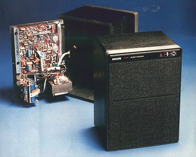

You mean this image?
Gheghe, don't let that put you off 😛

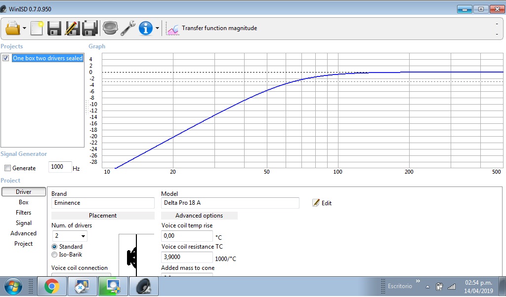

Hi guys - noob here. I thought sealed enc. size is pretty much dictated by the driver's specs. I understand a smaller enc. will result in a LF hump but it would probably be >100Hz right? Also my minidigi clips at serious EQ levels without any indication 🙁 I don't need huge volume but do love those low low notes. I need to go DIY since shipping to me here in Ecuador is $6.50 /lb ..... ! Was thinking maybe two 15's ? I could probably go 9 cu. ft. max. Are there any programs to model two drivers? Thanks.
...... Are there any programs to model two drivers? Thanks.
Win Isd does it.
But 2 drivers in the same volume will have more admissible power, but no more SPL. It is better each driver with its respective box (of the same volume) if you are looking for a lot of SPL (level of the sound pressure of the sound)

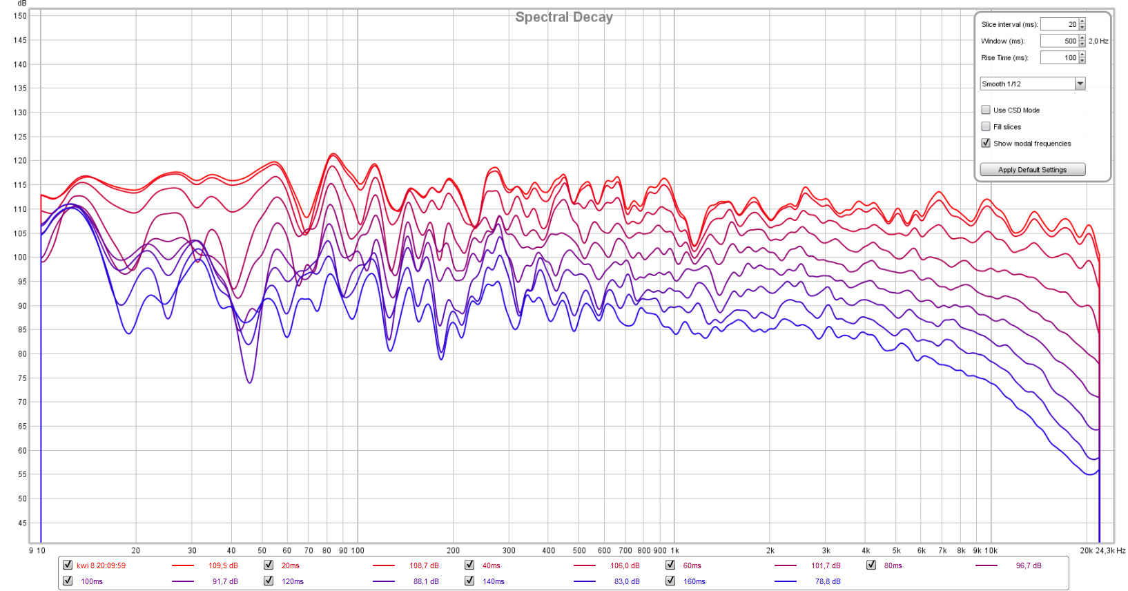

Room gain cannot be mathematically calculated for any practical case, due to many physical phenomena going on along. Sealed box systems has greatest chance to reach into infrasound without much efforts, and with lowest design / production / architectural / functional loading of the room. In the attachment there is LS1 clone in-room frequency response into 3x4meter glass fiber-insulated attic. It is hard to provide sufficient bass energy here due to lack of rigid boundaries, weak air tightness and lack of resonant room modes. There is no acoustical treatment in this room. Measurement taken with high-quality analog electret mic. Linkwitz transform set to fp=35 Hz, Q=0.7. dB scale is lifted to emulate peak power output loudness capability of playback system.
