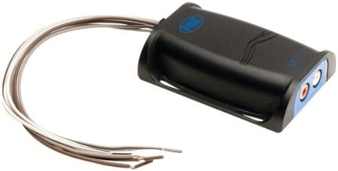

I have 1 sub operating using the single Sub Out on the receiver, but am having a hard time figuring out how to get the 2nd sub wired to receive a signal. I have tried to wire the 2nd subwoofer using a 2 channel speaker wire to RCA converter box, but there was a lot of static when I plug everything in... Please help!! And thank you!!
Receiver: Cambridge Audio AXR100
Subwoofers: Klipsch R-120SW
RCA Converter: PAC LP3-2 Pro Series

The RCA converter is intended to reduce speaker level to RCA level.

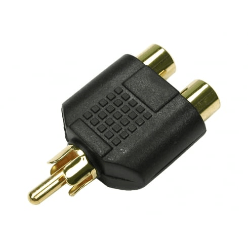

All you may need is a an RCA splitter to enable you to run a single RCA cable to each of the subs.

Just split the one rca with a y cable, it works fine. Don’t overthink it. The worst that could happen is you wasted $5 on a splitter!

Another vote for a Y cable. Never seen a gain on a sub that couldn’t keep up with half the signal. Coupling the two woofers will make it more sensitive than one.

Get the RCA splitter. The inputs of the subwoofers are (should be!) of high enough impedance that the receiver's line level output should have no trouble driving both.
