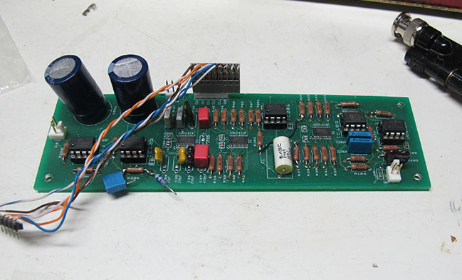

I have the Shure M78 around here somewhere -- and an old, relatively inexpensive Thorens which I modified (all you need to do is add a potentiometer) to play the old recordings.
(Gary Galo wrote an article for Linear Audio describing an archival recording preamplifier. I modified it so that you could adjust settings on the fly with an MCU controller -- in this case Arduino) :

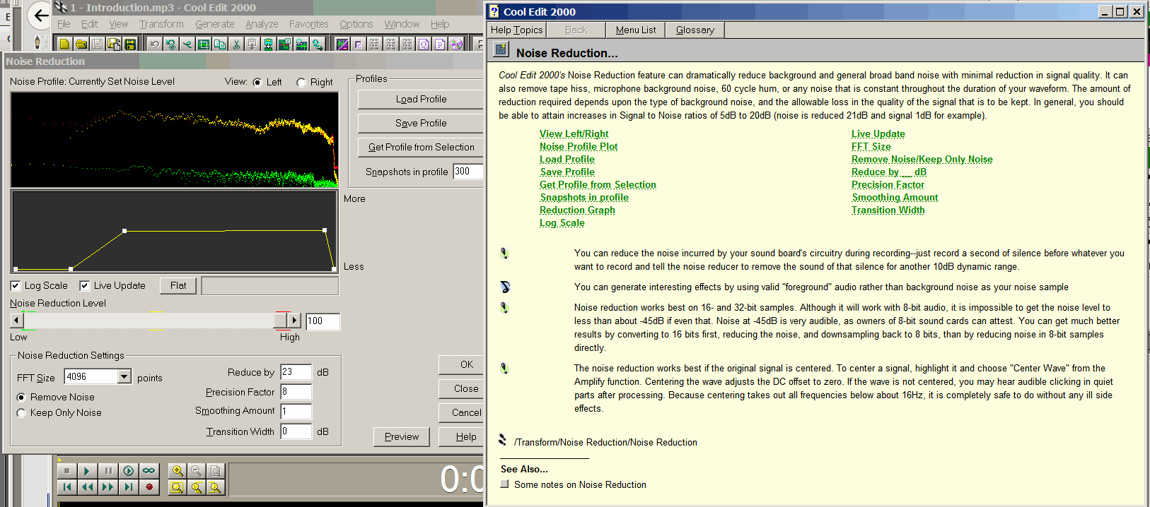

The Noise Filter in CoolEdit 2000 could do some amazing work.
First you show it a sample of "quiet" (full of noise) and let it study it.
Then you run a lot of trials against the speech. There are many settings for frequency and aggressiveness.
A friend had pre-WWII 78s with great childhood nostalgia; but also massive childhood scratches and dirt. I got them listenable. (Russian Army Choir on Columbia, great recordings; and I did hunt for cleaner copies before doing all that work.)
My family had a cam-corder of a family reunion, badly tainted with wind noise (also too-far, too-soft, too-hissy, etc). It got it better.
Problem: the company quit the business, has not been supported in many years. It always was a little tough to get registered. I *just* got it 99% working on Win7; but I am not inclined to accept massive WAVs and listen to people I don't know (and won't understand?).
