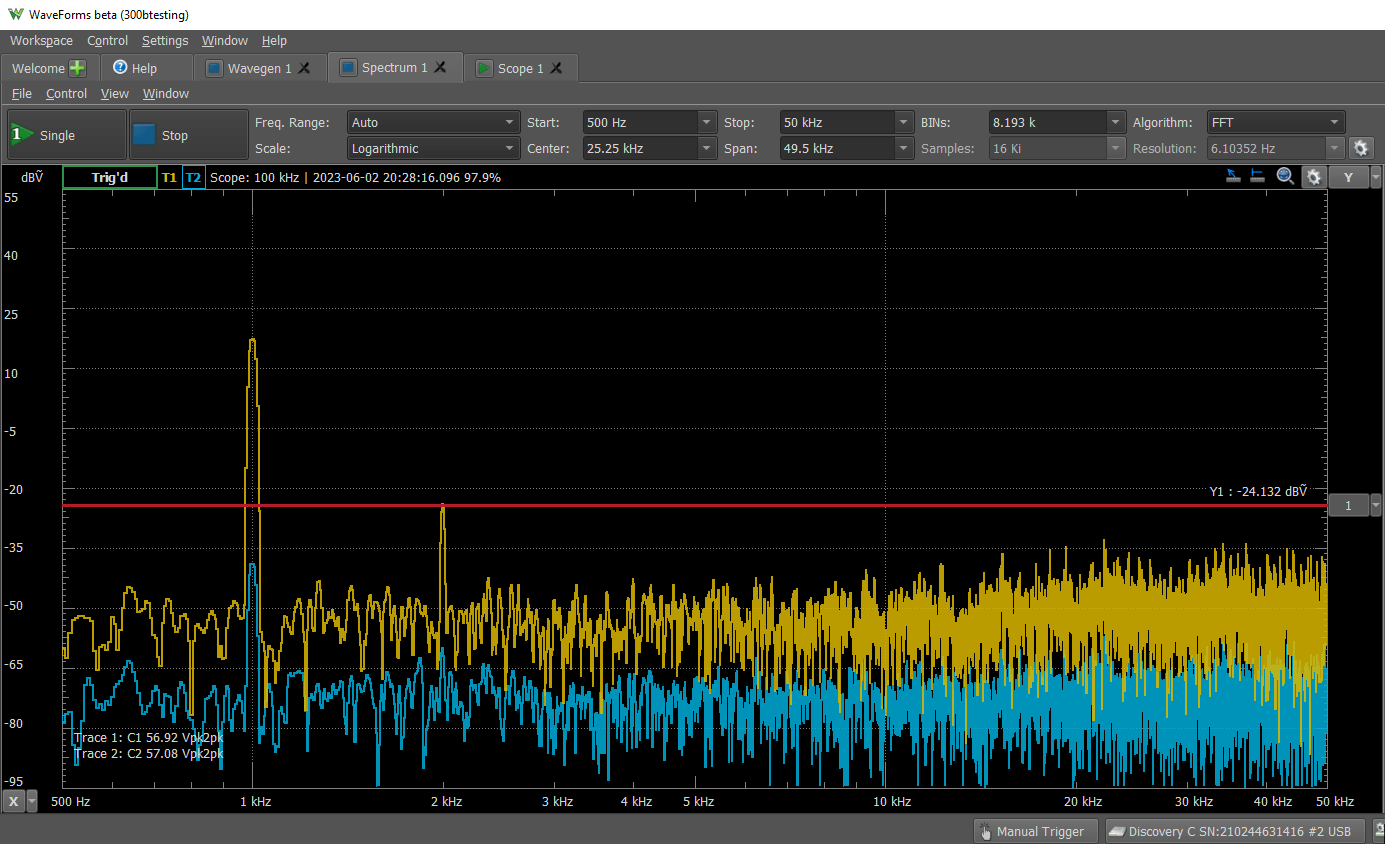

I played a bit with my setup of that hybrid mu follower, specifically Rmu and I got some interesting results, which are bit unexpected. Probably it will be useful to put them here for the future. I use the mentioned schematics, with B+ of 400V, 6N7 tube, Vref set to 275V and current of 9ma. The transistors are DN2540 and 2N7000. The Gfs of 2N700 is 360 which translated to Rmu of 270 Ohm. The designer of that circuit suggested 330-470 Ohm, because the stated in the specs Gfs is for Vds= 10V, but in the described circuit Vds is smaller so the transconductance should be adjusted. In any case, I get nice amplification of 35 times in all cases, which perfectly matched the stated tube's mu of 35,, but the spectral characteristics are totally different. Only for Rmu of 270 ohm I get very low background of about -70, -75dB but as can be seen in the plots also the third harmonic. For Rmu or suggested 370 or 470ohm, I get very similar results for the fundamental and 2nd, but the noise/background level increases a lot and the 3rd harmonics is not visible (but most likely it is just masked by the increased level). The harmonics are actually there because I am pushing that tube quite far, to have clean 210Vpp output with 6Vpp input, even though for my 300B stage I only need 150Vpp.

OK, probably one possible explanation is that different brands of 2N7000 apparently have quite different values for Gfs, for example here it is 320mS https://cdn-reichelt.de/documents/datenblatt/A100/NDS7002A-D.pdf and here is it 600mS https://www.st.com/resource/en/datasheet/cd00005134.pdf and here it just says minimum 100mS https://cdn-reichelt.de/documents/datenblatt/A100/2N7000_ENG_GER_DS.pdf and some do not even mention it https://cdn-reichelt.de/documents/datenblatt/A100/2N7000-UTC.PDF which should effect Rmu, so be aware while following the manual.
