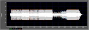

On the topic of declipping... I looked at the cutestudio site and this image...
...reminded me of how surprised I was when I examined in detail a similar-looking waveform that I assumed was clipped to blazes. The more I spread out the timeline the less and less clipping (consecutive samples at max digital value) I saw, until looking at individual sample values there was almost none for the whole song. I think I found one occurence of four consecutive samples at max value.
I learned to look at a waveform in detail before assuming it is clipped.
I think a waveform such as this one, even if it turns out not to be clipped, is probably exhibiting low dynamic range and/or compression.

I've looked at many CD's and there are many that are compressed and limited as you describe, but there ARE quite a few that DO show clipping, at least four and maybe as many as 20 sample points sitting on a rail (or maybe 25 out of 35 consecutive samples are at a rail), and this happens every beat, or at least every kick drum or snare drum. Yes, it's done intentionally, it adds distortion and "excitement" to the sound, but of course after a while it adds ear fatigue as well.On the topic of declipping... I looked at the cutestudio site and this image...
But compressors and levelers have always been used to some extent or another. (except of course for acoustic recordings and the earliest electric recordings). Record the first couple of Beatles LP's onto your computer and look at it - the overall waveform of each song looks pretty much like a rectangular blob of constant-volume sound. This DID make it so everything could be heard on a cheap record player.
I think by the mid '60's sound engineers started letting more dynamics come through on pop records. Perhaps the availability and increasing popularity of better "hi-fi" home stereos helped. I notice Cat Stevens LP's from the first half of the '70's have really good dynamics and the music feels as "real" as any pop CD I've heard.
Indeed. A totally squashed recording need not be clipped.
In the initial years of the digital audio workstation-driven part of the loudness race so-called shredding was used, the deliberate clipping or hard-limiting of the signal. No need to tell you what the result was.
But shredding requires no tools, so the plug-in makers quickly started to develop and sell a new breed of very aggressive compressors and limiters that have a similar effect on loudness as shredding, but without actually slicing off the wave's tops. I presume their underlying mechanism is compression with its parameters auto-adapted on a cycle-by-cycle base.
