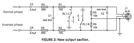

No, I think I get the point. With a passive RC output, the DC on both legs is the same, i.e., there's no differential mode DC and the output is balanced. Now, we put an input transformer on the far end, which we can do because there's no differential DC. So we have the same galvanic isolation, the same removal of the common mode DC, but we now have 40-60dB better CMR than with an output transformer on the sending end.
There's still a transformer, but we've gotten better performance. What am I missing?

The caps are not needed because the transfo blocks the DC. The LP filter shouldn't hurt and may be good engineering practice, but I've not found it necessary. See the post by JCX above.
And yes, you could put the transformer at the receiving end, if you want - I've done it. That gives you rejection of cable borne noise as well. But in a practical sense, I've never found it to be needed. If it were a long run, like 100' or more, a transformer at each end might be merited.
Just to be clear again, the caps aren't blocking DC in Jan's circuit. They're shunted between + and - output legs. I'm even a simpler guy than you. 😀
I assumed you've been discussing Jan's "Greening the DCX" article from aX available on their site. In that there are blocking caps.

OK, we're talking about the same thing really. You just put the transformer near the next stage, that's all. Probably better, but sometimes not practical. With 3 to 6 foot cables, not a big deal. But at least you've got your cables DC polarized!
