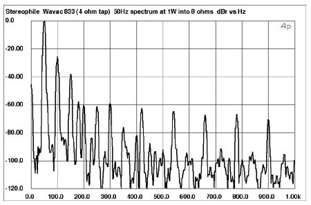

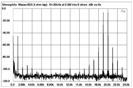

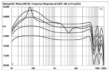

In a properly implemented single-ended system there is little or no color because the distortion will be so low as to be inaudible. That's why I'm not hearing any color.
Here's what $350k will buy you.

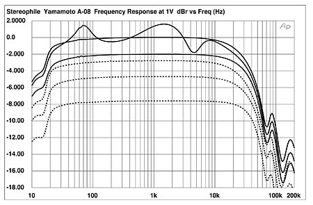

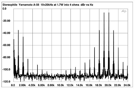

Ignoring the "simulated speaker load"?
OK, those were two amps that got rave reviews. Show me 1W IMD and frequency response into a speaker load for one of those good amps that I apparently ignored.
Not knowing the nature of the "simulated speaker load", I can't comment. I don't see anything on the Yamamoto response curve that would necessarily be audible, given the far more grotesque variations in speaker and room response. As for the Wavac, I don't know if I'd like a class A2 amp with loads of cathode negative feedback. Big and impressive doesn't make a big impression on me. A high powered SET amp is neither necessary nor desirable.

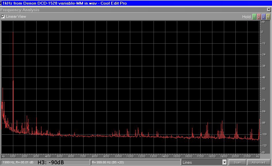

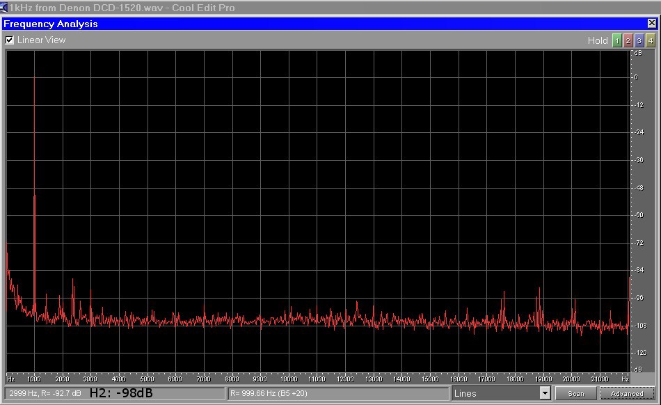

Comparison
I made a 1kHz tone in Cooledit, cut it to a CDR and played it back on my old Denon DCD1520 player, sent the signal through a buffer and transformer coupled to the computers sound card. Made a recording in the computer and analyzed the resulting wave file with Cooledit.

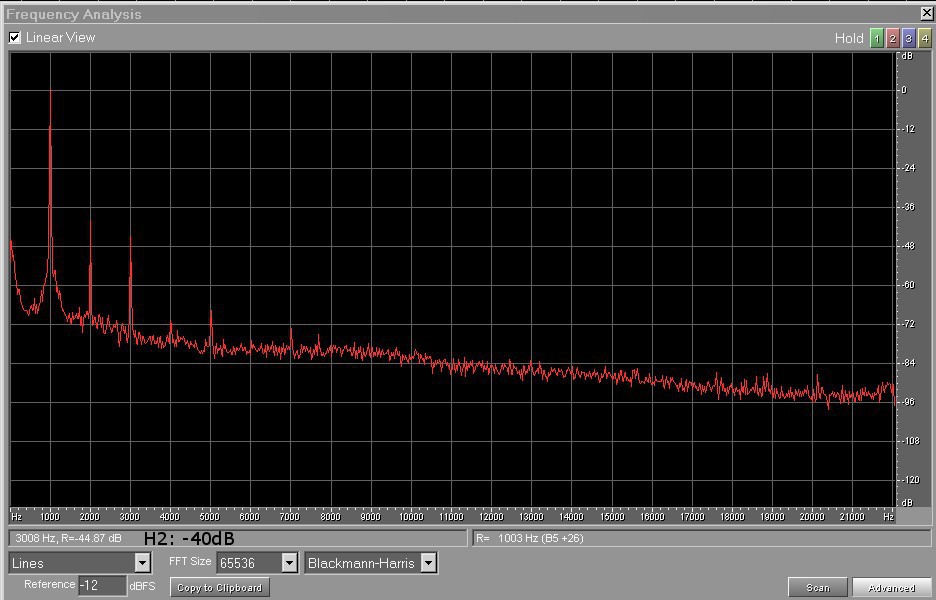

Comparison
I dug out an old Realistic test LP in good shape from the early seventies and played the 1kHz track on my Denon DP2000 record player, with an SME III /Shure V15 type IV combination. Recorded and analyzed in Cooledit.
